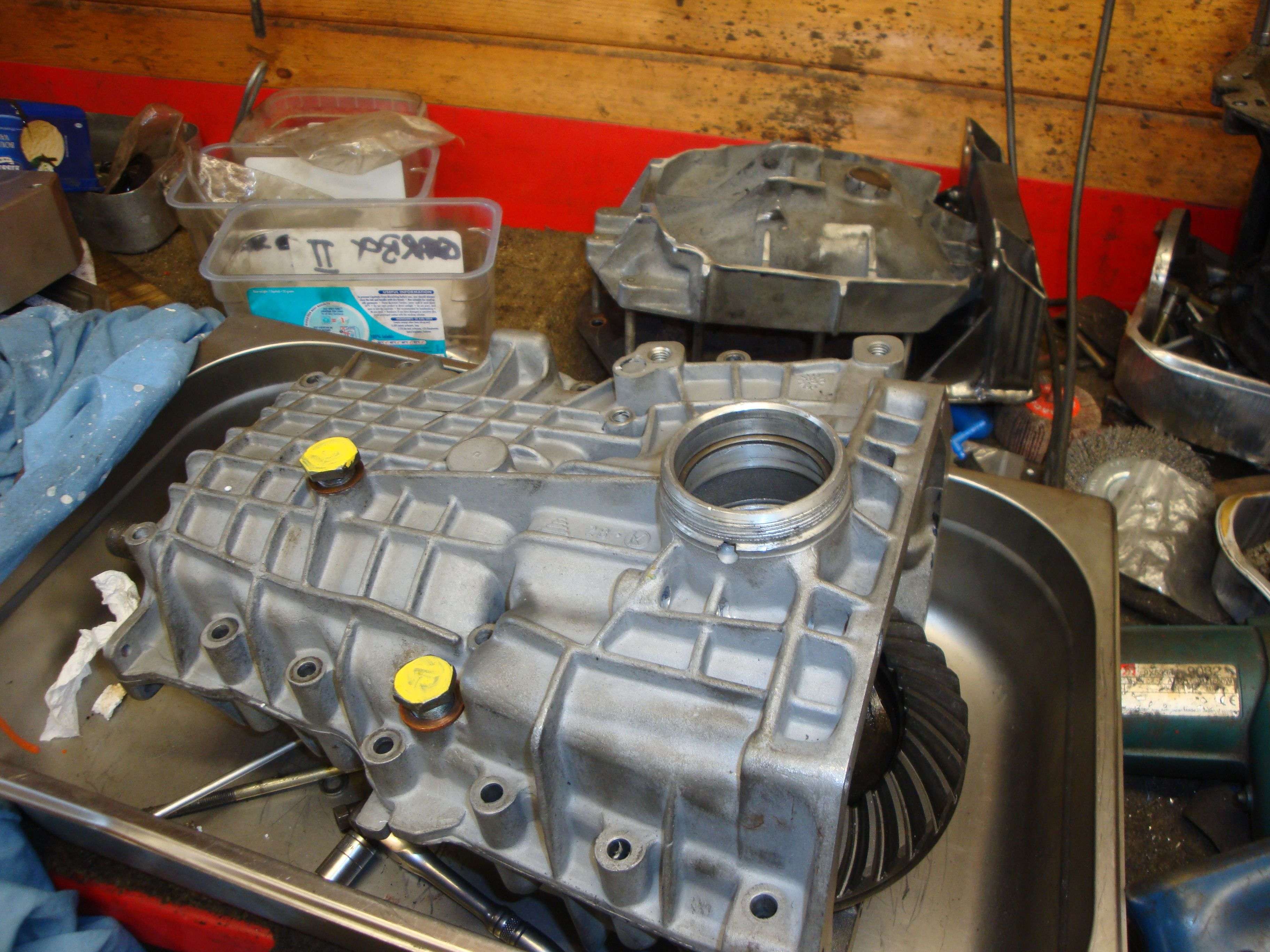

Some pictures of build..
GS 5 speed box being modified.
Rear end so far...
Front end with Transfer box.
