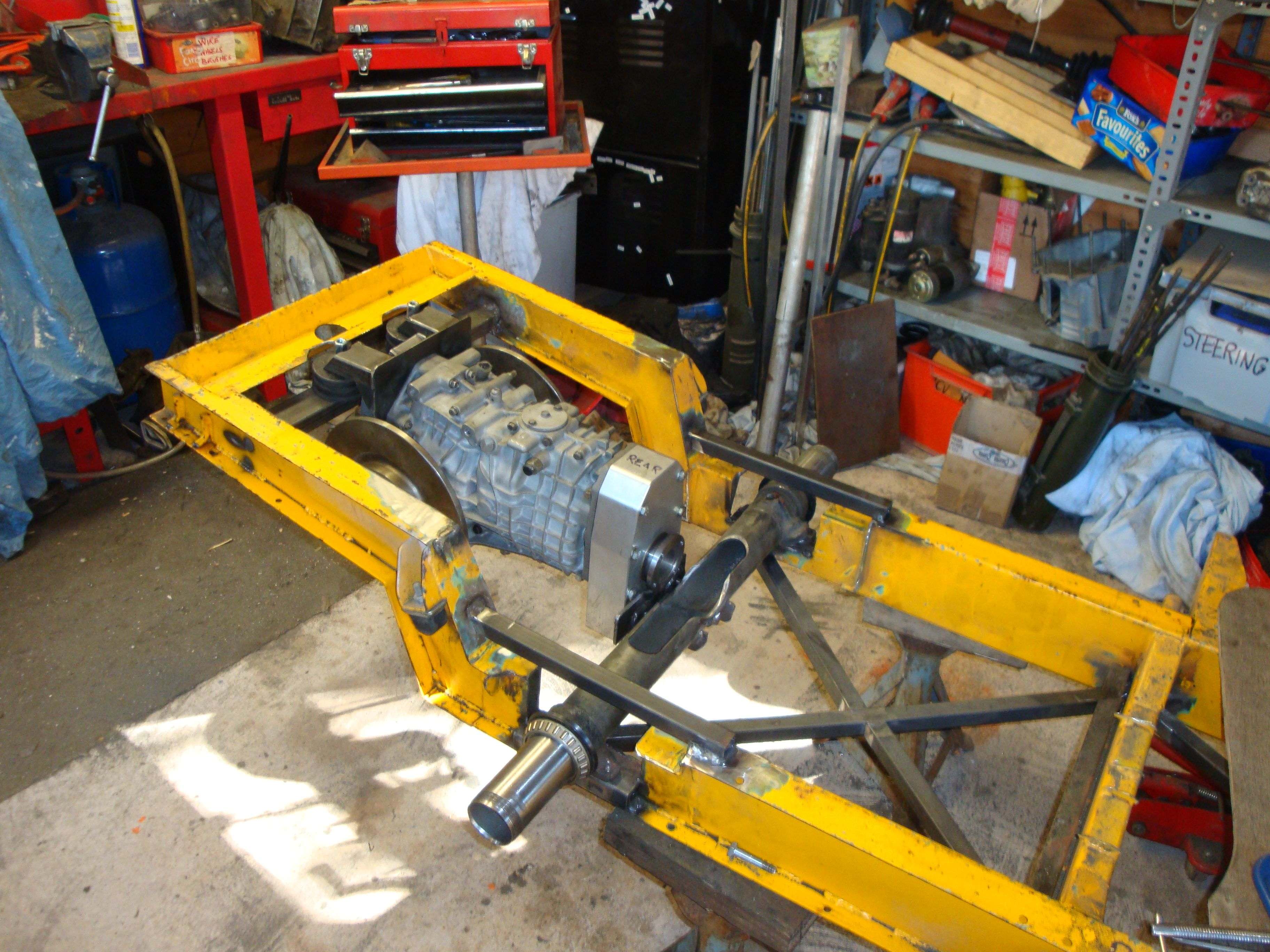

Some pictures of build..
GS 5 speed box being modified.
Rear end so far...
Front end with Transfer box.

Chassis 90% complete and painted.
Heavy at 80Kg but strong(I think?)
