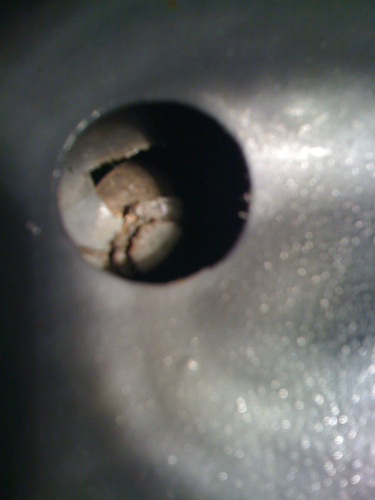

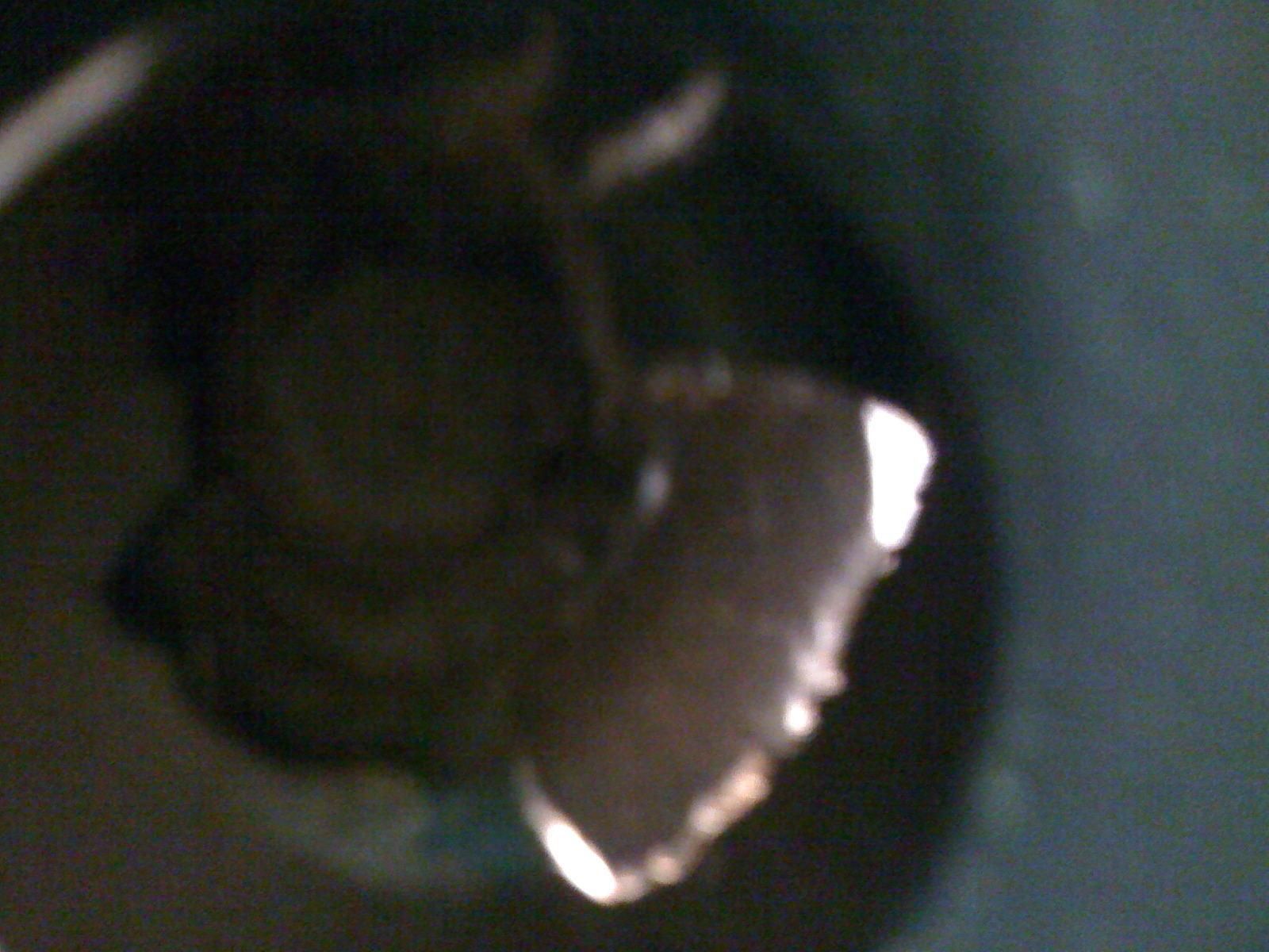

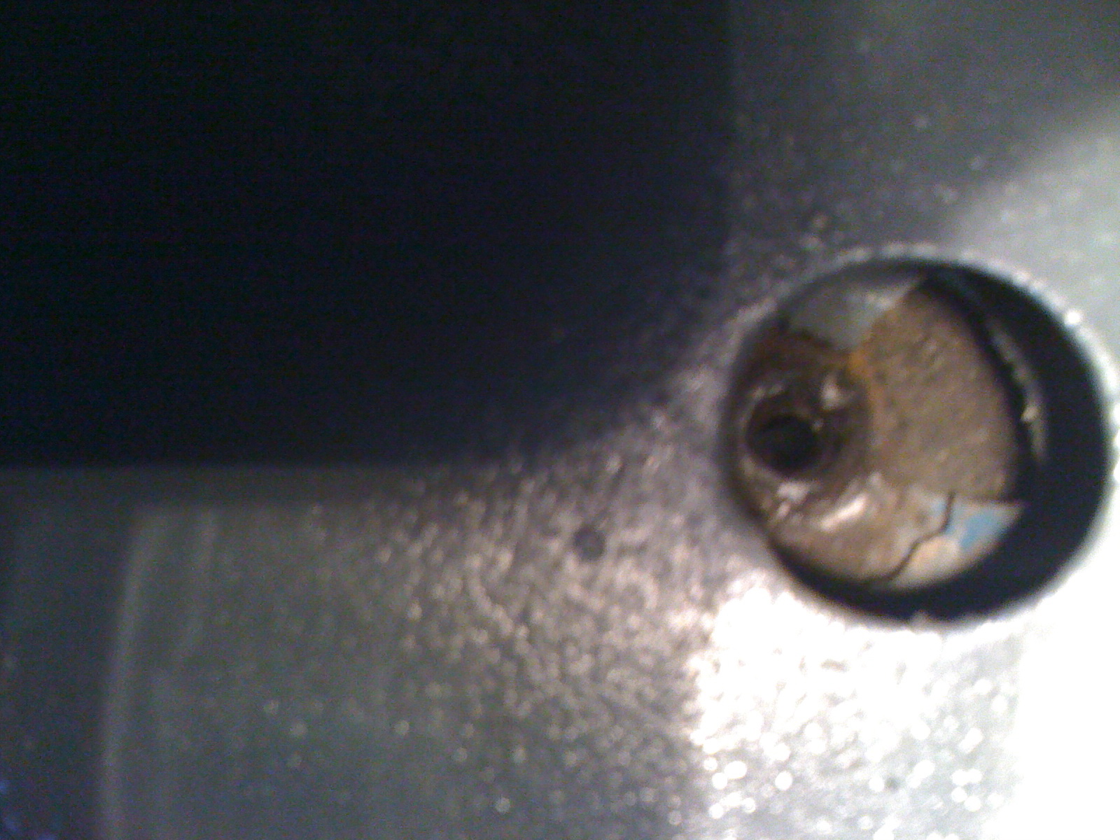

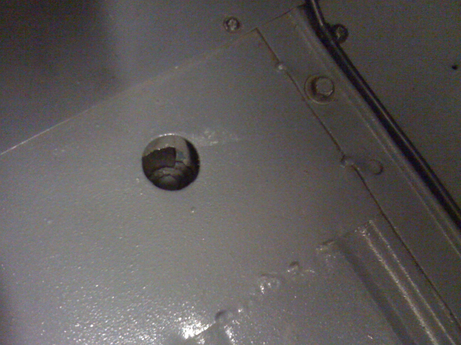

The race car shell where it bolts through the floor (see picture) its not doing anything!

Can you get some better photo's Simon? I reckon we could do that in situ. Are you about saturday afternoon?

Yep here all day Saturday - I will see what I can do with some pictures in a bit

Not sure if they are better pictures! took the bolt out and yes you have guessed it - it rolled along the floor, straight into one of the floor holes BUGGER :x
The bits would be great thanks
