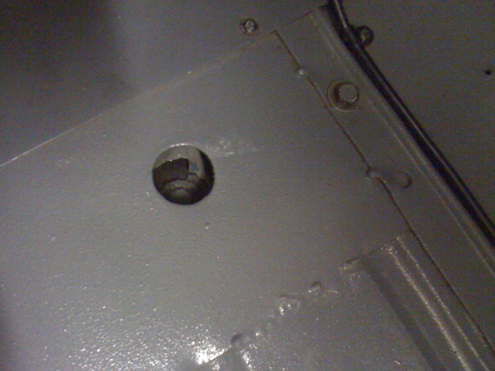

Russ the rear arms are easy, wheel with an axle stand welded to it, bit of scaffold bar, I have one here, we need to do a couple of arms for the race car in case!
The race car shell where it bolts through the floor (see picture) its not doing anything!

Can you get some better photo's Simon? I reckon we could do that in situ. Are you about saturday afternoon?

Yep here all day Saturday - I will see what I can do with some pictures in a bit

Not sure if they are better pictures! took the bolt out and yes you have guessed it - it rolled along the floor, straight into one of the floor holes BUGGER The bits would be great thanks
