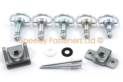

However, I would still like to find a mechanism to operate from inside the car.
I'm considering dzus 1/4 turn, but am not sure they are strong enough. I have a pair and will see if they may fit. I need to buy the correct rear spring bits first.
These aren't the ones I have, but I do have ring ones.

I didn't mean you should use the ones I liked to, I just was curious how they work, as it's not mentioned in any of the ads. And if they are spring loaded, I might have use for them.
The ones you linked to are common on motorcycles. Fairings and stuff like that. They are great for that use, but to secure a fender, or a whole front end... No. Too weak.

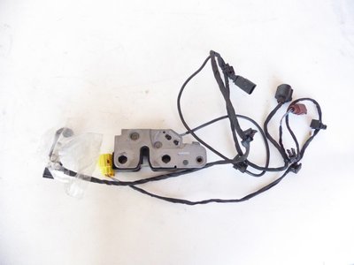

As the bulkhead is flat and vertical ??,
How about a boot/bonnet catch
(without wires)
eng_pm_BONNET-LATCH-LOCKHOOK-CATCH-VW-SHARAN-ALHAMBRA-7N1823509A-26468_1.jpg [ 83.98 KiB | Viewed 10500 times ]
September 23rd, 2018, 9:30 am
Online
Post Re: My Beduino
Hi Pete
Its not vertical. So there is a shearing action as the bonnet (wing) closes.
Talking with you guys has made me realise that I will have to close it and then insert the fastener in. That, or enlongate the holes, but that adds the issue of water getting in. Though a closed cell sponge pad may sort that!
Its good to talk. :D

Post Re: My Beduino
Maybe a boot/bonnet catch is a good idea. You can just mount the lock in an angle so there is no shearing action, yes? And a release handle inside the car, connected with a wire. And some sort of back up solution would probably be smart ;)

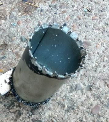

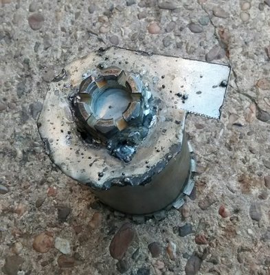

I made the castle nut tool for suspension arm's. :)
Not very durable, but got them on.

Post Re: My Beduino
Epic 8-) .
September 28th, 2018, 9:15 am
Post Re: My Beduino
Crackin'! 8-)
