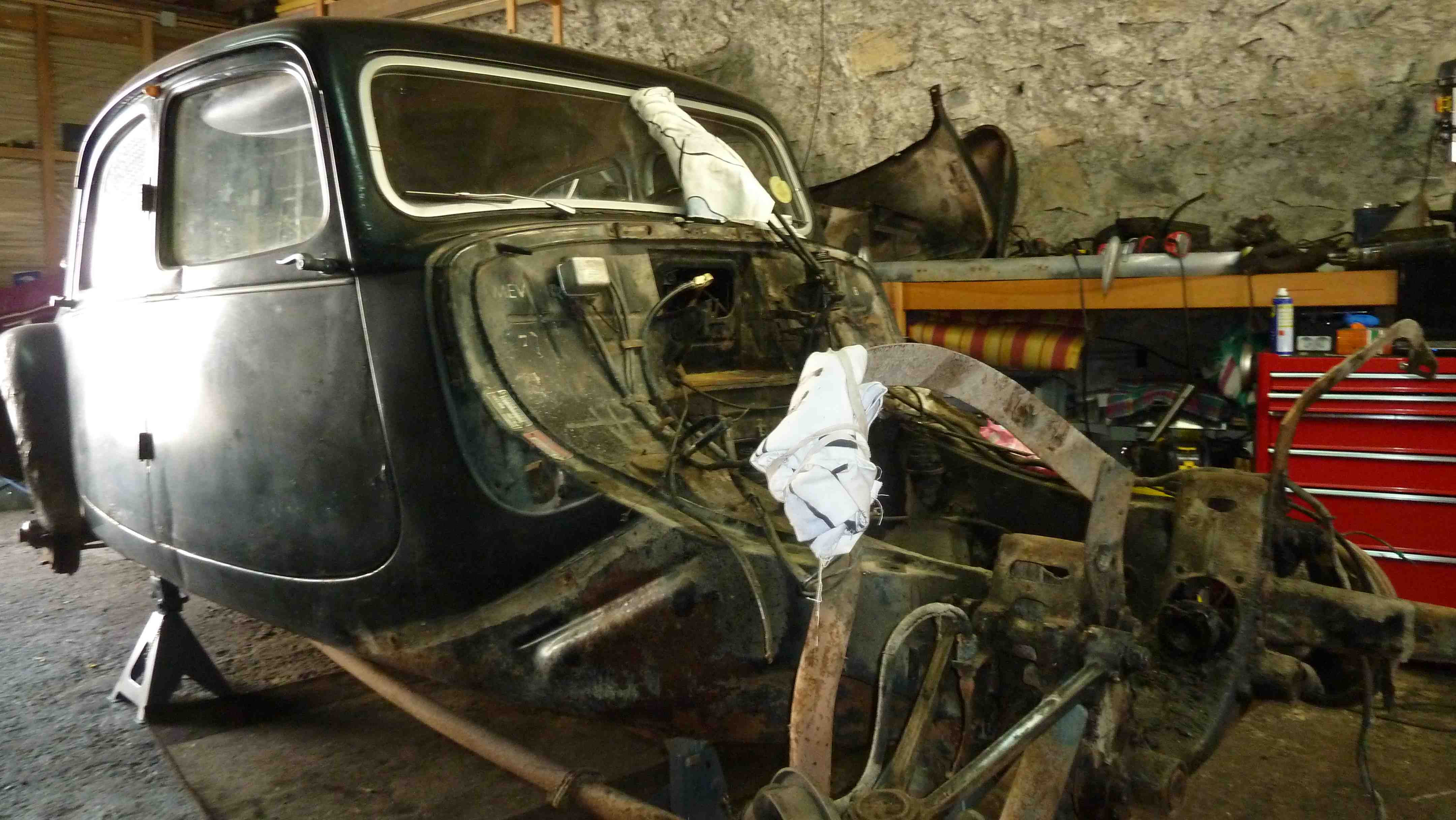

Vinnie (I know, but the wife thinks it is a gangster car) is now looking a little naked.

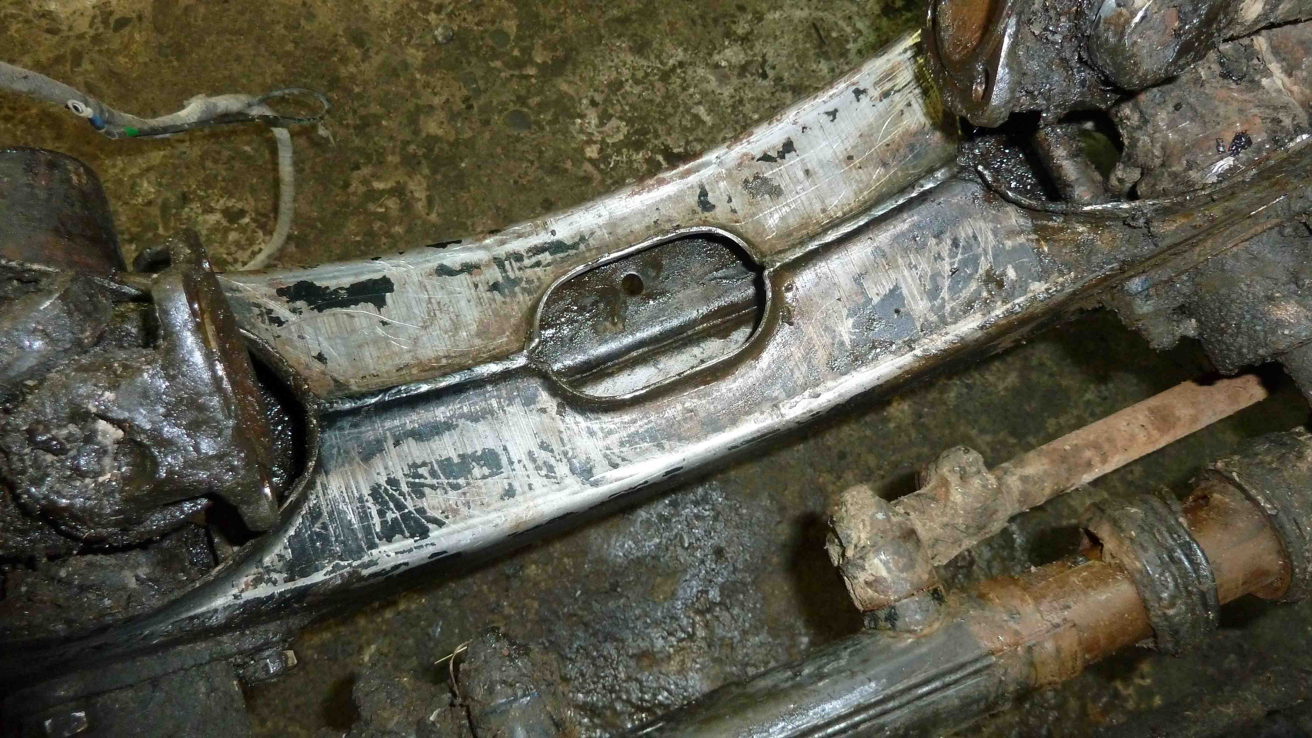

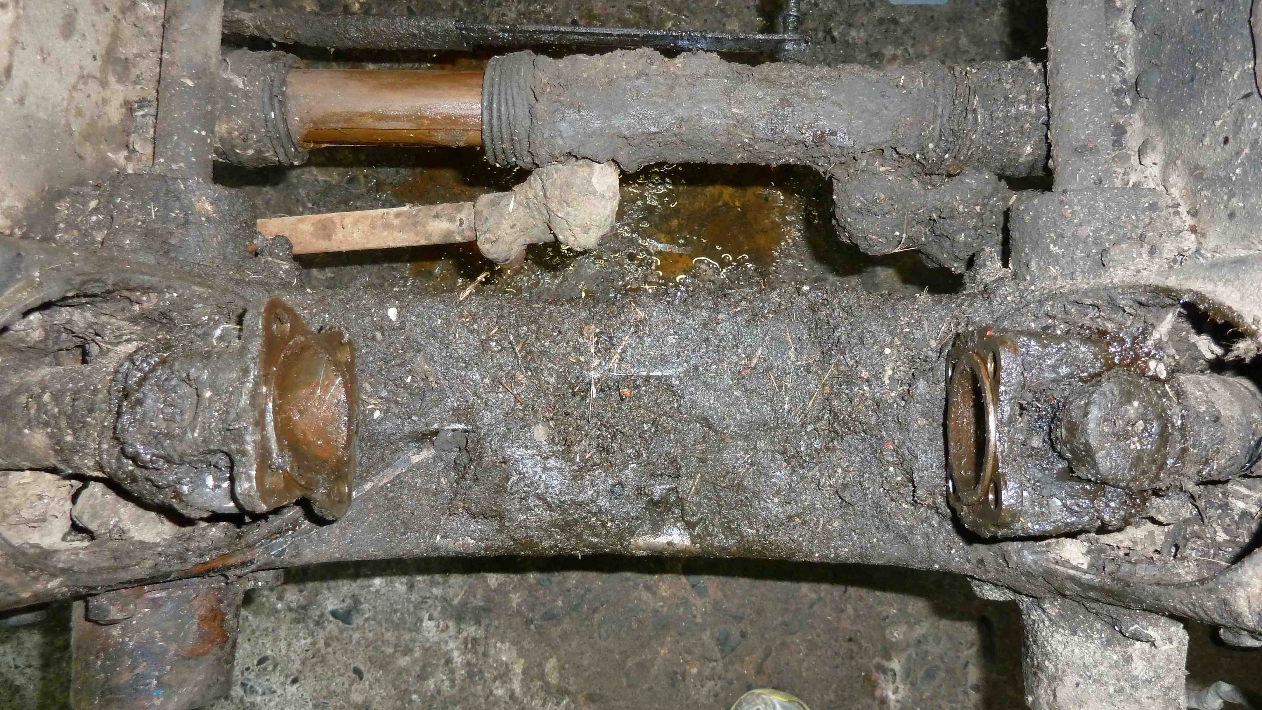

BUT bloody filthy. So far under this crust of grease and mud the structure has been well preserved. It is like digging a body out of a peat bog - I have even seen patches of original green on the engine. No joke there is at least a 1cm thick coating of grease and mud on everything.

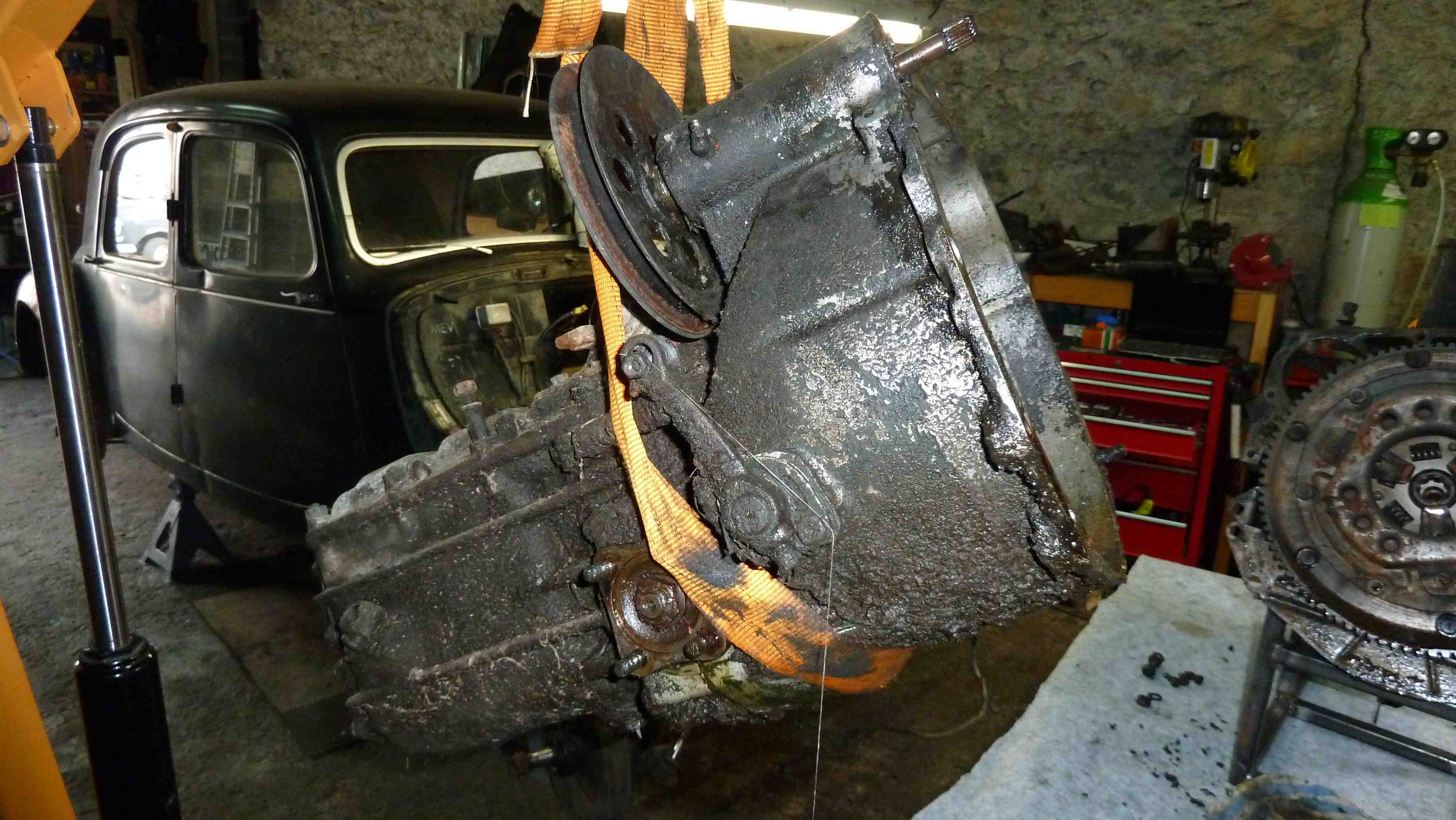

Right - got the gearbox off.
I love the Citroen instructions on how to do this.
1. Remove gearbox
Was on my own so had to use the engine hoist again but not so heavy this time.
Cleaned out some of the gunk - looks like a mixture of oil, grease and straw.
But it looks like it has done a good job of protecting it for the past 60 years.
