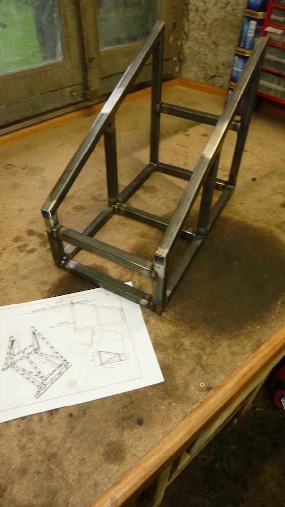

I had a go at welding yesterday. I need to make an engine stand before I took it out.
In hindsight , the rear bar needed to be lower :( But not to worry. :lol:

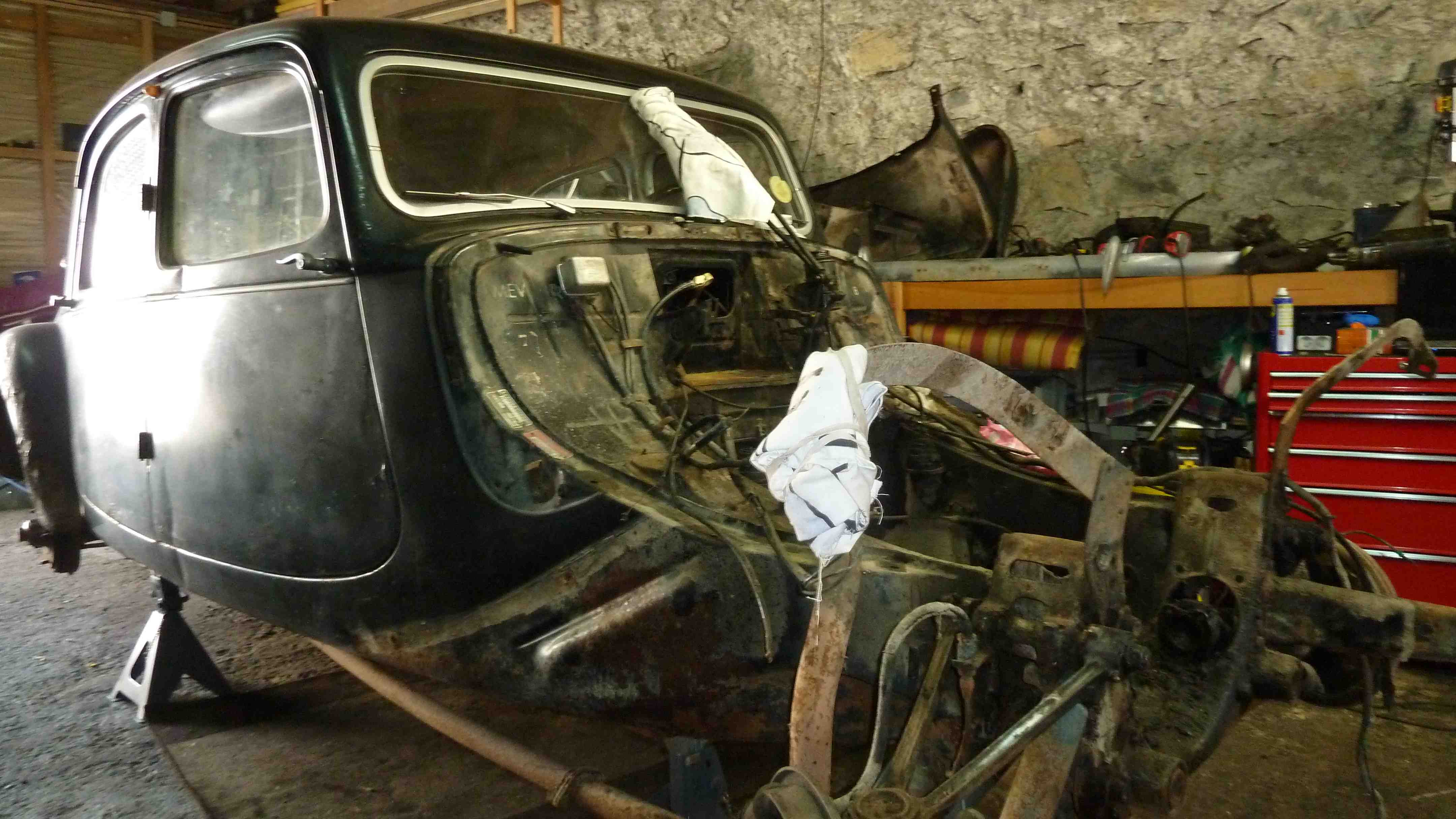

So I got a little carried away last night (we have clients now so I have to do the car in the evenings.... darn this having to work lark :lol: :lol: )
I took off the other wing and light assembly and stripped off the cables and tubes connecting the engine to the car.
This car is just a big 2CV and the body parts are stacking up just the same.

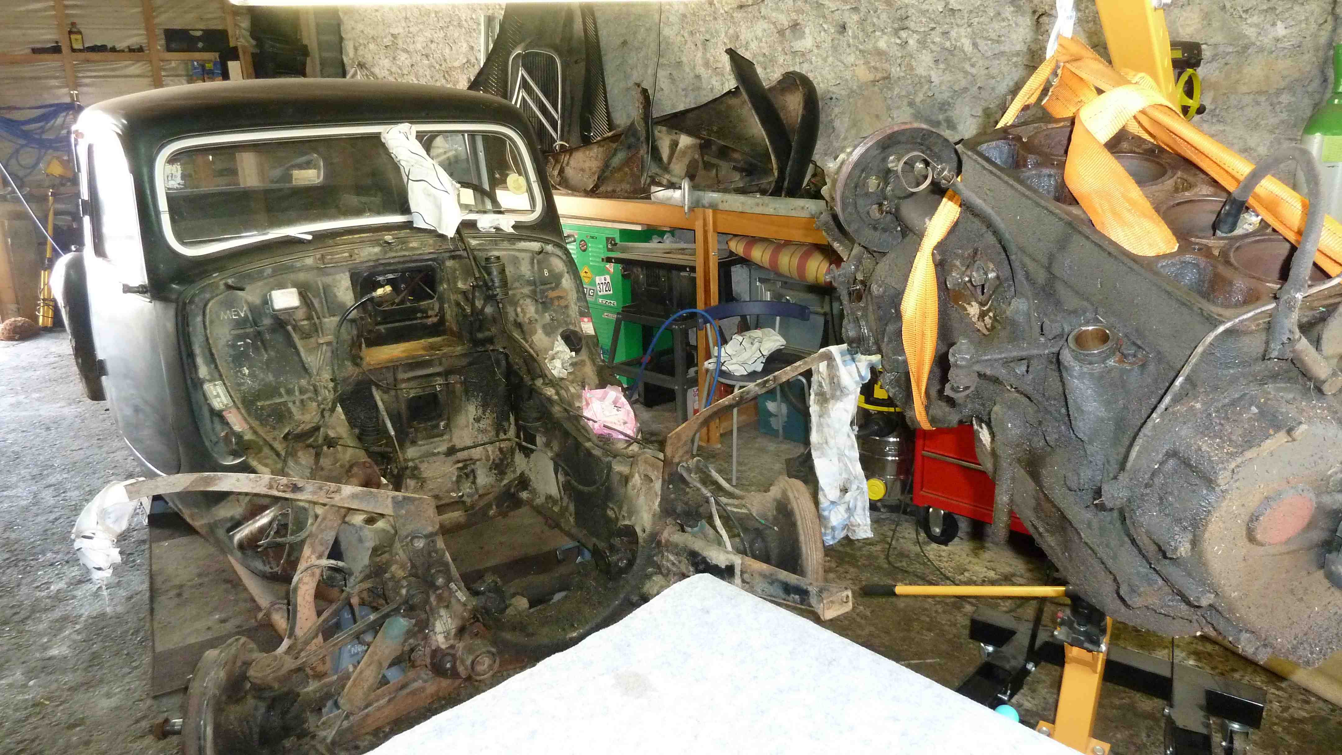

Then out it popped - the engine hoist is bloody heavy on your own with this one. For the AZU I don't bother with the hoist and just lift it out. No way this was happening here.
Engine stand works a treat - not so sure of the table beneath so will take the gear box off toute suite. :shock:

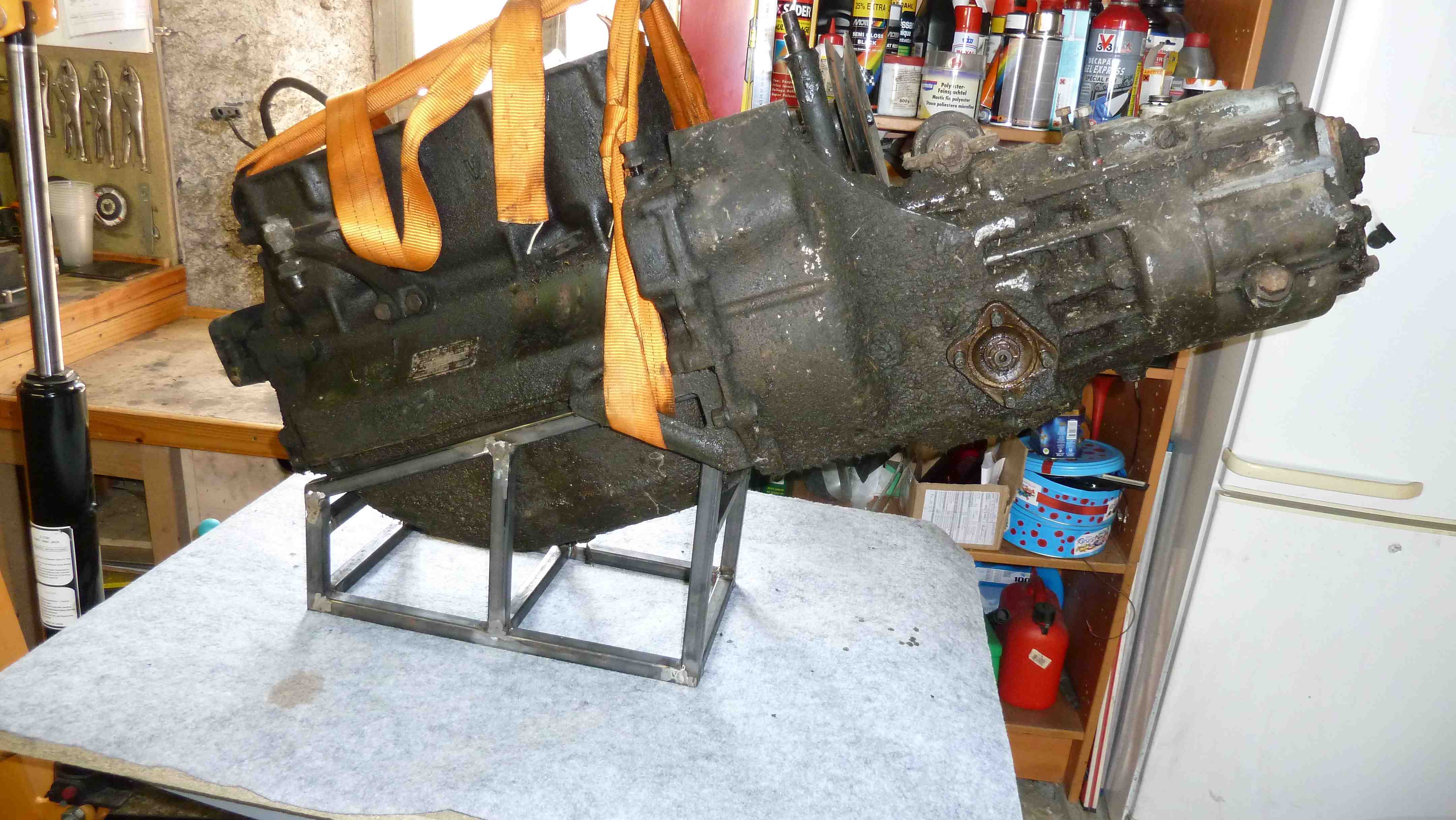

On y va - gearbox is next.
April 21st, 2014, 3:10 pm
Right - got the gearbox off.
I love the Citroen instructions on how to do this.
1. Remove gearbox
Was on my own so had to use the engine hoist again but not so heavy this time.
Cleaned out some of the gunk - looks like a mixture of oil, grease and straw.
But it looks like it has done a good job of protecting it for the past 60 years.
