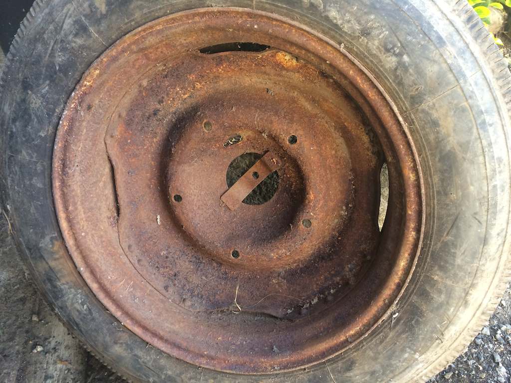

Had the wheels sandblasted yesterday. They are quite pitted so will need a lot of paint.
I left them with the paint shop to be sprayed, a bit more expensive than I wanted but they are in a worse state than I thought too.
Before
After

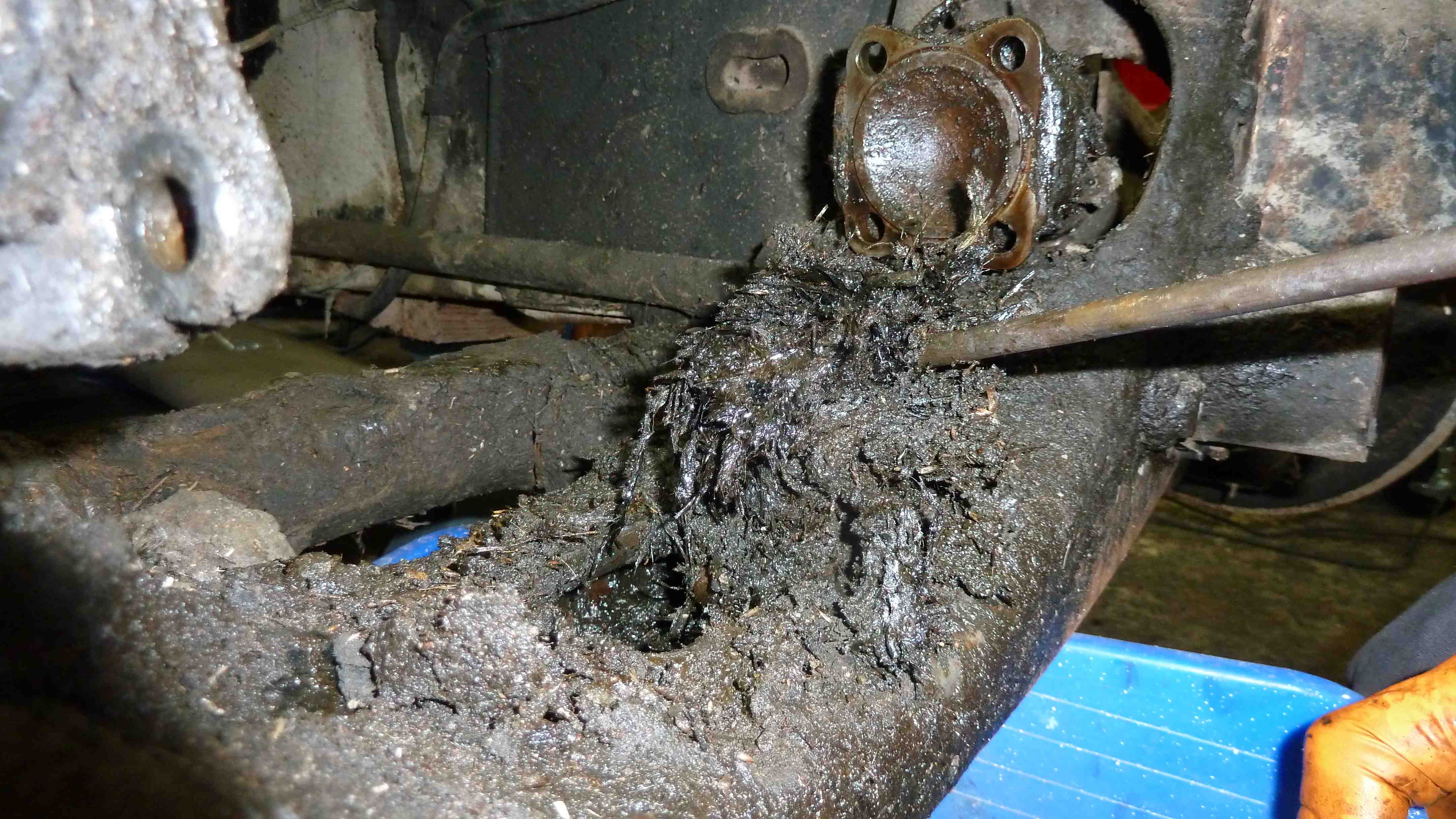

BUT bloody filthy. So far under this crust of grease and mud the structure has been well preserved. It is like digging a body out of a peat bog - I have even seen patches of original green on the engine. No joke there is at least a 1cm thick coating of grease and mud on everything.
