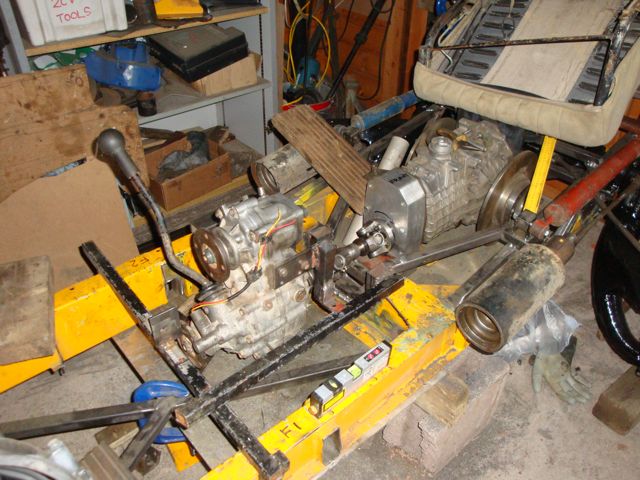

Some pictures of build..

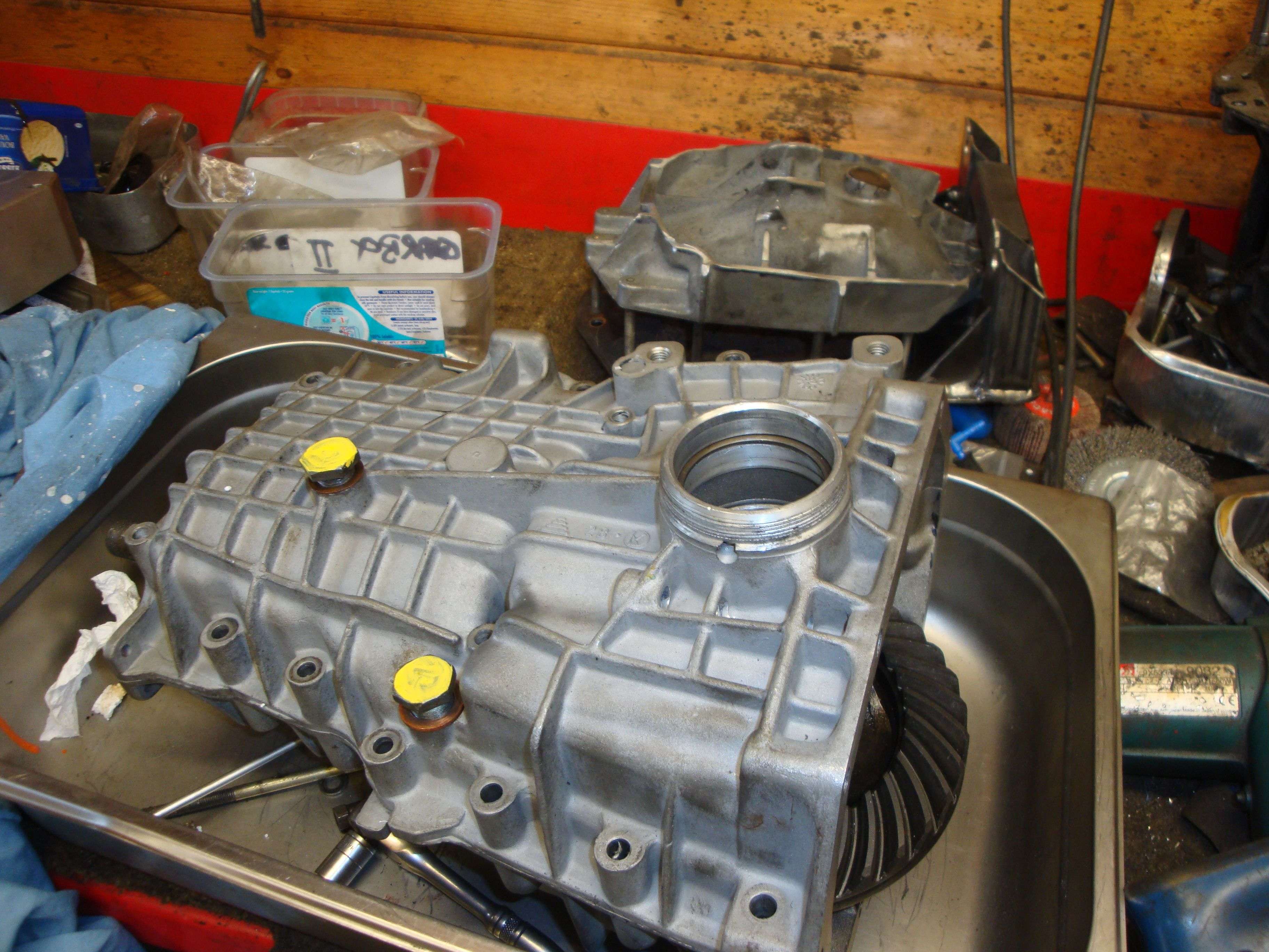

GS 5 speed box being modified.

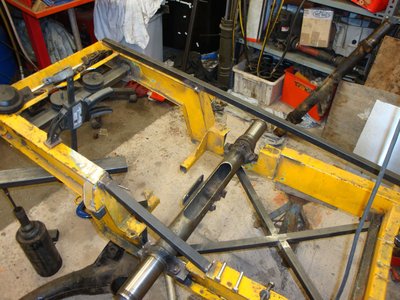

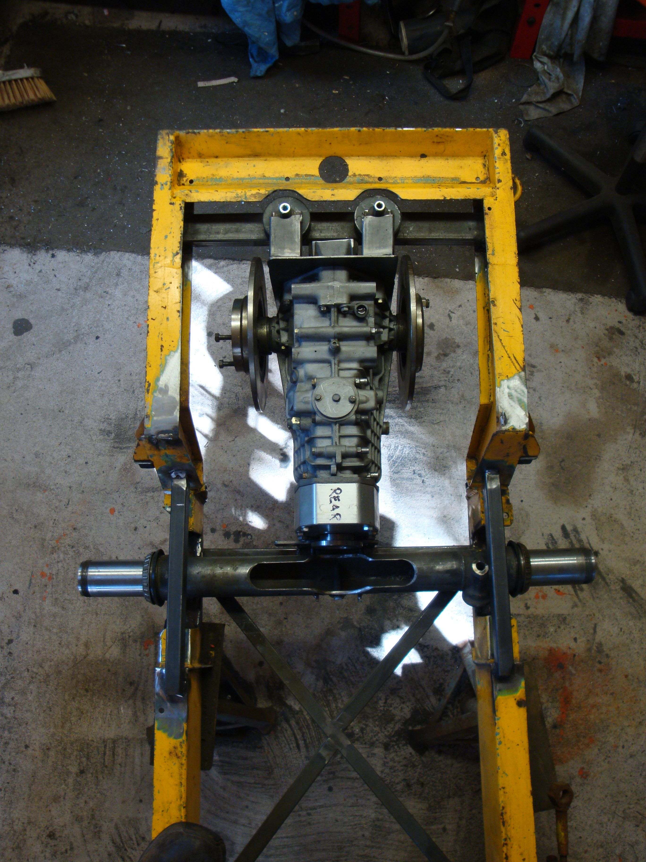

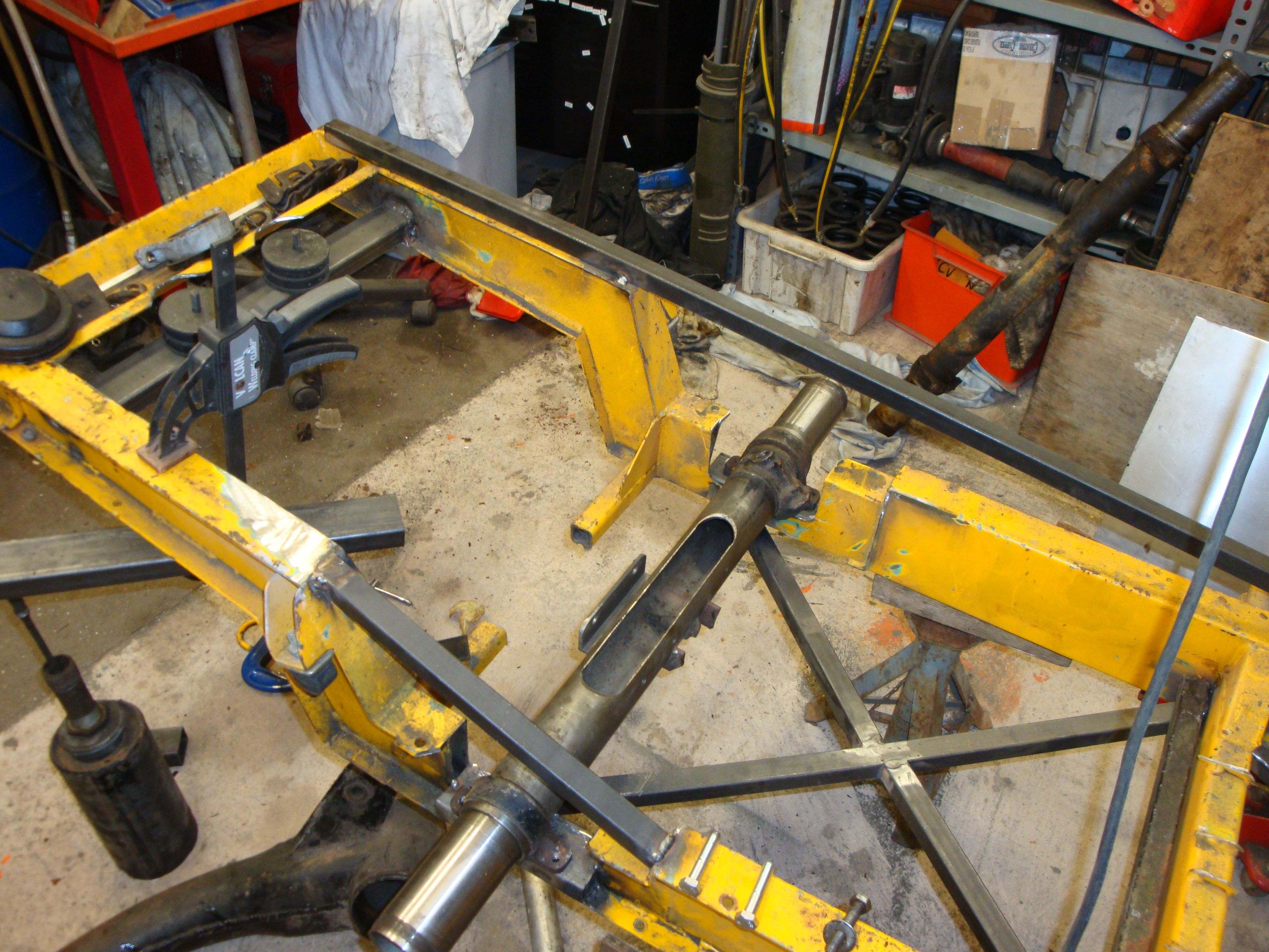

Rear end so far...

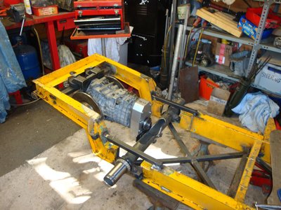

Front end with Transfer box.

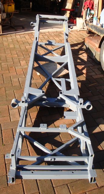

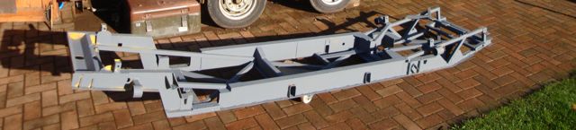

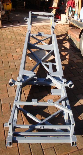

Chassis 90% complete and painted.
Heavy at 80Kg but strong(I think?)
