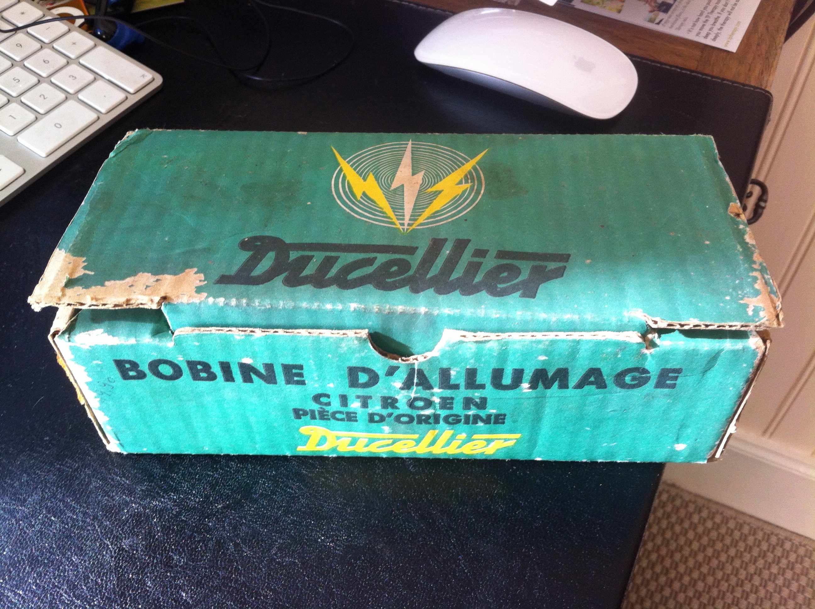

Love getting "NEW" parts. The posty just dropped this off for me. Brand new in the box. shame to have to use it.
File comment: Brand new in the box 6 Volt Bobine.

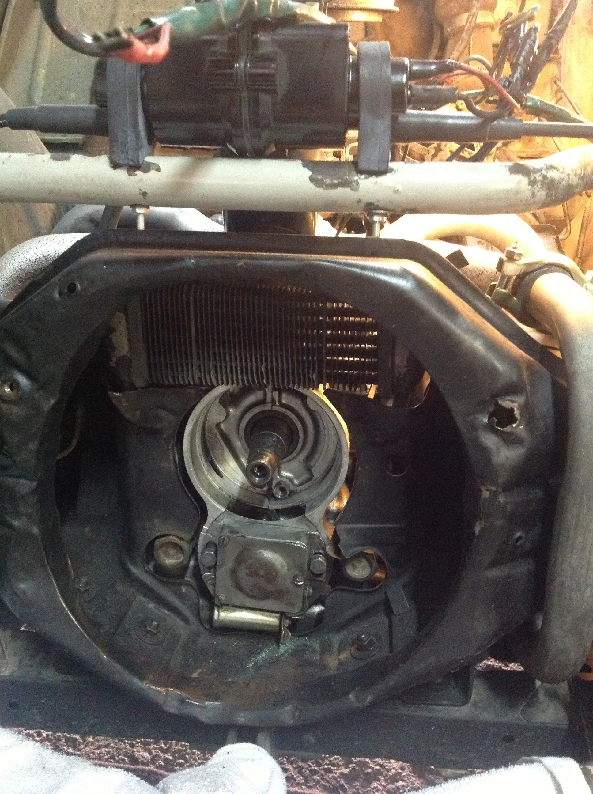

Traced all wires leading from dynamo, coil and lights and removed some of the connectors and soldered them directly to lessen as much loss in current as possible. Looks a lot tidier now - not sure why so many connectors are required along one single wire?
Here is my old dynamo - I will check it against the new one when it arrives to see if there are any startling differences or damage, but at the moment I can't see any.

Hi Ian
Looking at your new pictures (and looking back at your other ones) the end of the armature looks damaged like it was rubbing on the brush holder.
January 11th, 2013, 8:08 pm
Post Re: Rene - The 1970 AZU AK250
Yep, that was my fault, when I put the brush holders back on, one was catching. I didn't notice until I saw the damage. I then adjusted it back but a little too late.
January 11th, 2013, 8:10 pm
You need to have a gap between each copper piece. You can use a small very thin blade to re cut the grooves.
January 11th, 2013, 8:14 pm
Page 6 onwards may help
http://archives.jampot.dk/Technical/Ele ... ynamos.pdf
January 11th, 2013, 8:20 pm
