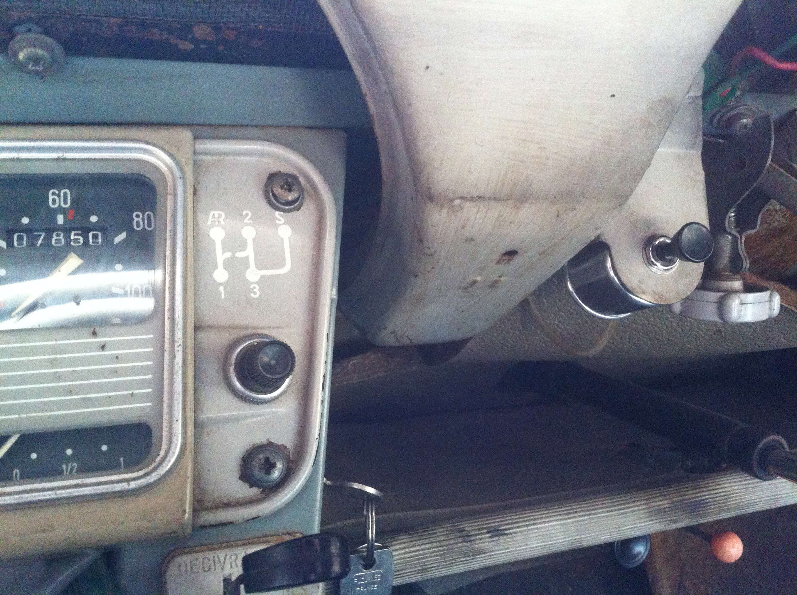

The 1st replacement part on my new Fourgonnette.
The windscreen washer pump (Pompe Lave Glace). The nipple was broken and no way of glueing it securely so Le Bon Coin came to the rescue with a nice new shiny one.
I hope the rest of the restoration will be so easy ;)
