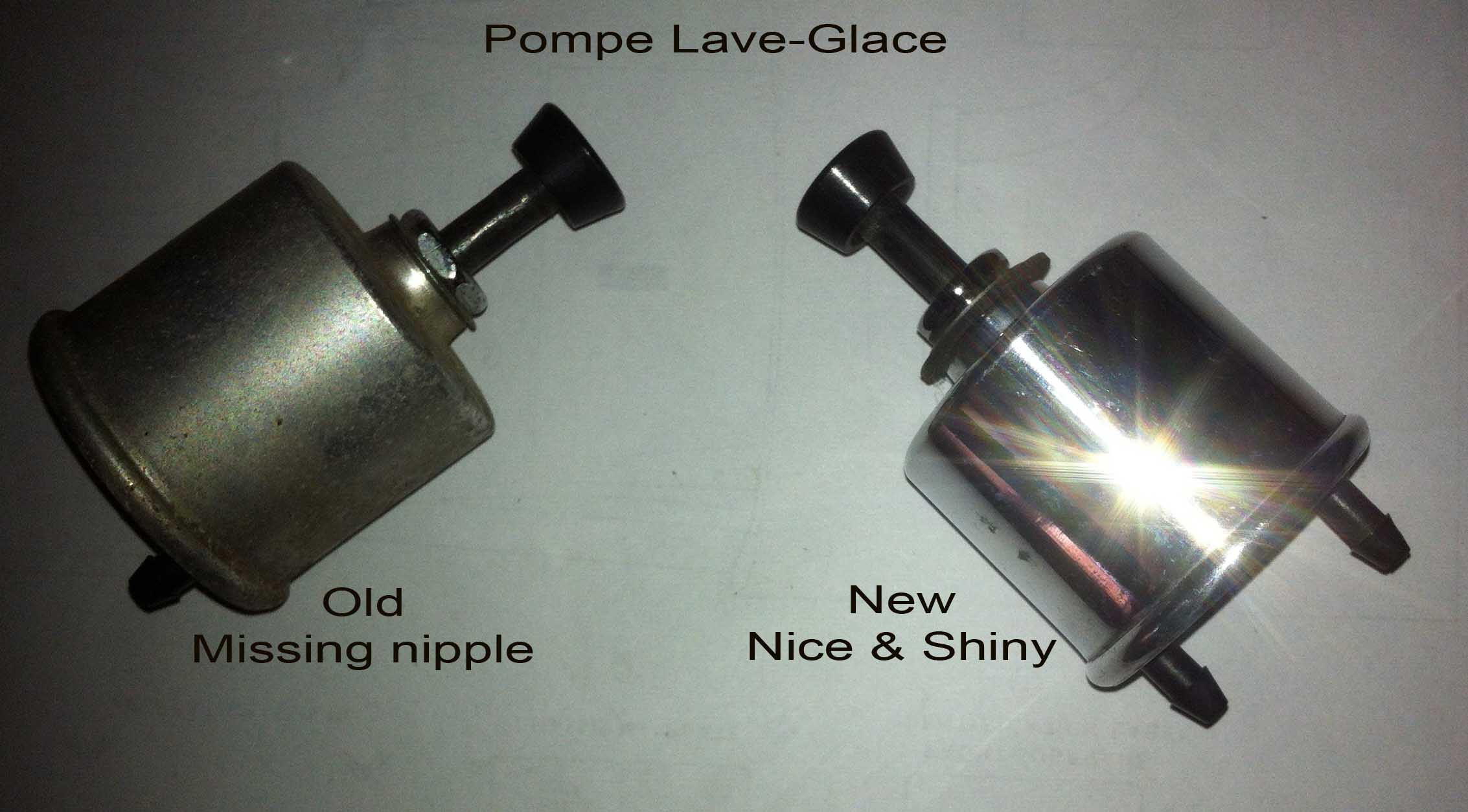

The 1st replacement part on my new Fourgonnette.
The windscreen washer pump (Pompe Lave Glace). The nipple was broken and no way of glueing it securely so Le Bon Coin came to the rescue with a nice new shiny one.
I hope the rest of the restoration will be so easy ;)

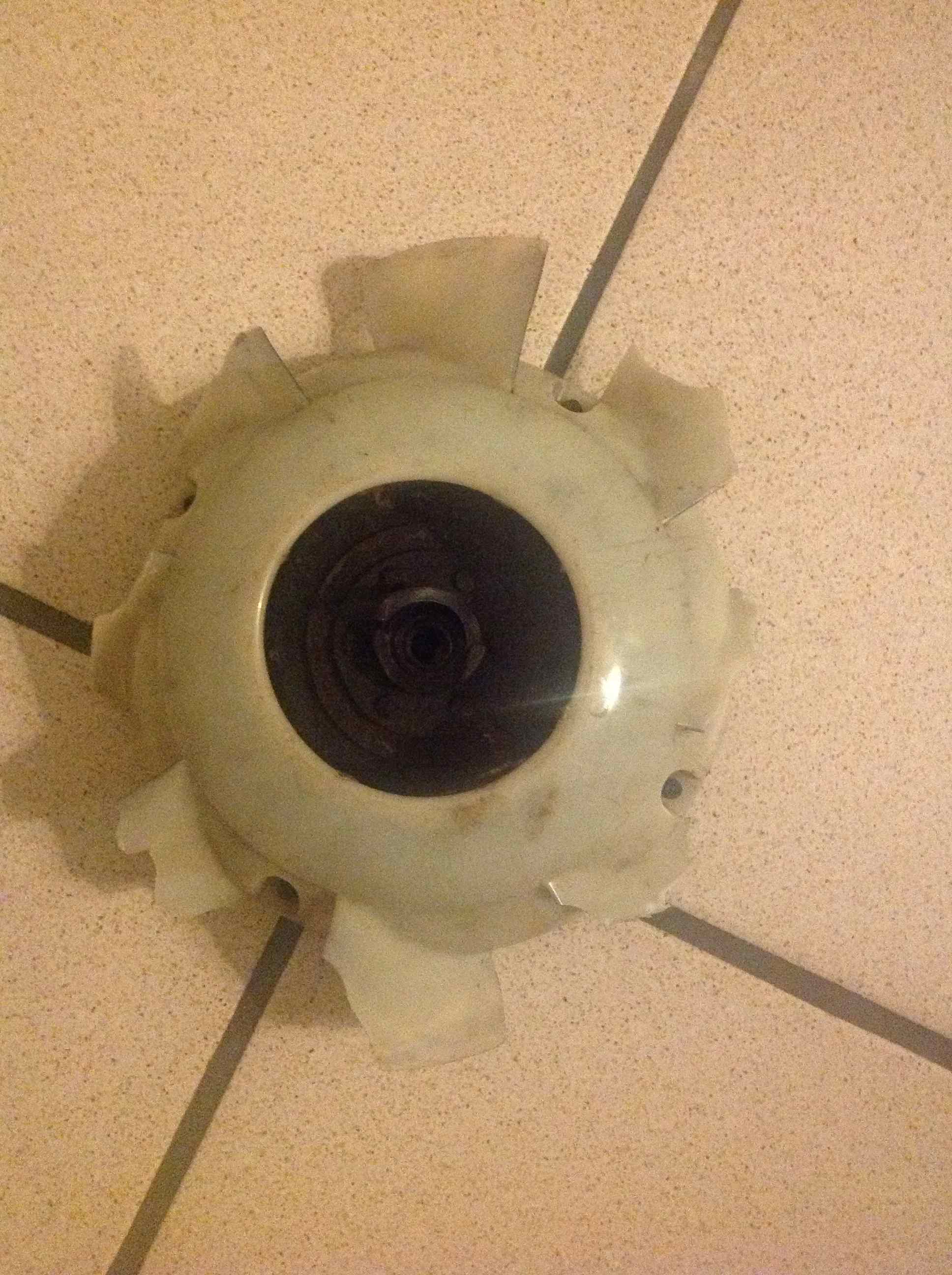

But then when checking the engine and revving it a little from the front, the bloody fan assembly shot off and skimmed my leg. The front grill is not fitted at the moment (fitting lugs broken) and it seems the last owner had not tightened the fan up correctly. It was a bit of a shock and luckily my leg was not too much in the way of it's trajectory.
New fan required :(
File comment: Not many of the blades left at all.
December 26th, 2012, 12:32 am
Post Re: Rene - The 1970 AZU AK250
Before u buy the hole assembly the plastic bit unbolts from the metal bit. Check the metal bit doesnt have a hairline fracture
