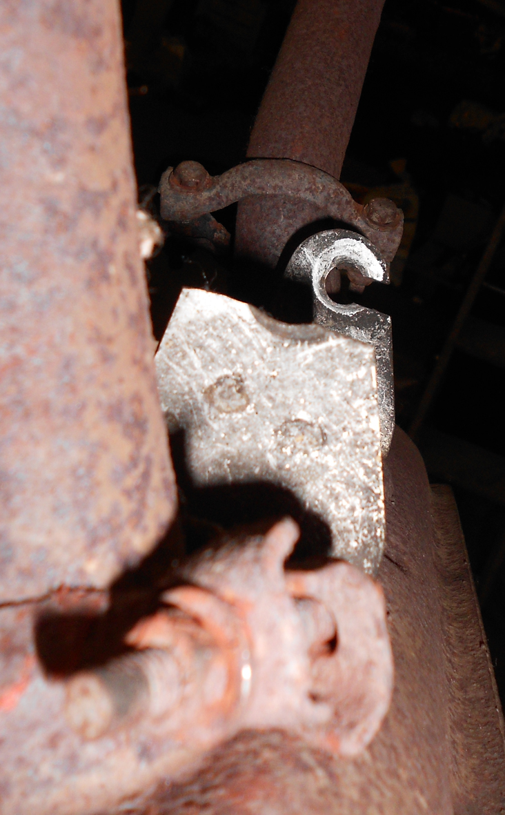

Peeved, I went back to the body-off job. Still couldn't get the body to separate from the chassis. So I had a good look underneath... and discovered a bit of bodging that an old-school French farmer would have been proud of:
Some twunt's welded the body to the chassis! And the space is too tight to get an angle grinder in!
