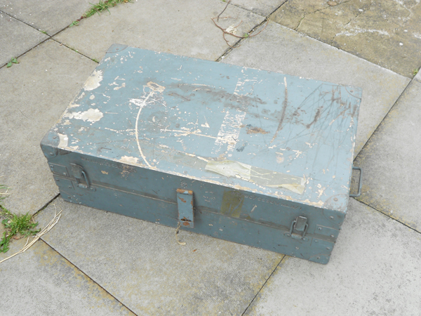

which I reckon is ex-MOD. Upon opening, the box revealed this
There's a cutting gun, and and welding gun, unused pipes, regulators, unused flashback arrestors, all sorts of nozzles, keys, adaptors, and this
Question, and this is an important question which I ask to all welding gurus out there: should I treat this kit with extreme caution? It all looks fine, apart from a touch of corrosion on the pressure gauges as shown here

You could put some soap and water mix on the pressure gauges and other fittings to see if it leaks gas, but I suppose it is oke .
I presume it is only a small bottle that fits the gas supply.
