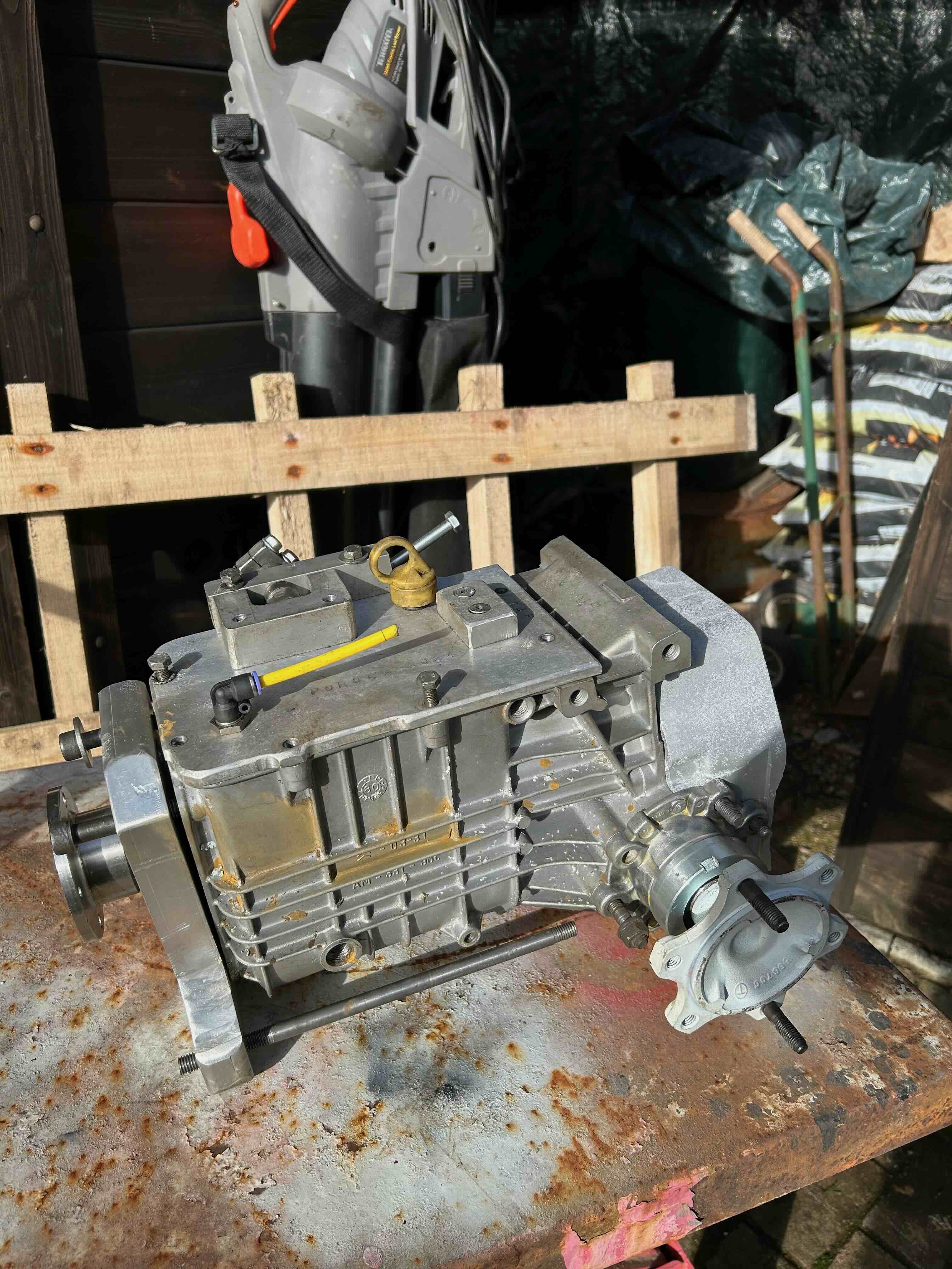

Almost done, new shafts made, need heat traetment.
Front Box.
Rear Diff/Box

How about the weight? On my rear diff, with reduction gears, with disc brakes the scale said 27 kg...
Didn't check the weight without brakes, I should check but maybe next time it is out..?
June 16th, 2026, 9:14 am
Posts: 2257
Post Re: Rear Diff with Reduction Gears.
With brakes 28Kg , but cut down bellhousing, cut down input shaft and no syncro parts:)
