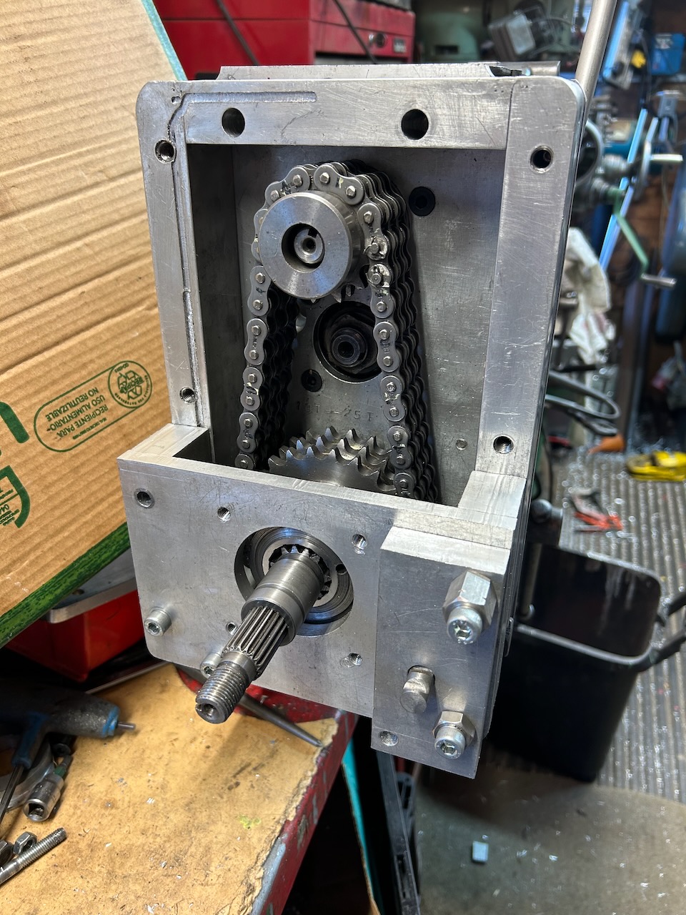

The saga so far.....
Standard parts, Modified Parts and new parts.
The "new" parts not yet, necceassarly in the correct order :)
Some of the bits to do ... Oil Seal for selector rod, and (gear) lever for selector rod.
Estimated additional total weight about 14Kg :(

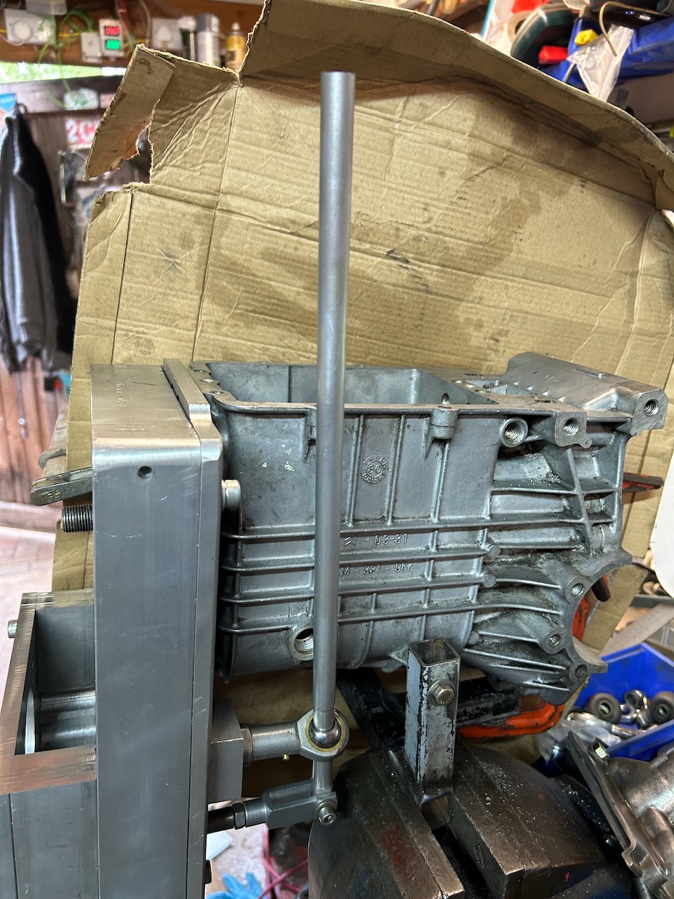

Selector rod parts. Seal and interlock.

Selector Lever...
Ouput Engaged.
Output Disconnected.
Access to Oil filler & level a bit comprimised :(

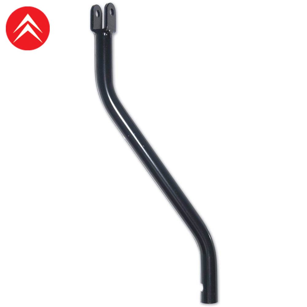

Bend that lever. A tight bend just over the uniball, and another over filler plug to the direction desired. Problem solved..?
July 6th, 2024, 1:57 pm
Posts: 2257
Feasable, also have a spare one of these

Re-made the Bearing retainer and oil seal holder, was somehow out of alignment :( :(
July 15th, 2024, 5:19 pm
Posts: 2257
After some very careful measureing :) , I can fit a triplex chain and sprockets, whick only adds 5mm to the caseing depth. Had to redo the selector interlock....etc

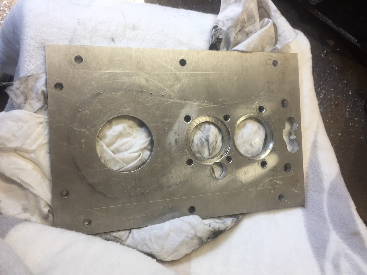

Means I have to make a new back plate:(
