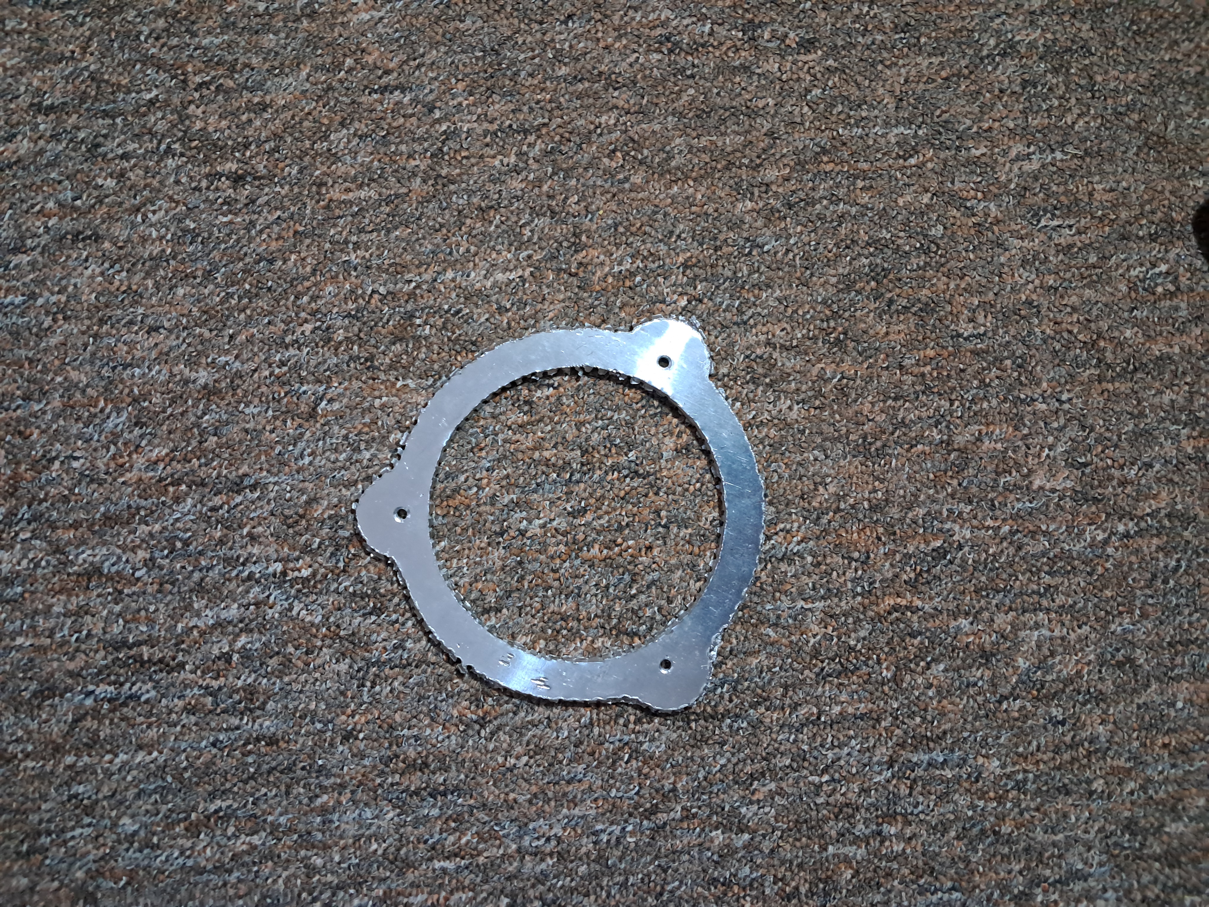

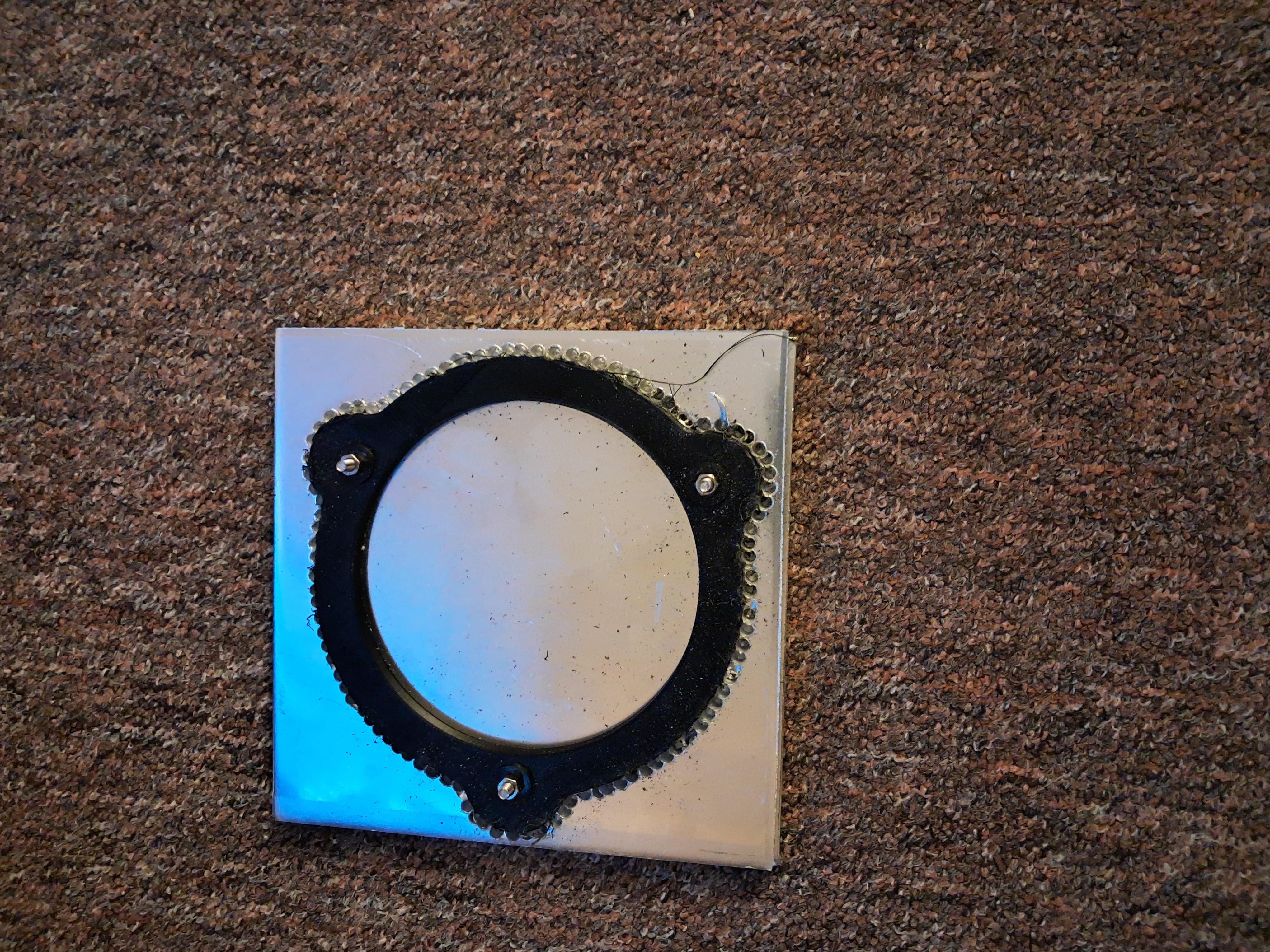

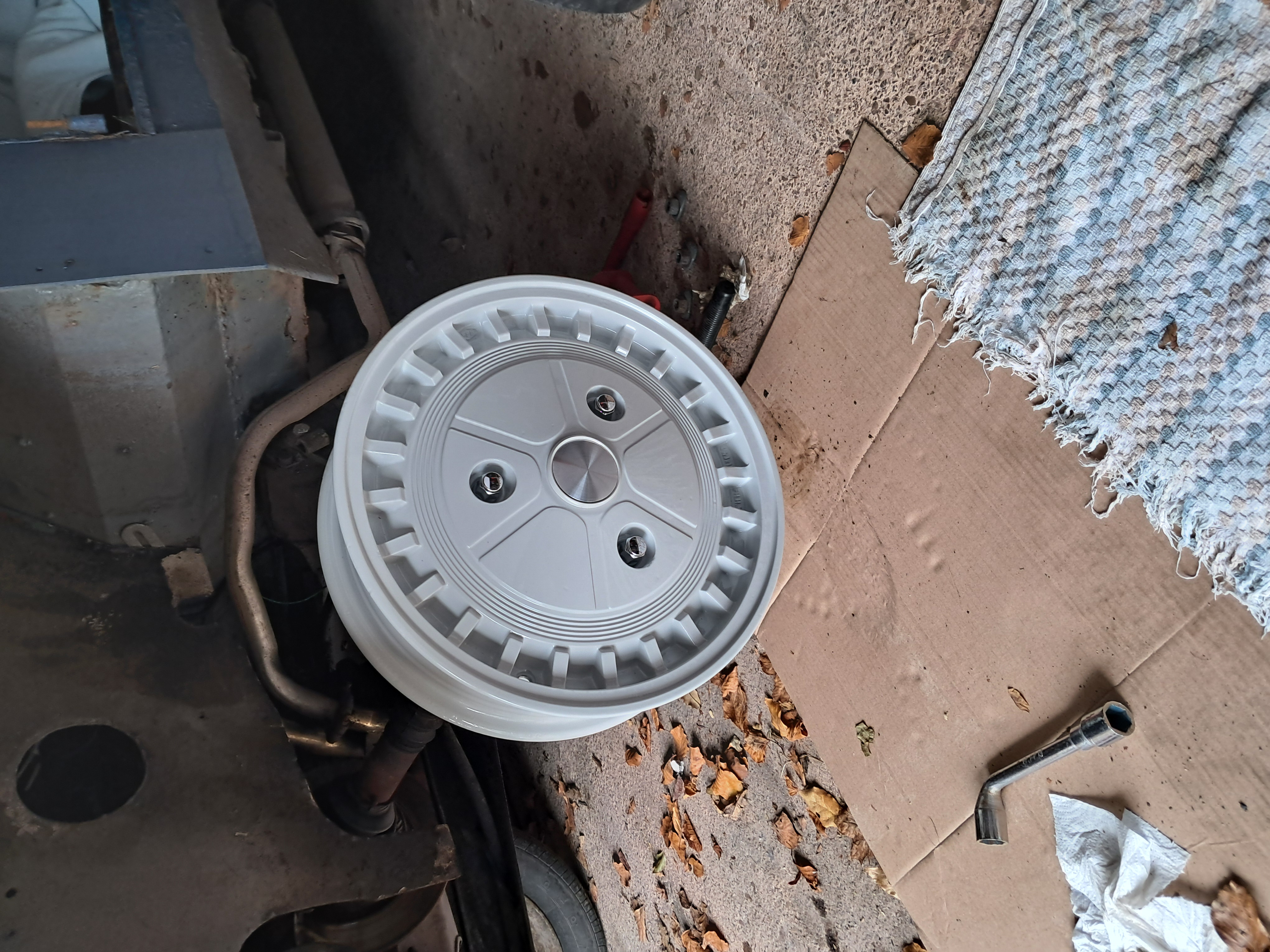

Some more progress :)
The spacer needs the rough edges cleaned back, but this is what it looks like in place. The stud holes have been drilled out since this image :)
I will look into getting a pair of tyres fitted this week. 145/65 R15

Post Re: My Beduino
Are this visa wheels?
February 19th, 2024, 7:26 pm
Post Re: My Beduino
GS/A
At least, I understand them to be GS/A :)

Post Re: My Beduino
Bolt patterns:
Visa 3x115
GS/A 3x160
2CV 3x160
Those are definetly GSA wheels...
One solution to solve the problem with steering and GS wheels. Drill another holes 8mm further, on steering arm, or make new M7 threads to *part where is bearing and the steering arm bolted in...
But, I think the spacer is better, then the wheel will be at right spot. With that steering arm re-aligning, wheel bearings don't last as long as with original. Some friends made that modification, and they all find that problem with bearings...
One other solution is still to be tested, after I can have some spacers made. Put a 6mm spacer between wheel flange and bearing, so the flange comes 6mm out of hub. I think there is enough at drive shaft end, to make that. With photo that should be much easier to explain, maybe when that is tested..?
*Really, forgot that part name. Hub? No. Something else?)
