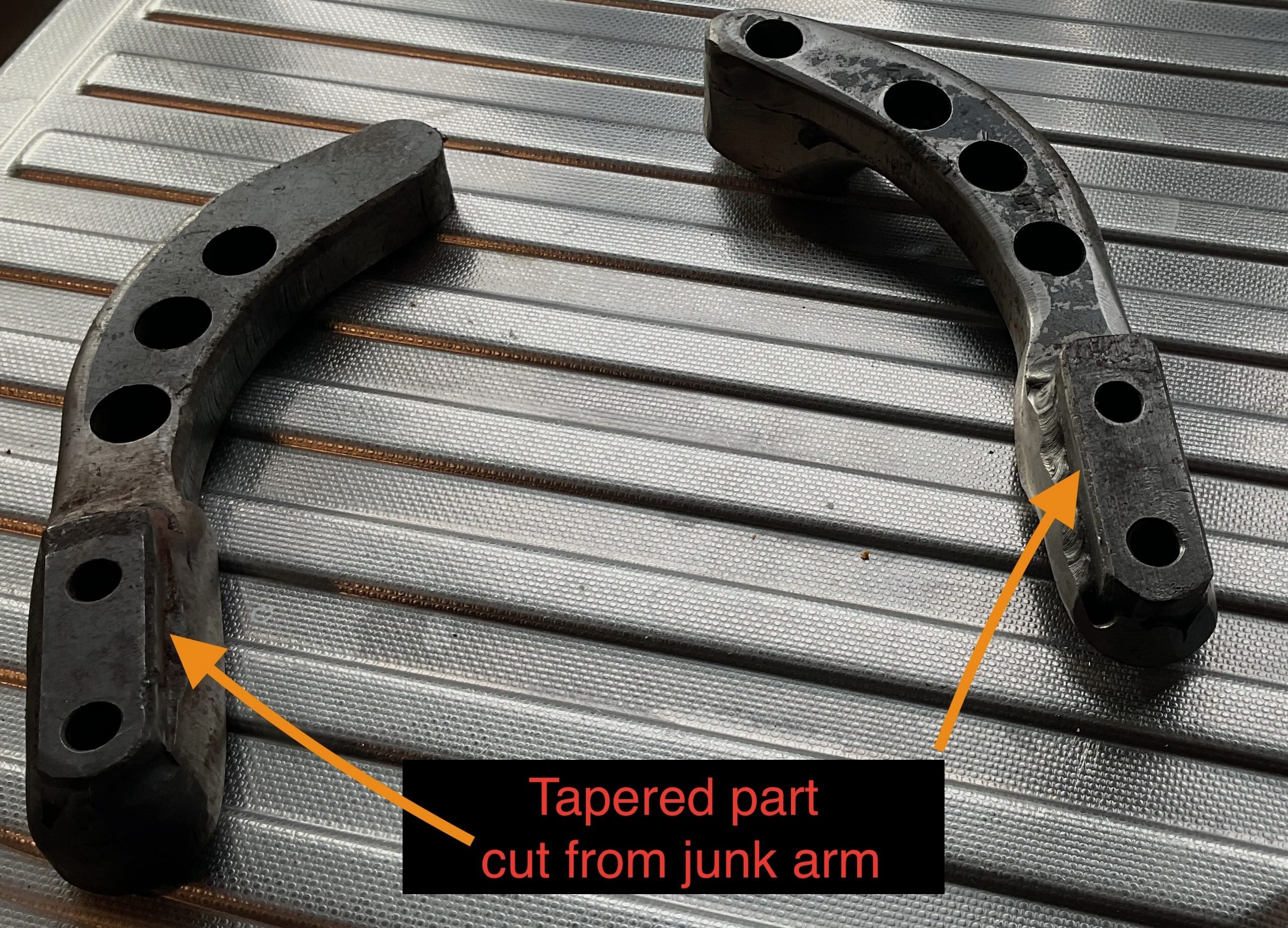

I did have some “arms” laser cut from 20mm steel, reduced with lots of grinding with an long ht bolt and rod end.
Will dig it out and do a photo also got a quote for longer wheel studs, but at £8 each didn’t go that route.
Unfinished, the taper foot from a junk arm is welded in a rectanglar hole.
Welding not approved fot steering parts, but who will see it:(
