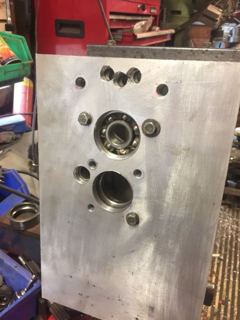

Back cover machined, fits well and retains the bearings properly. now to fit the extra shaft housing.
