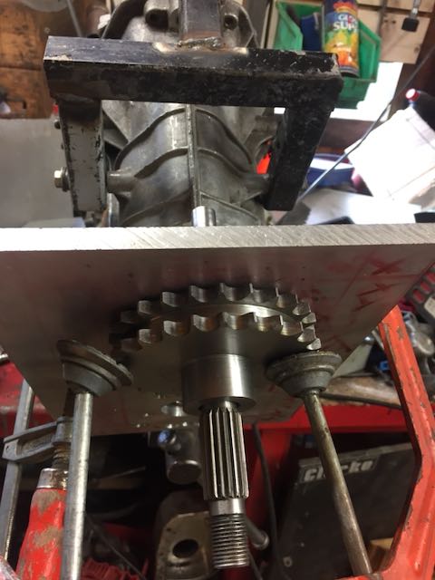

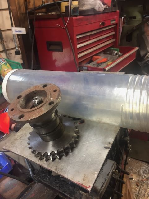

Using industrial duplex chain, 08B size, Looked at automotive “Silent chain” but can’t get the ratios, and new parts are very expensive.
Will have a step down ratio (13:25) and dog clutch at the gearbox end,
Rear cut down Diff / prop always connected.
Waiting on some “alu” plate at the moment.
Will post some more pics…..

Back cover machined, fits well and retains the bearings properly. now to fit the extra shaft housing.

Chain arrived , try out for clearances and a rear cover.
