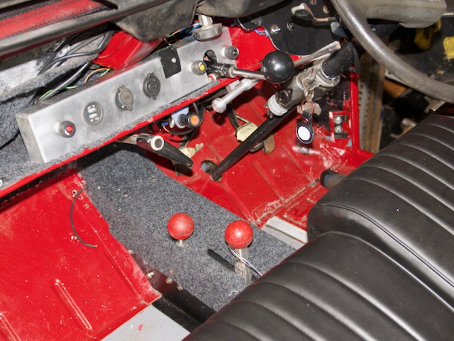

Inside Dash and propshaft tunnel etc
Prop tunnel is fabricated from Alu, saved about 8kg from the orginal heavy steel version, coved with thin carpet to reduce sound/resonce.
Extra panel for USB, Diesel Heater Control, Map Light, Reverse lamp, Alu Lever is the rear brake line lock valve.
Speedo from a Quad with small speed sensor (no need for a 2.5 meter speedo cable from the rear diff)
Citroen switches/ and relays and lamps with LEDs fitted.

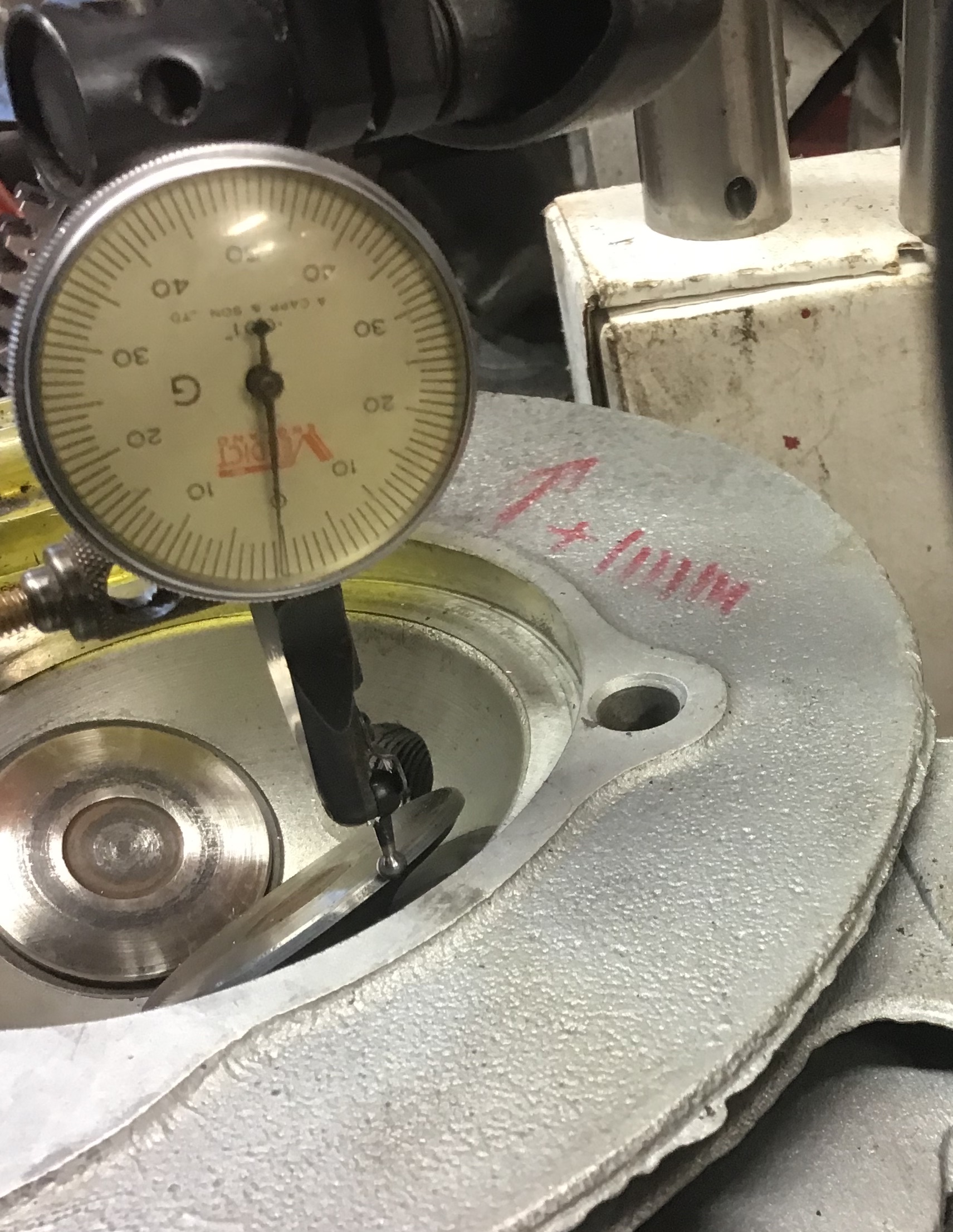

Cylinder Heads.
Exhaust Vales ok.
Inlets to much wear, so new items.
Using my £10 dial guage (Car Boot)
Tubes fitted with rawl plug M8 (have made a more robust tool.)
Also M8 exhaust studs the old M7 studs very rusty.
Head on left after Vapour Blast :)

Who did vapour blast?
December 3rd, 2022, 11:10 pm
Posts: 2257
Post Re: EPB Refurb
MTP Services
Unit 1, Ladygrove Business Park
Mitcheldean
Gloucestershire
GL17 0DS
Cylinder heads £25 !
December 4th, 2022, 10:32 am
Post Re: EPB Refurb
I don't like spending money on things like that :(
How much better will it make it run?
December 4th, 2022, 5:54 pm
Posts: 2257
Post Re: EPB Refurb
Parts need to be cleaned before they are machined also allows any cracks or defects to be seen.
December 4th, 2022, 7:48 pm
Post Re: EPB Refurb
valid point :)
