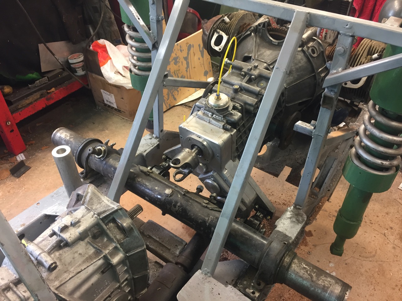

Fitted Engine and front diff into the chassis.
Couple of issues, the front of the engine is to high, which makes the transfer shaft slope down at the rear.
Will need to make some other engine mounts, to allow the front to sit lower...

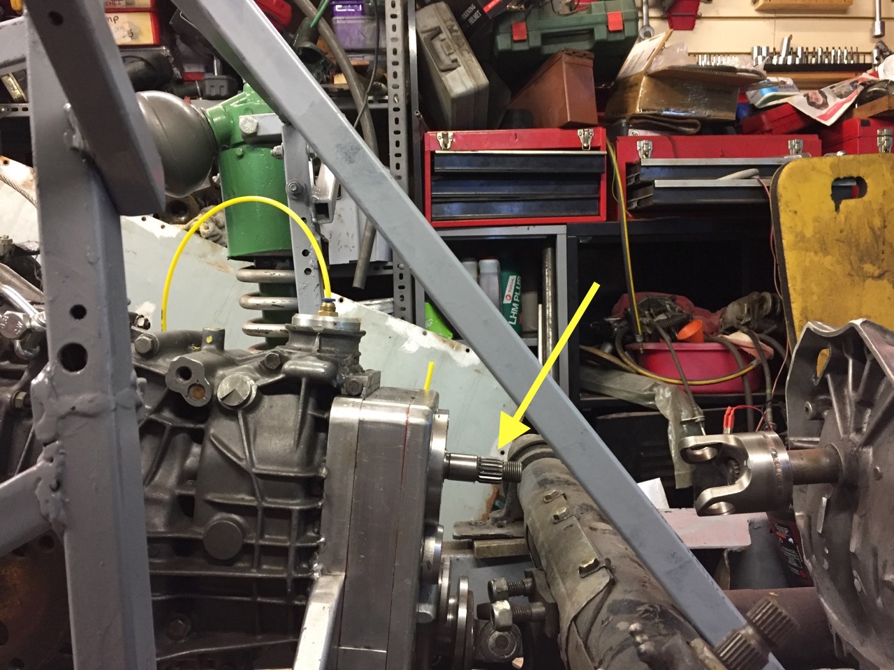

Braces for the front struts need "redoing" to allow drive shaft to clear.
