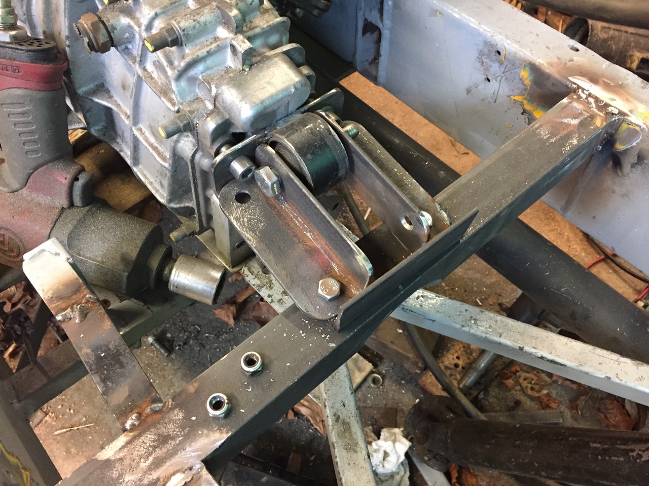

Two welds forward one weld back...
As the remote gearbox need to align with the transfer shaft had to adjust the 2 side mounts and remove the rear lower mount and fit a mount at the top, not very pretty but will be painted.
Old Mount.
New Mount.
