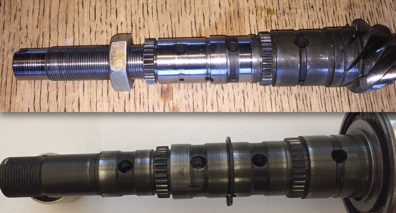

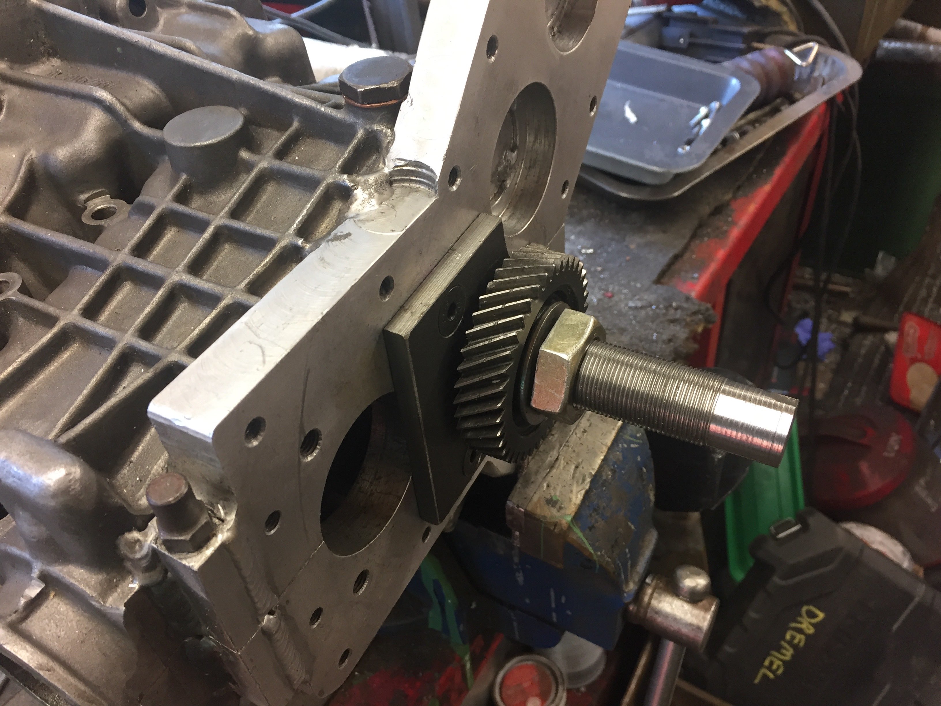

Additional issues after the "spoilt" pinion shaft.
Cannot successfully fit a 4speed diff in a 5 speed case?
Discovered that a LN diff is about 5mm smaller in diameter, it has 8/33 ratio, so I have machined the pinion shaft to allow the same special bearing to be fitted. Have to admit defeat on the threading,broke too many carbide inserts:(
Found got a company in Gloucester to thread the M24 onto a very hard shaft:)
Before and After.
In situ.
