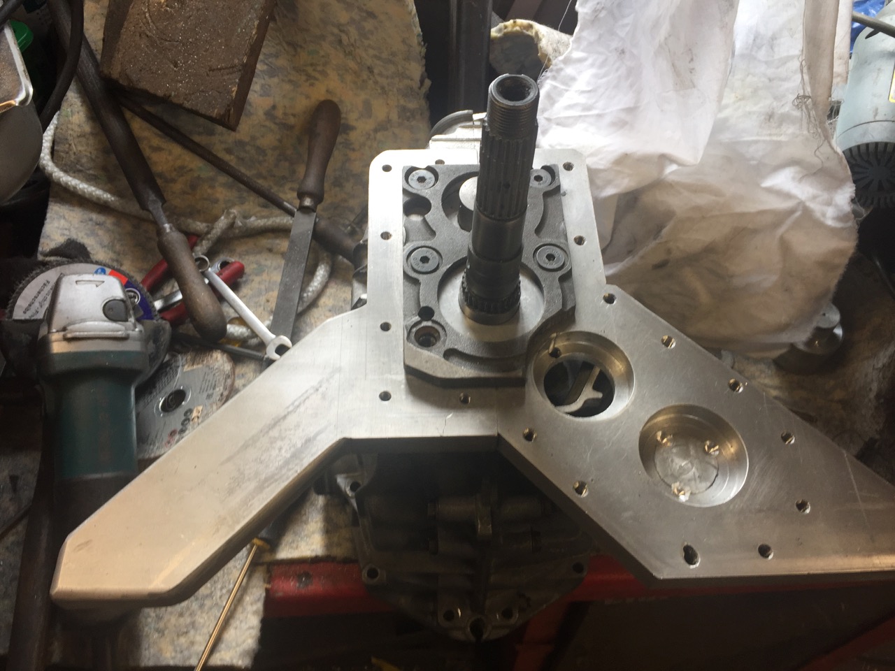

The back plate, 2 halves, alll lined up ready to be welded to the main gearbox case!!!!

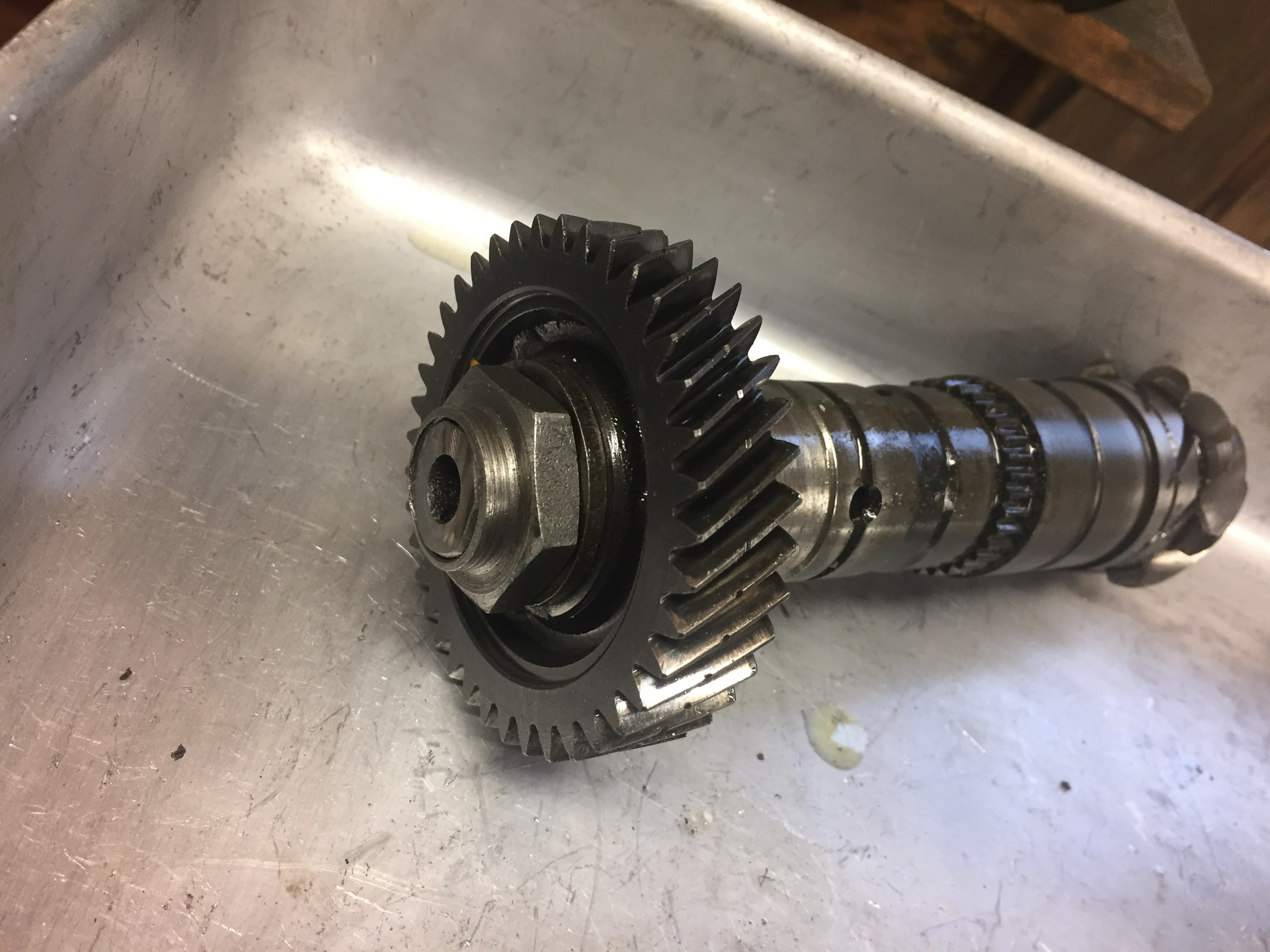

Shortened Main Shaft.
Needs to be threaded to take a 20mm Nut, however a bastard of a job as the shaft is very hard :cry:

Now with M20 nut. :D

2.5 or 1.5? Lathe screwcut? What cutting tool?
Spill the beans Pete!
March 4th, 2017, 11:59 pm
Online
Posts: 2258
M20 x 1.5, Tried to cut on the Lathe, it does Metric threads :D.
Broke the carbide inserts :oops:, the first pinion shaft I did was done successfully??
Rummaged through the die collection and I had a die, had to buy (ebay) a large die stock.
Turned the shaft down, it was a very rough finish.
Used the die to cut the thread looks OK and the nut fits nicely.

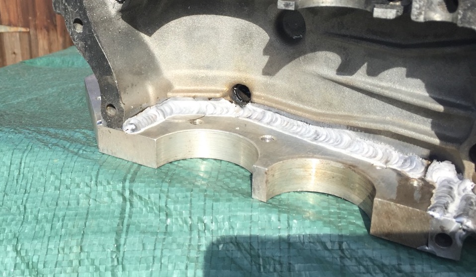

Quality welding, thanks to Ian at Allisport Ltd.
