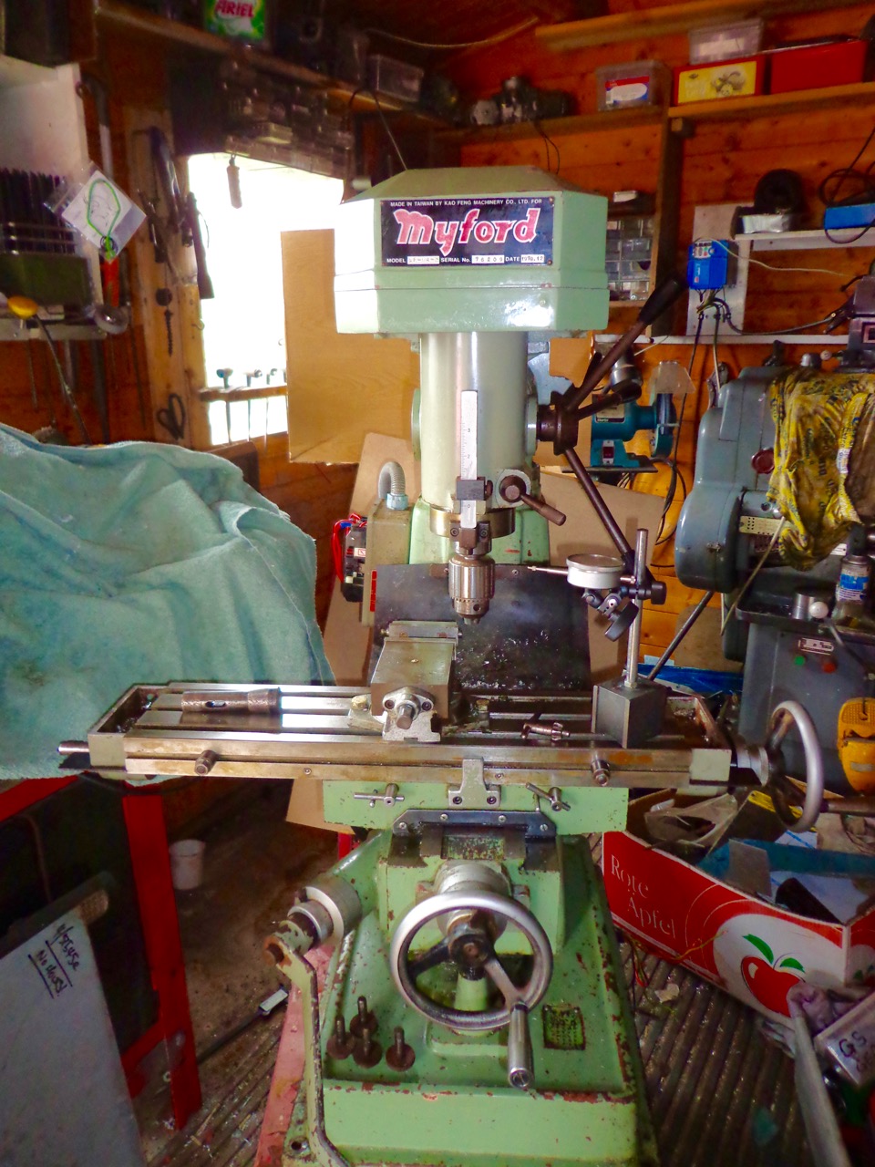

Latest Aquisition - Myford Milling Machine.
March 22nd, 2016, 3:18 pm
Good choise.

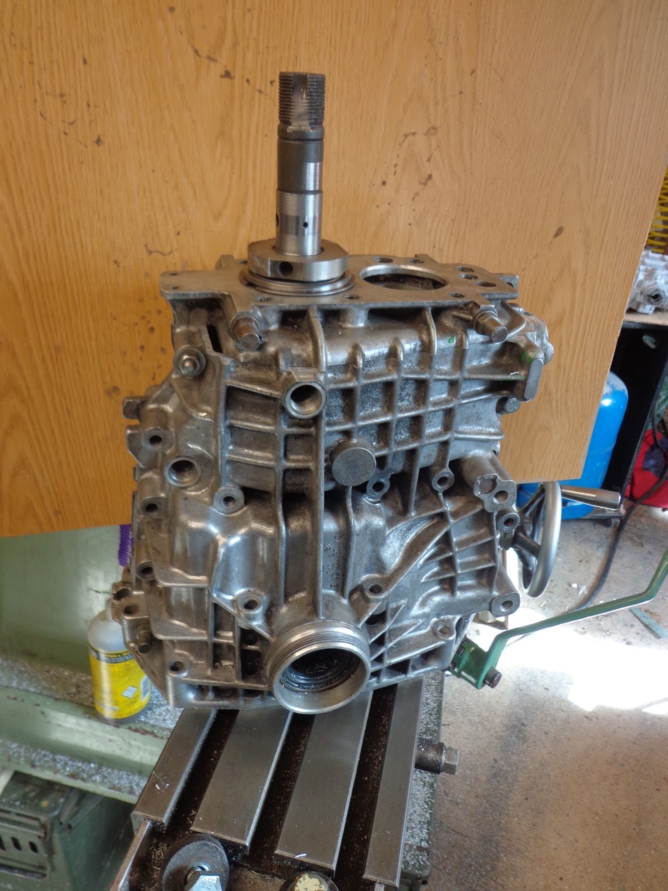

First time REAL use of the Milling machine.
Milled the back of a gearbox....
More bigger bits to follow.....
March 26th, 2016, 4:25 pm
Posts: 2258
Milled the the gearbox flat, need to get the back welded on, and then get the shaft shortened.
Gearbox is about 9cm shorter.
The plan being..... to put a standard steering set up on the front, this stumpy gearbox will just fit, with the drive going under the cross tube.
Well thats the plan :?
