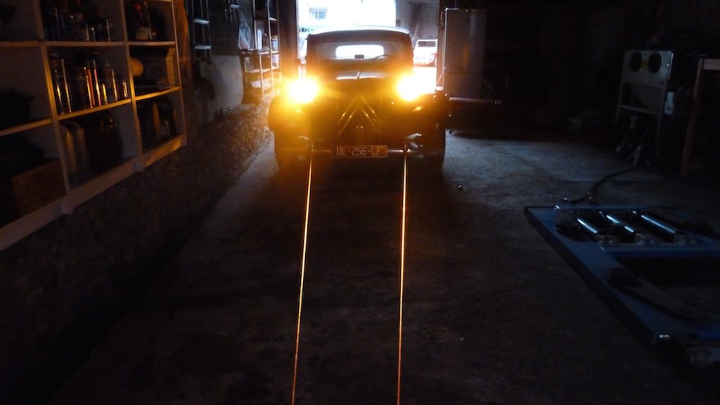

I have booked it in for its Controle Technique tomorrow morning at 09:00 so I have been busy getting it all ready. Set up the lights last night as per the book.
