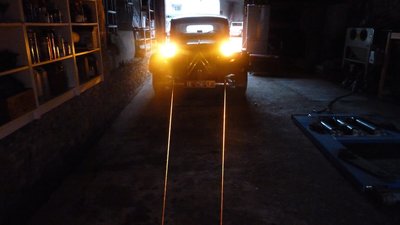

I have booked it in for its Controle Technique tomorrow morning at 09:00 so I have been busy getting it all ready. Set up the lights last night as per the book.

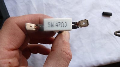

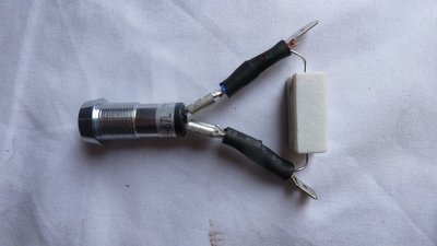

Then fitted a resistor to the LED for the alternator field current (charge light) - this worked perfectly.

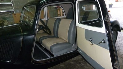

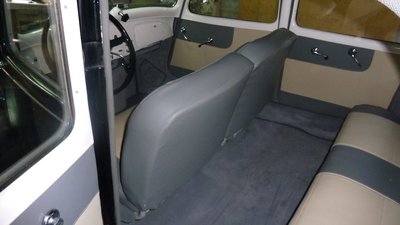

I put the door panels on and the inner window frames so this is the first time the interior has been finished. Not too happy with the fit of the door cards but I will need to remove them when my sticky back plastic arrives to weather prove the inside of the doors. The handles seem a little loose too. But a nice change to what it has been.

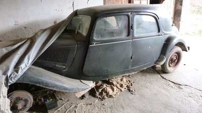

This is how I found him in November 2013 and started to work on him in March 2014 so one year to get him back on the road :shock:
