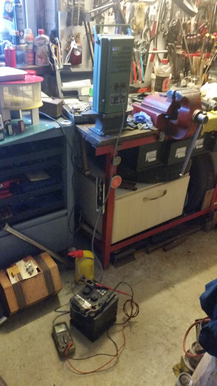

Wanted to get the 57 from the garage but starter turned slow. So checked the sparkplugs. Cleaned and tested there was a very weak spark... So took the battery home to hook it at the large vintage Philips charger 6 amps. It did charge all evening and held a 6,7 volts which is normal... But this morning there was only 4 volts left, so one of the cells must be dead. So game over. I did order a new battery 140 amps in stead of the 66 amps i had now. That gives some more starting power...

Got a new battery a bit more amperes than the old one. The car started within half a turn of the engine now. Only brakes are a bit weak. Will have to check this... Or i am used to the disc brakes... :mrgreen:
