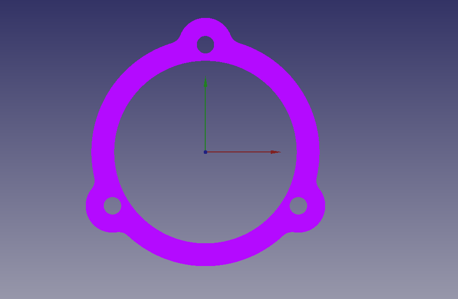

I've ordered some 6mm plate for the spacers. I picked up a pre used drill press the other day, so will be careful cutting out the middles and edges. Then I will have some scrap alloy to practice tig on. :D

Iv'e designed and 3D printed a template for the spacer.
I will probably print templates to fit in the wheel stud holes to aid centering the pilot drill. Then I think I will bolt the template to the Alloy, and work my way around with the drill. Then finally file it to the finished shape.

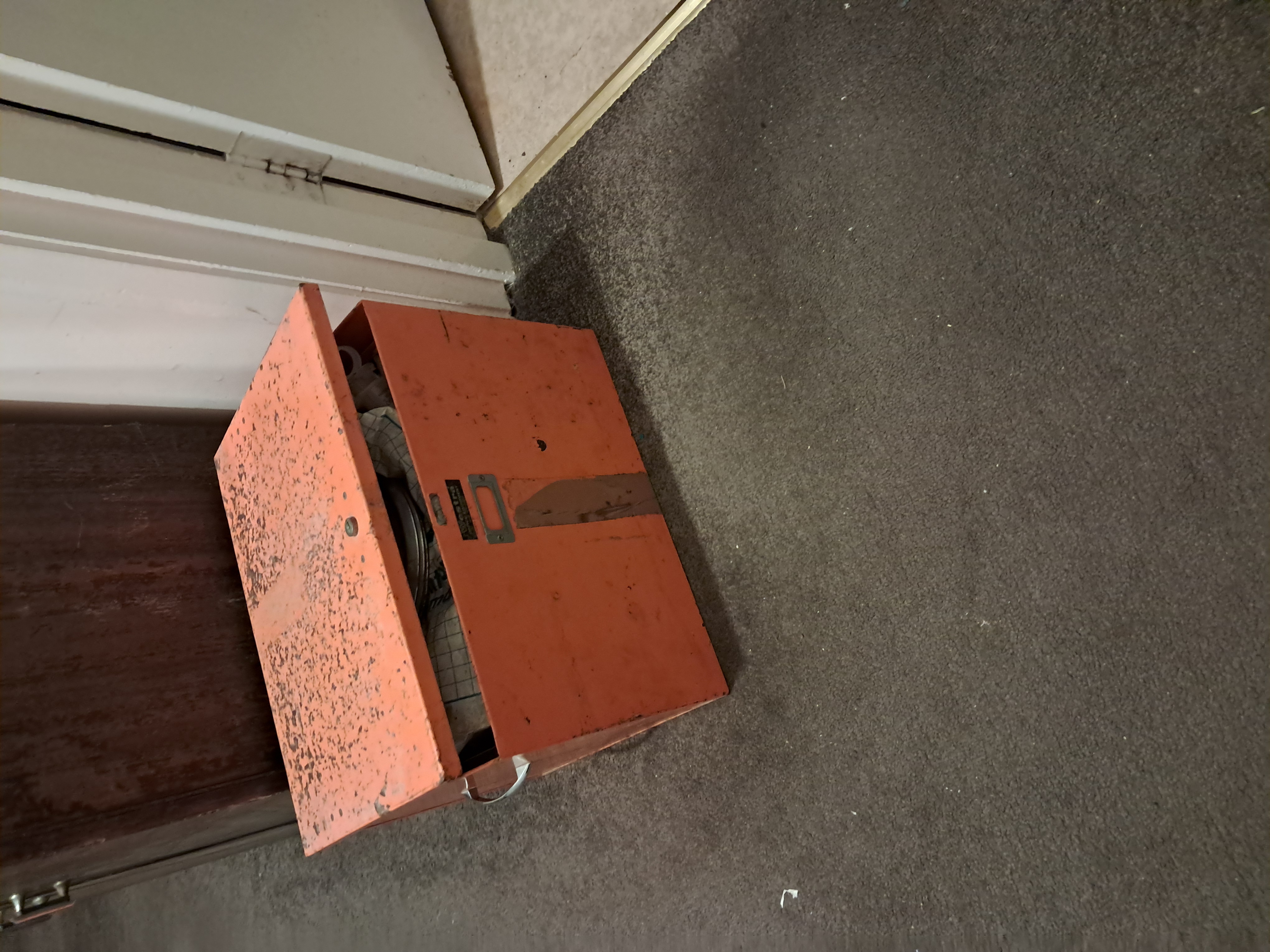

A chap contacted the local group to say he had some 2CV spares to clear out from the garage. Been there there a good while now, and free to whoever wants it, or it goes to recyling.
So I trundle up to Okehampton from Exeter. About 30 miles. And pick up an orange box!
2 alternators, 2 carbs (one is single venturi), 2 fuel pumps. 2 fan belts. 3 hub caps! Brake shoes, brake cylinder. What looks to be a brake centering tool made from a cut up drum. A cut off gearbox primary shaft to use as a clutch centering tool. And a multitude of other bits and bobs rattling around in the bottom of the box. :D
It's not a box you would want to carry to far!

The single venturi carb, what would that fit?
February 10th, 2024, 11:17 pm
Posts: 1201
Post Re: My Beduino
2CV 4, 425/435 cc
