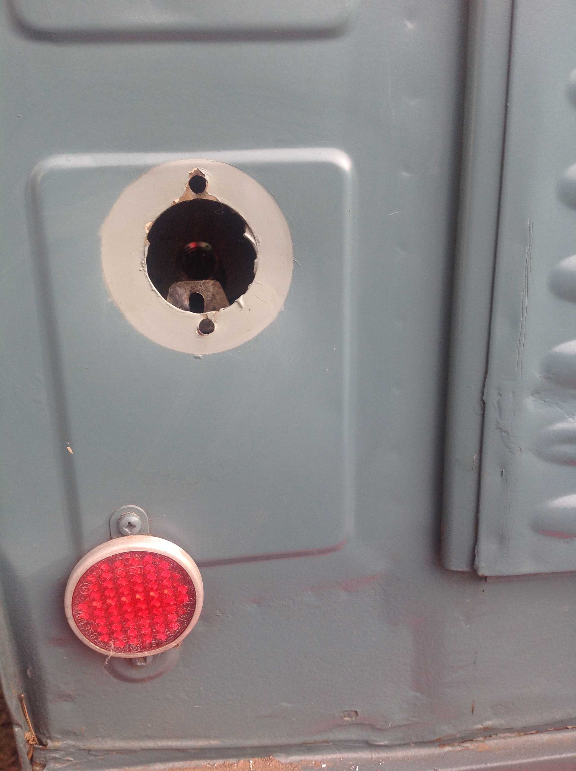

Started to dabble now, after christmas. Fixed all the lighting (added extra earth mods to the indicators to make them brighter), rewired the rear lights.
I think I have found the original paint now and it matches the AC513 etched in the engine bay. But I will probably paint it grey when I get round to it.
File comment: AC513 behind the rear light fitting, must have been a class respray.

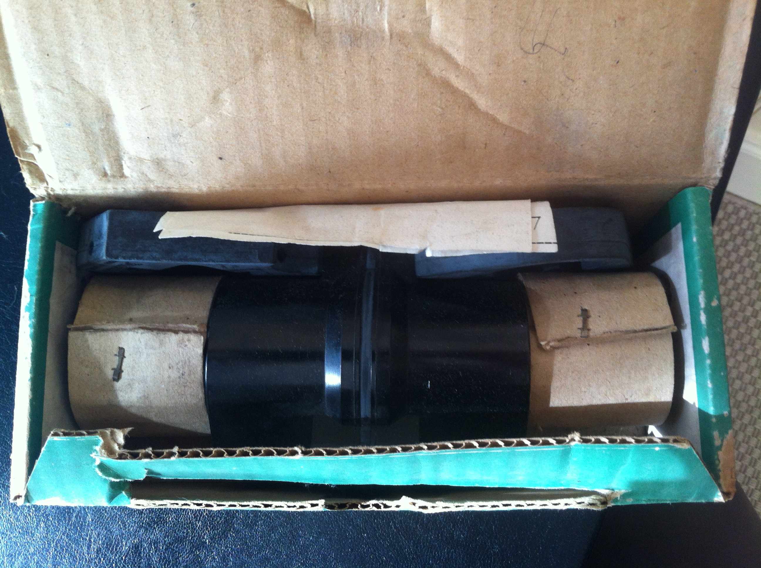

Love getting "NEW" parts. The posty just dropped this off for me. Brand new in the box. shame to have to use it.
File comment: Brand new in the box 6 Volt Bobine.
File comment: Nicely packed with instructions

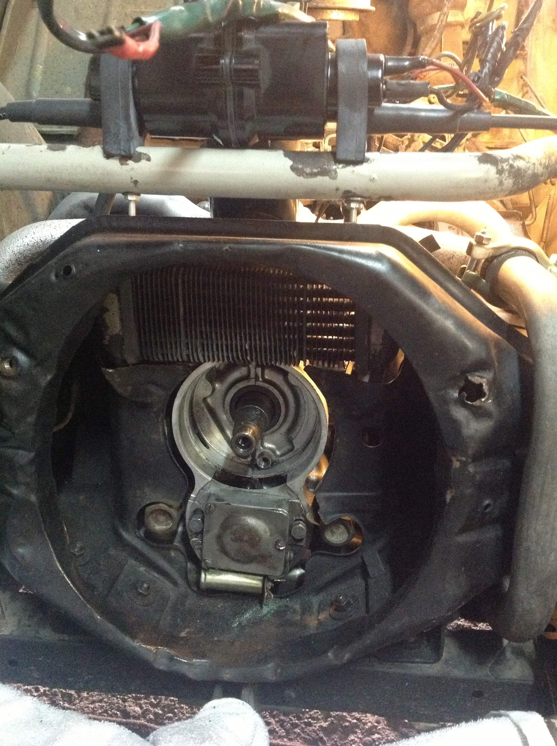

Good day today. Got all my lights working correctly, brakes, rear tail lights, indicators and headlights. I changed the bobine out (because I bought a new one), the leads and spark plugs. Renewed an inlet gasket which was blowing, changed the wiper blades and ran new tubes for the washer (only to find my washer bottle has a split in it).
Now I am just waiting for my new fan to arrive and I will be on the road to the CT test centre.
File comment: New bobine fitted and leads
_________________ https://www.facebook.com/GNGLuscan

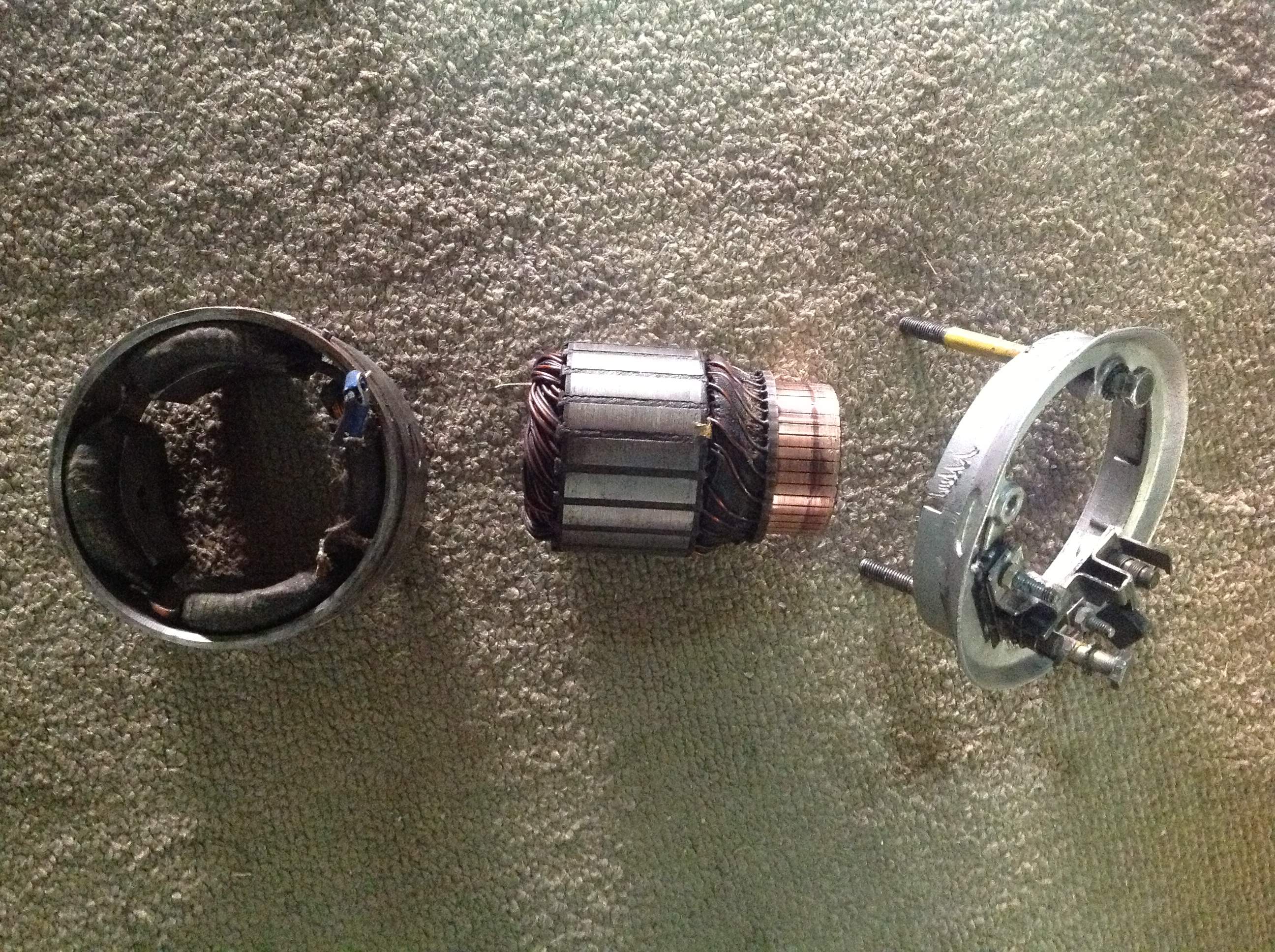

Here is my old dynamo - I will check it against the new one when it arrives to see if there are any startling differences or damage, but at the moment I can't see any. Attachment:

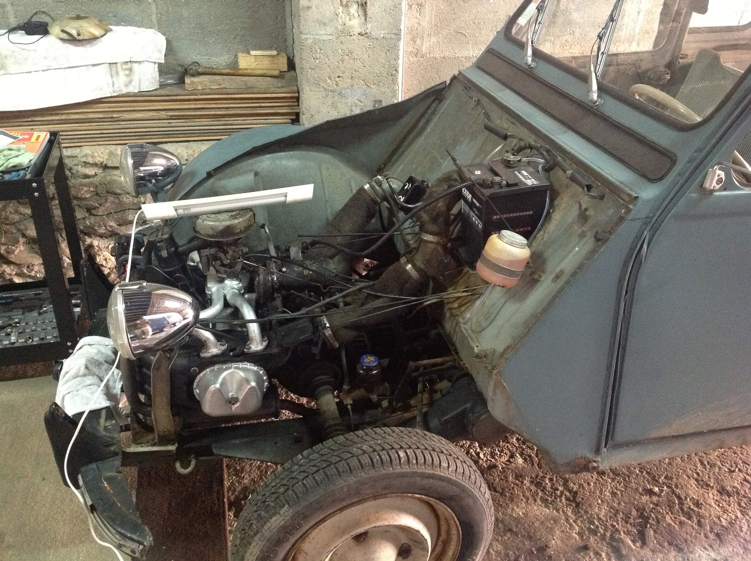

And I finally plucked up the courage and removed a wing. Found a little more rust but I had assumed it would be there as I will have to replace the floor panels (currently covered in fibreglass) but other than it looks OK. I have now moved into the Barn so a little more comfy. Attachment:

Hi Ian Looking at your new pictures (and looking back at your other ones) the end of the armature looks damaged like it was rubbing on the brush holder.
| January 11th, 2013, 8:08 pm |
Tripyrenees
Joined: December 17th, 2012, 10:03 pm Posts: 966 Location: Luscan, Pyrenees, FRANCE
 Re: Rene - The 1970 AZU AK250
Yep, that was my fault, when I put the brush holders back on, one was catching. I didn't notice until I saw the damage. I then adjusted it back but a little too late.

You need to have a gap between each copper piece. You can use a small very thin blade to re cut the grooves.
