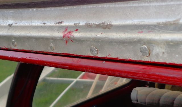

Are they aluminium rivets?
Yes, aluminium.
January 22nd, 2015, 5:59 pm
Posts: 2247
Alu Pop rivets are great and maybe the only option for Blind locations, but they can work loose over time.
If you can access both sides of the work try Aircraft style rivets, they are available on Ebay along with a Rivet set and not expensive.

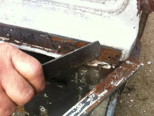

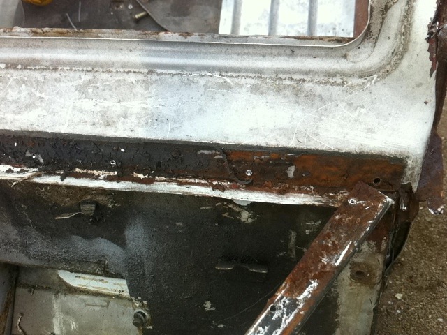

The car I bought, had the hinge mounted with rivets and sealant.
And it hadn't moved a mm for ten years.
There was some surface rust 10 cm from the edge in each side, but usually the entire hinge is gone in that time.

Aluminium and galvanised coatings react together.
January 22nd, 2015, 10:35 pm
If zinc plated steel rivets are used, that would be OK according to these folk... ;)
( Section 5A, galvanic corrosion)
http://www.ajaxfast.com.au/downloads/Aj ... ndbook.pdf
