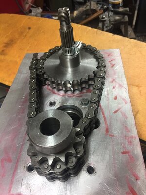

Post Transfer box.. A new version...
Any interest I will post more info.

Using industrial duplex chain, 08B size, Looked at automotive “Silent chain” but can’t get the ratios, and new parts are very expensive.
Will have a step down ratio (13:25) and dog clutch at the gearbox end,
Rear cut down Diff / prop always connected.
Waiting on some “alu” plate at the moment.
Will post some more pics…..

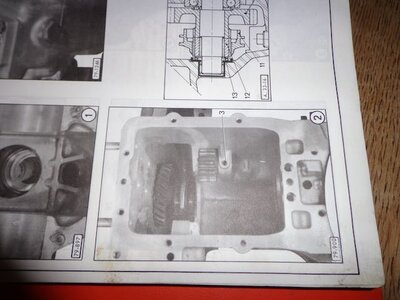

Why don't you use the output shaft, to hook you chain to, like a mehari 4x4 does to. Much less power evaporates and you can directly connect to your reardiff what you already have made.
October 28th, 2023, 5:10 pm

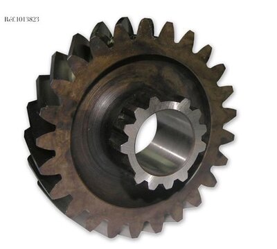

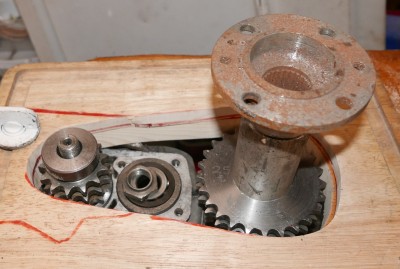

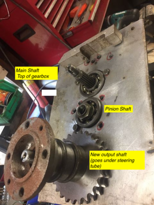

Posts: 2257
Hi Lpgo,
The Steering rack is in the way!
See Mehari documentation, extra gear and shaft below the pinion shaft.
ps
The Mehari 4x4 special gear and shaft etc are available at about €2000+
cheers

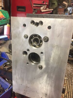

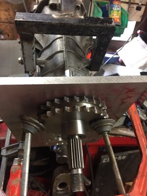

Posts: 2257

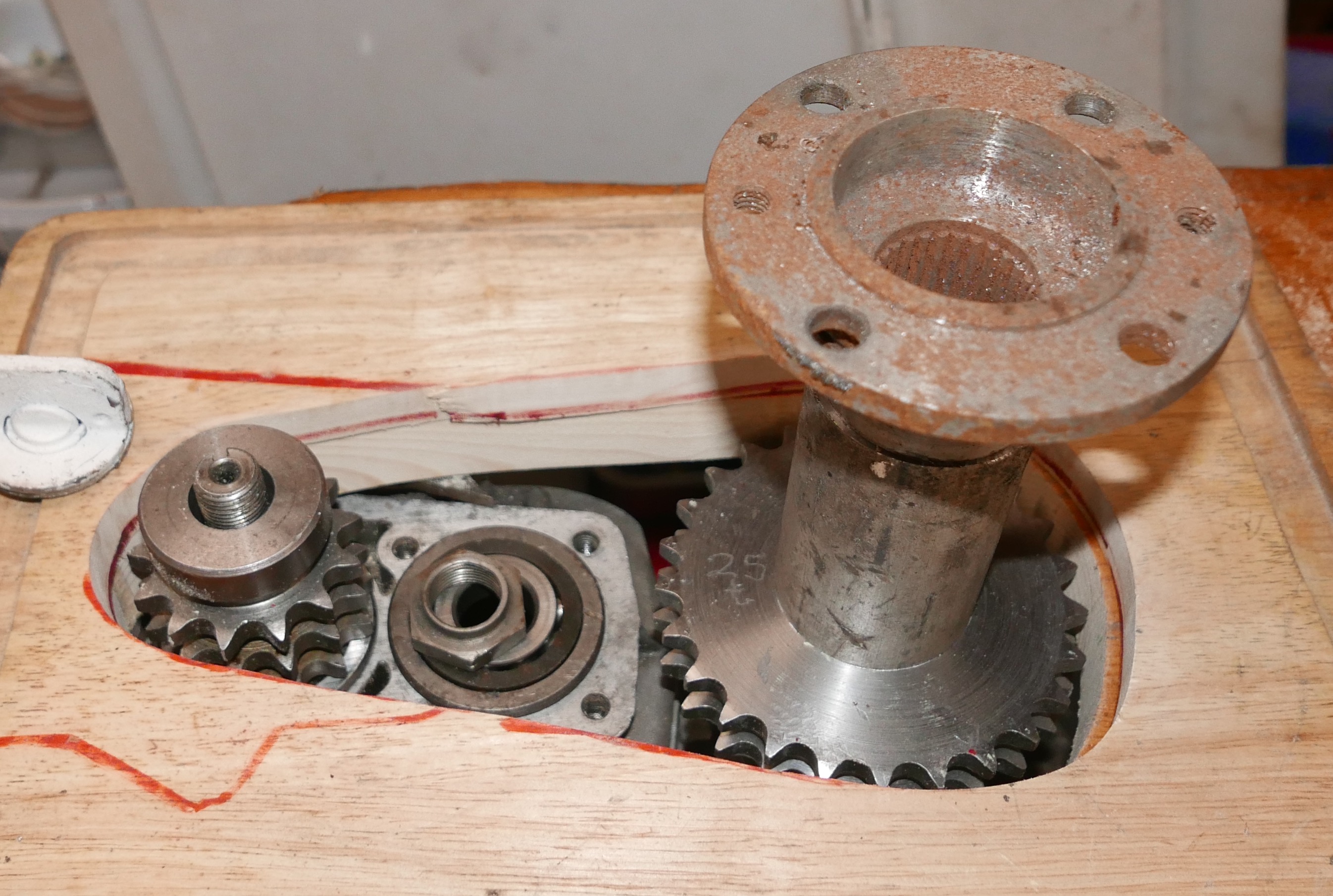

Back cover machined, fits well and retains the bearings properly. now to fit the extra shaft housing.

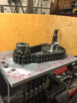

Posts: 2257

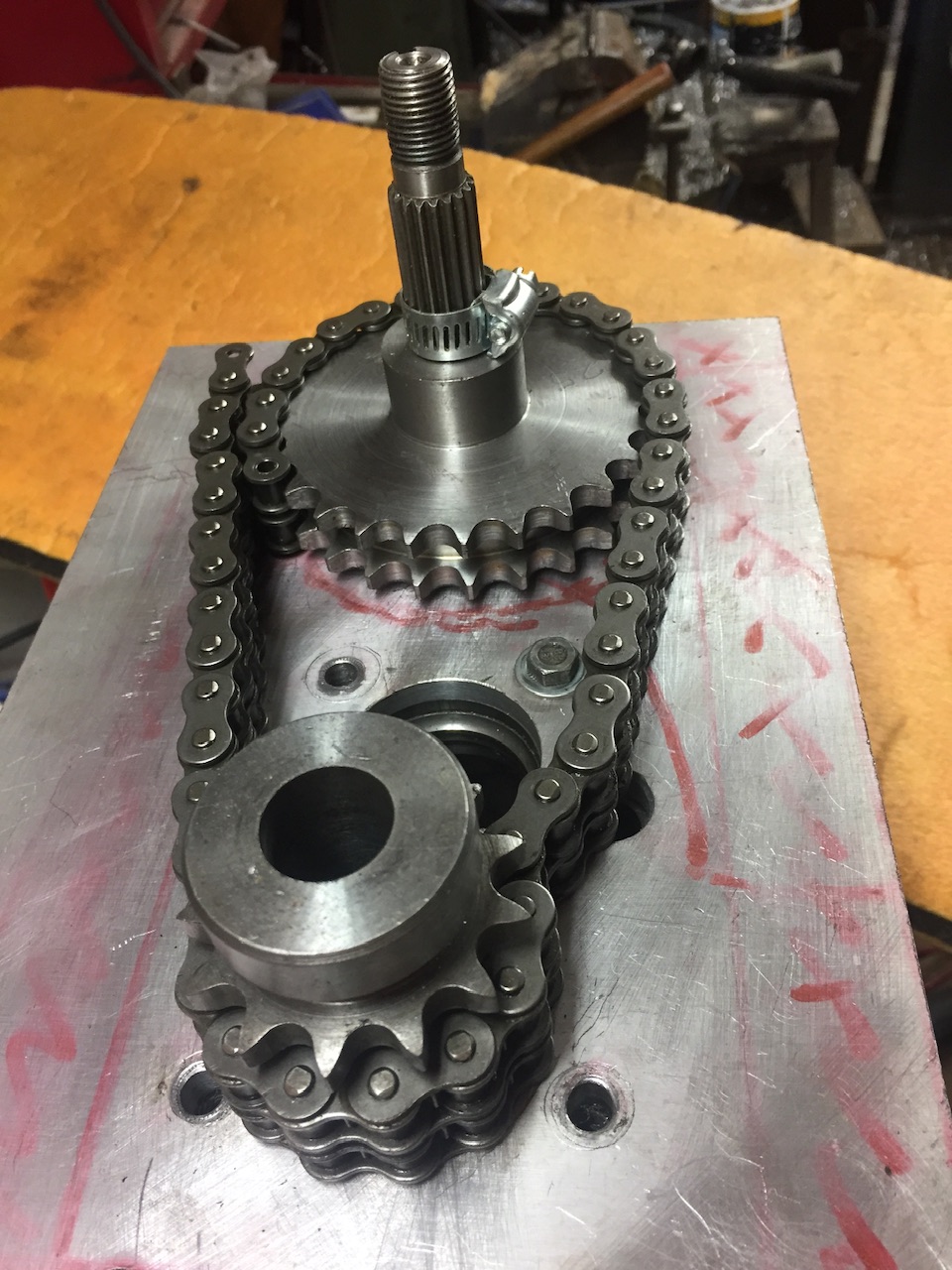

Chain arrived , try out for clearances and a rear cover.
