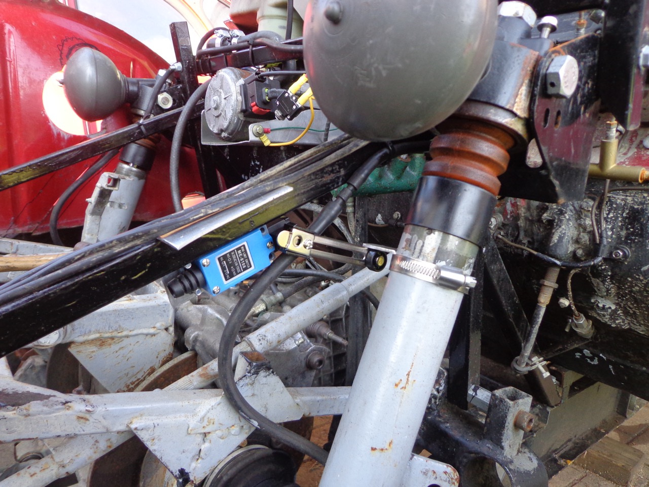

Ride Height.
Going to try a simple limit switch with a LED indicator to show when the ride gets to its static height.
Limit Switch for the left side front Strut.

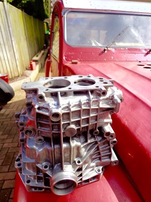

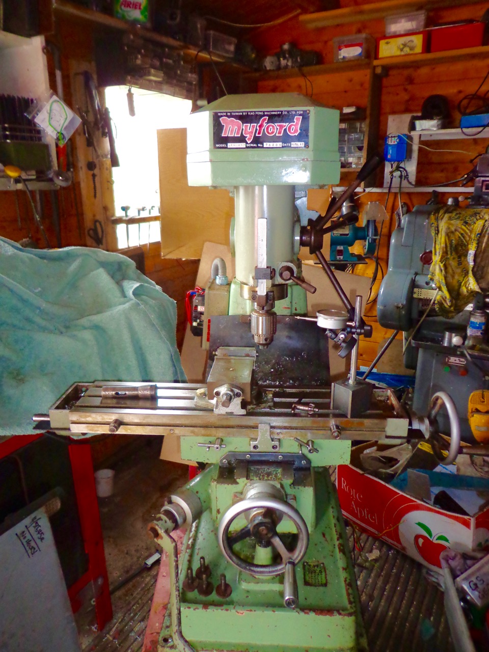

Latest Aquisition - Myford Milling Machine.
Good choise.

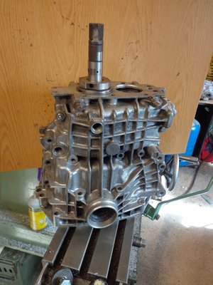

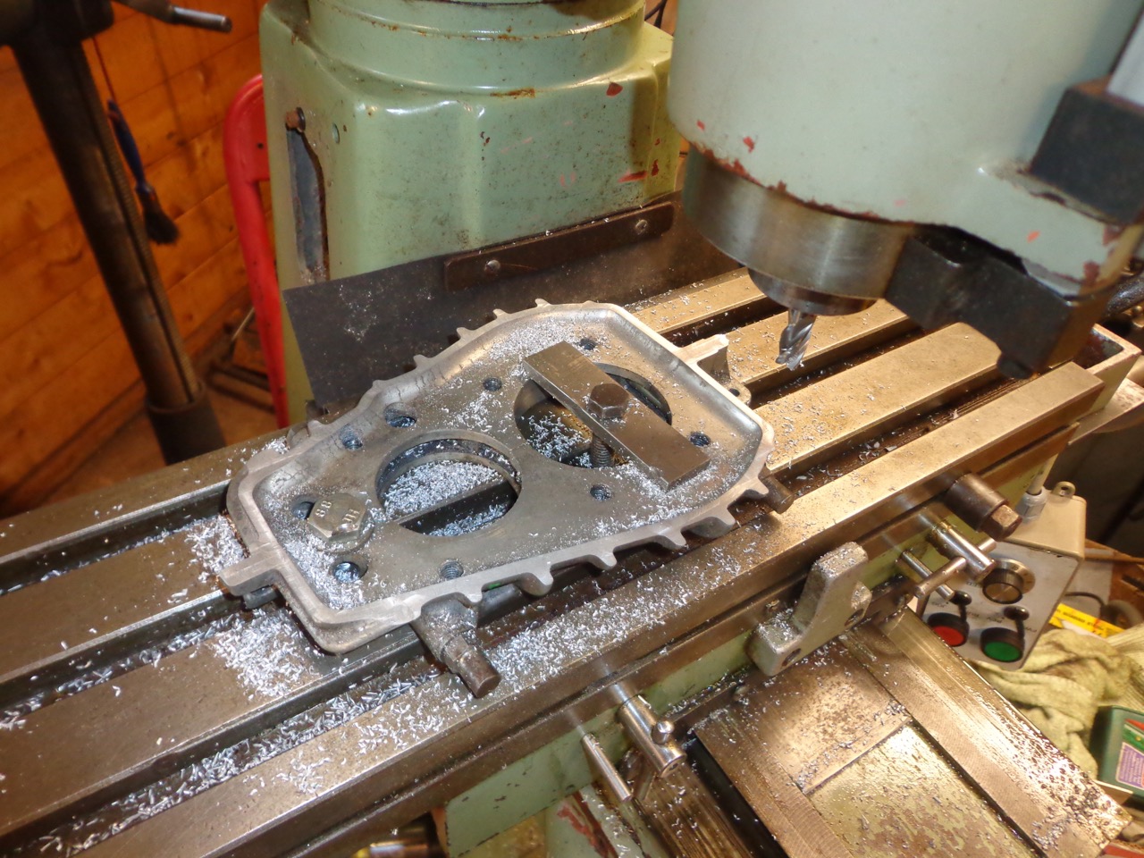

First time REAL use of the Milling machine.
Milled the back of a gearbox....
More bigger bits to follow.....

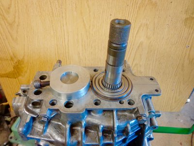

Posts: 2258
Milled the the gearbox flat, need to get the back welded on, and then get the shaft shortened.
Gearbox is about 9cm shorter.
The plan being..... to put a standard steering set up on the front, this stumpy gearbox will just fit, with the drive going under the cross tube.
Well thats the plan :?

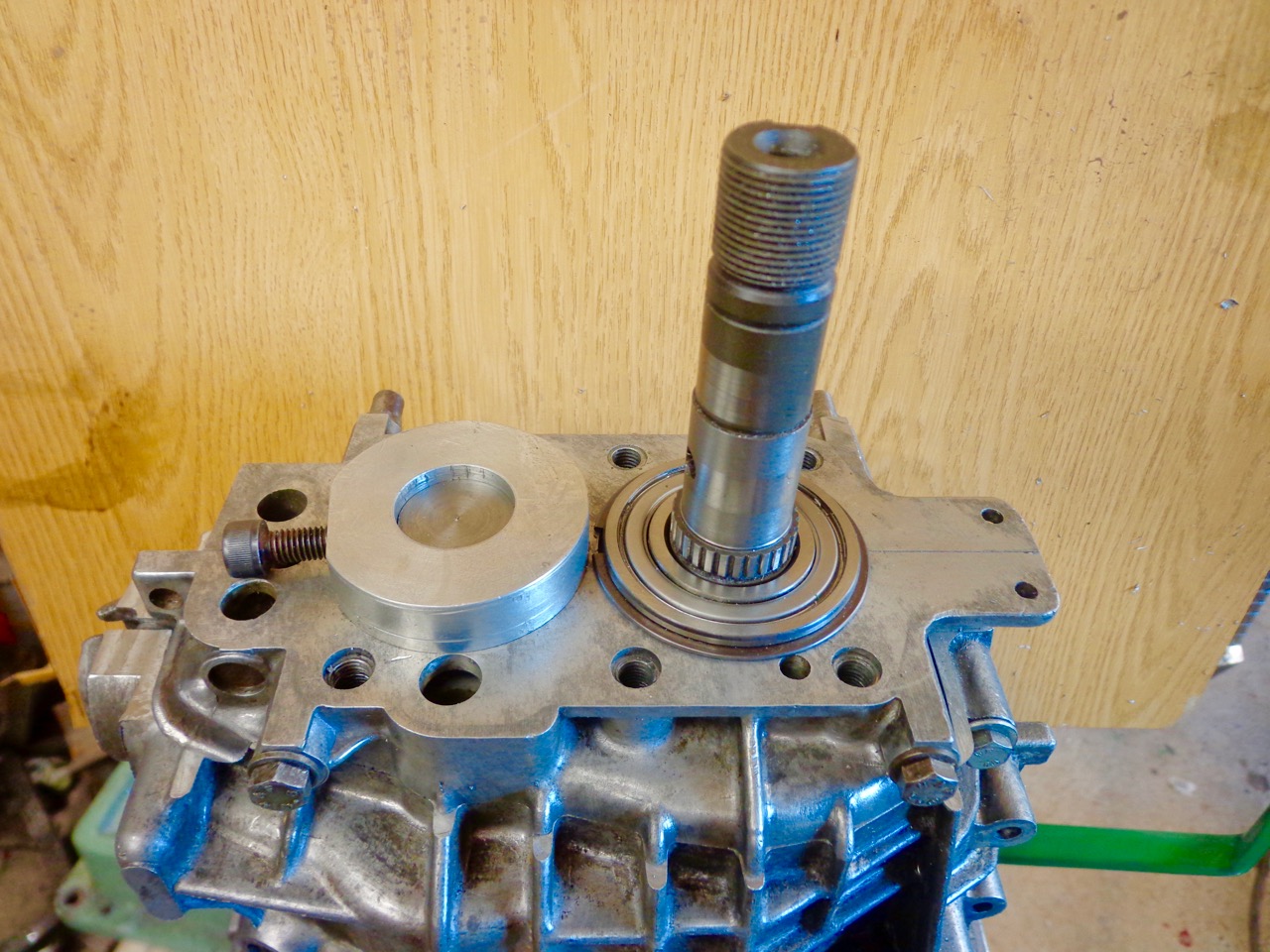

@Jasu, In the past have paid silly money to get things made, small machine shops are becoming extinct here, so DIY extends the budget, Its also very satisfying.

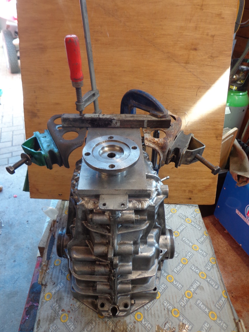

Made a dummy lay shaft, fitted the main shaft, with is new bearing, all aligned, ready to get it welded :o

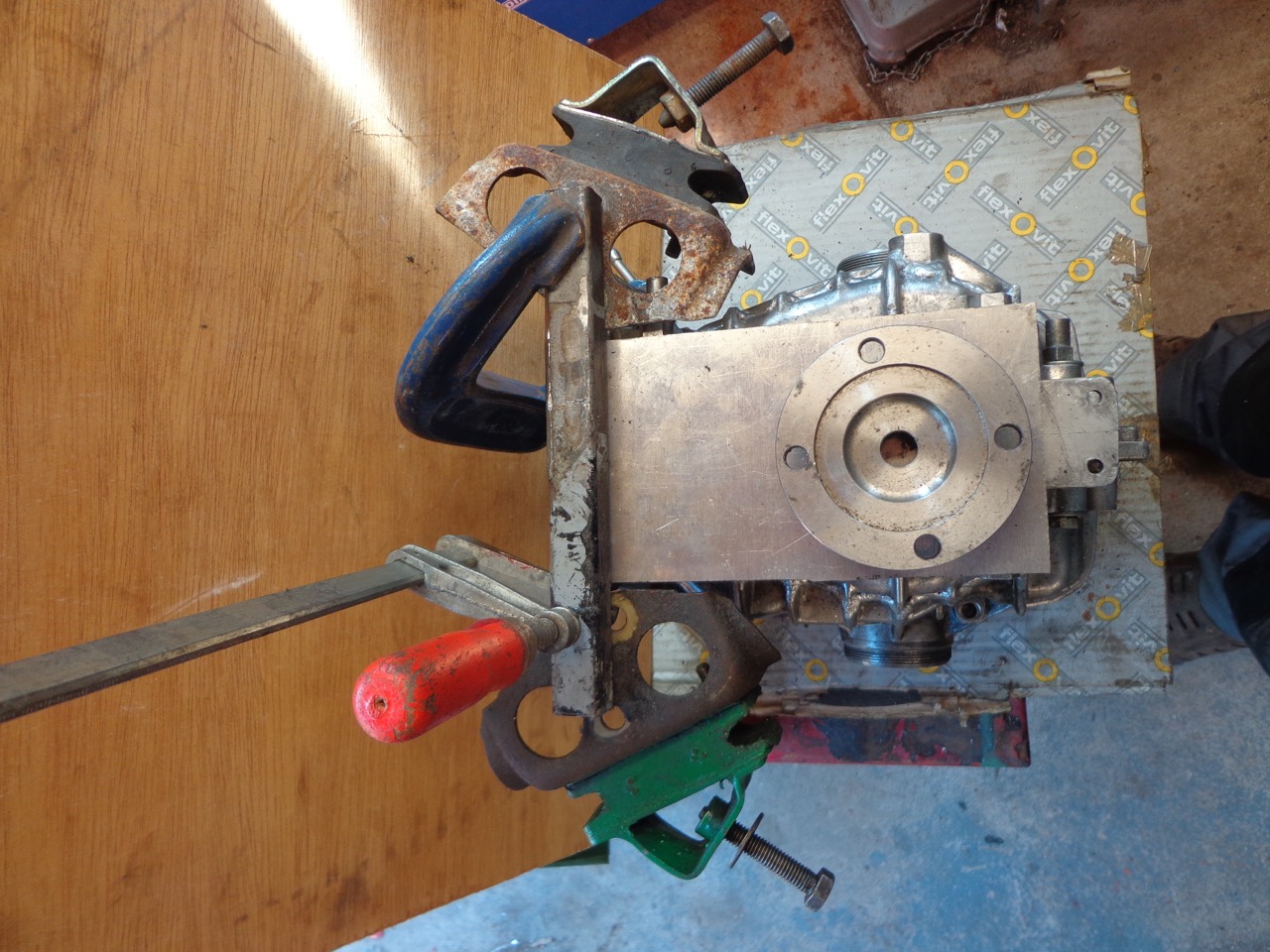

Posts: 2258
Mock-up for Gearbox mounting using 2CV Engine mounts.

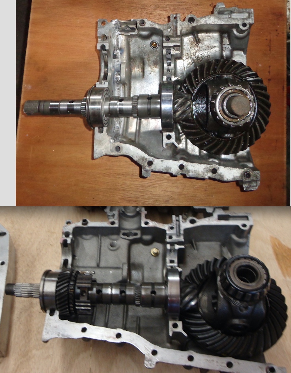

Posts: 2258
Comparison of the two gearboxes.
Stumpy Version at the top, Standard 5 speed at the bottom.
