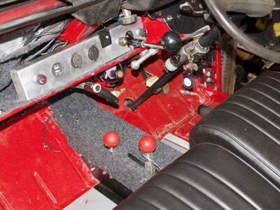

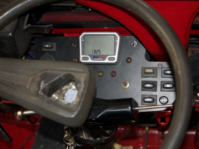

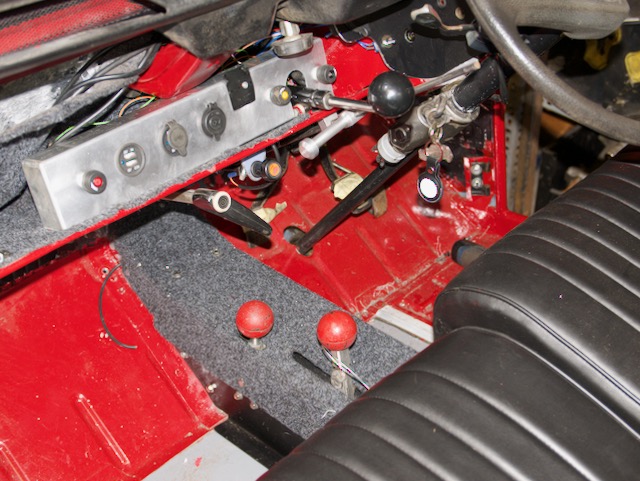

Inside Dash and propshaft tunnel etc
Prop tunnel is fabricated from Alu, saved about 8kg from the orginal heavy steel version, coved with thin carpet to reduce sound/resonce.
Extra panel for USB, Diesel Heater Control, Map Light, Reverse lamp, Alu Lever is the rear brake line lock valve.
Speedo from a Quad with small speed sensor (no need for a 2.5 meter speedo cable from the rear diff)
Citroen switches/ and relays and lamps with LEDs fitted.

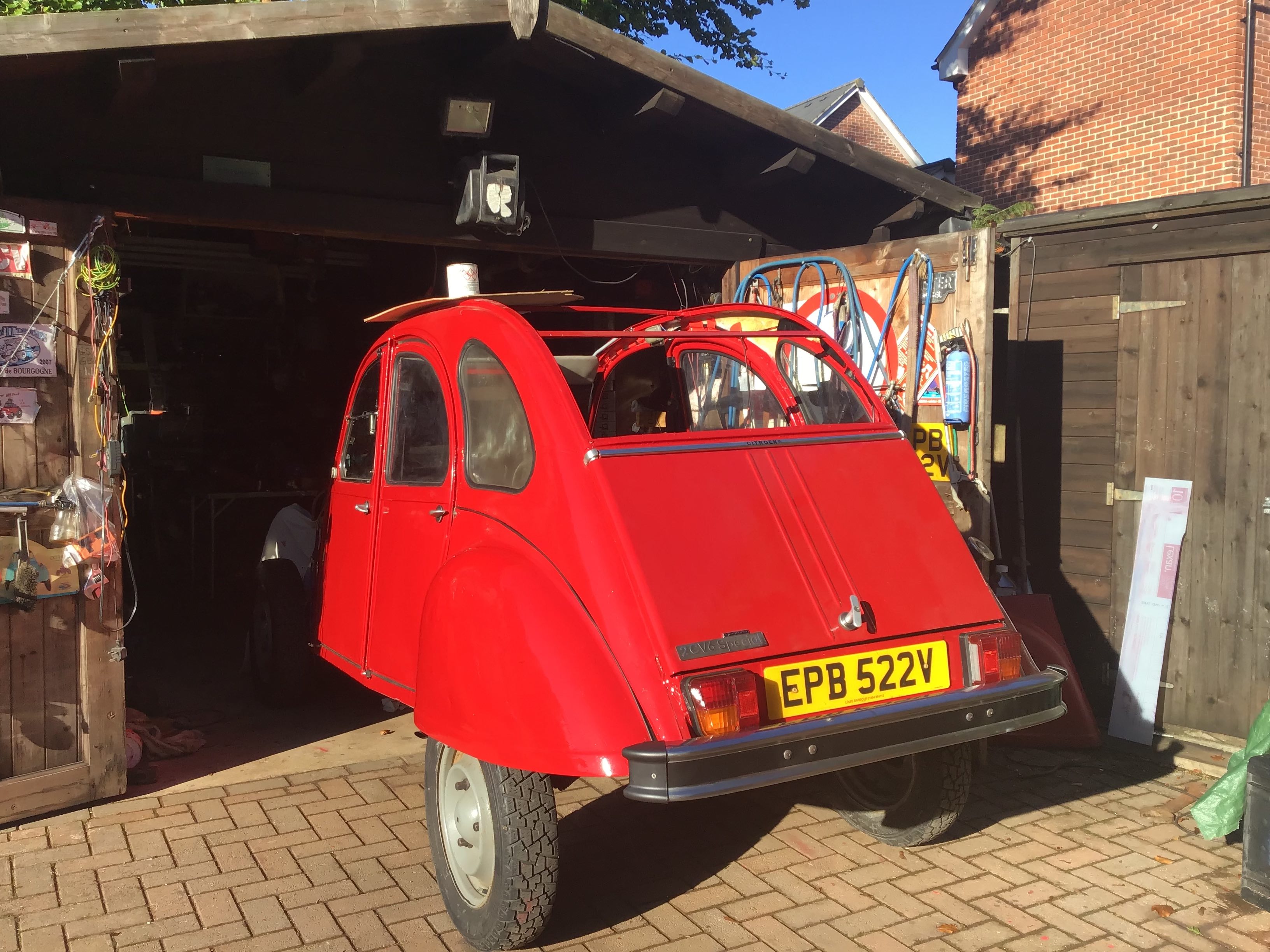

Still got a long list but jobs are smaller..

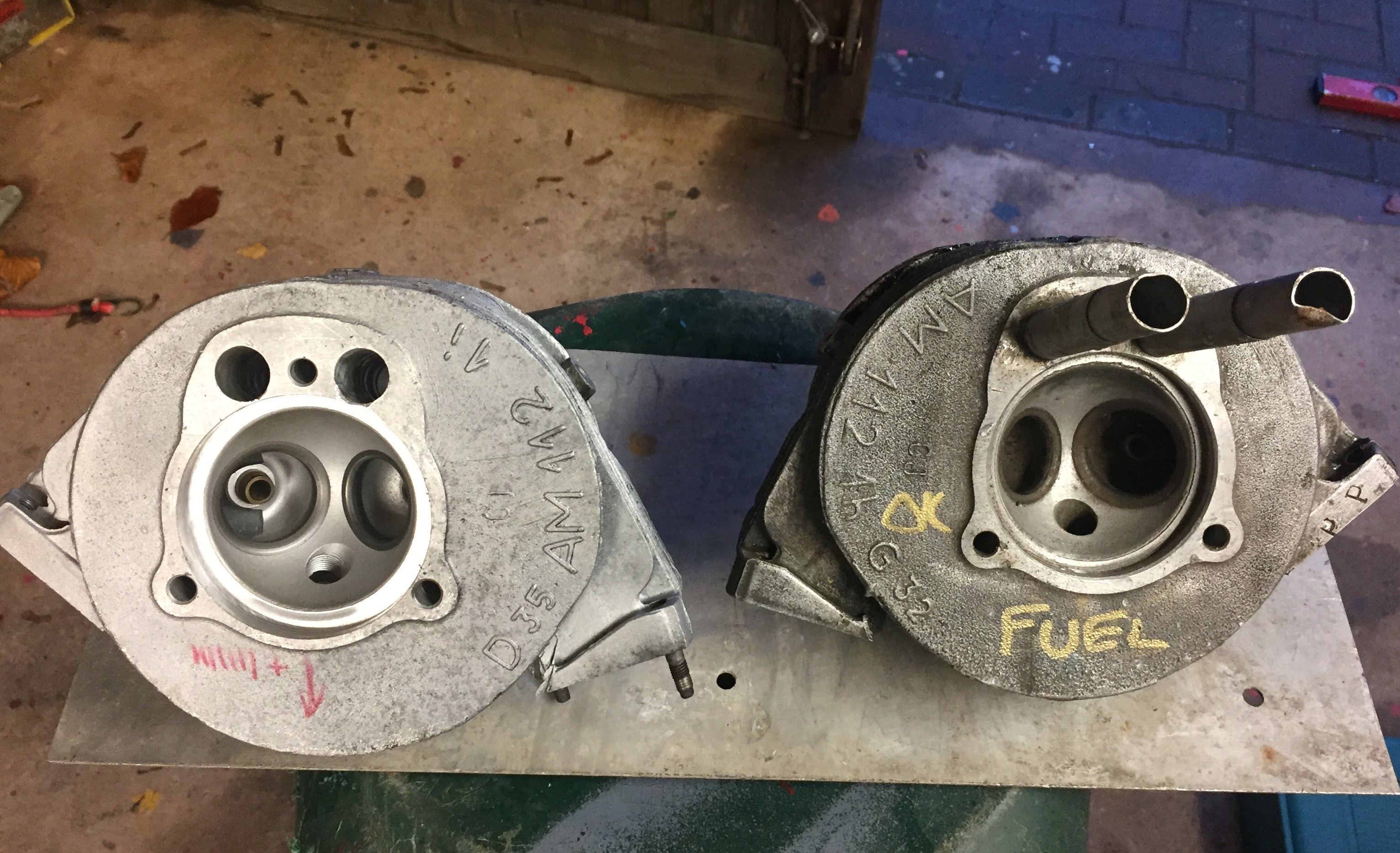

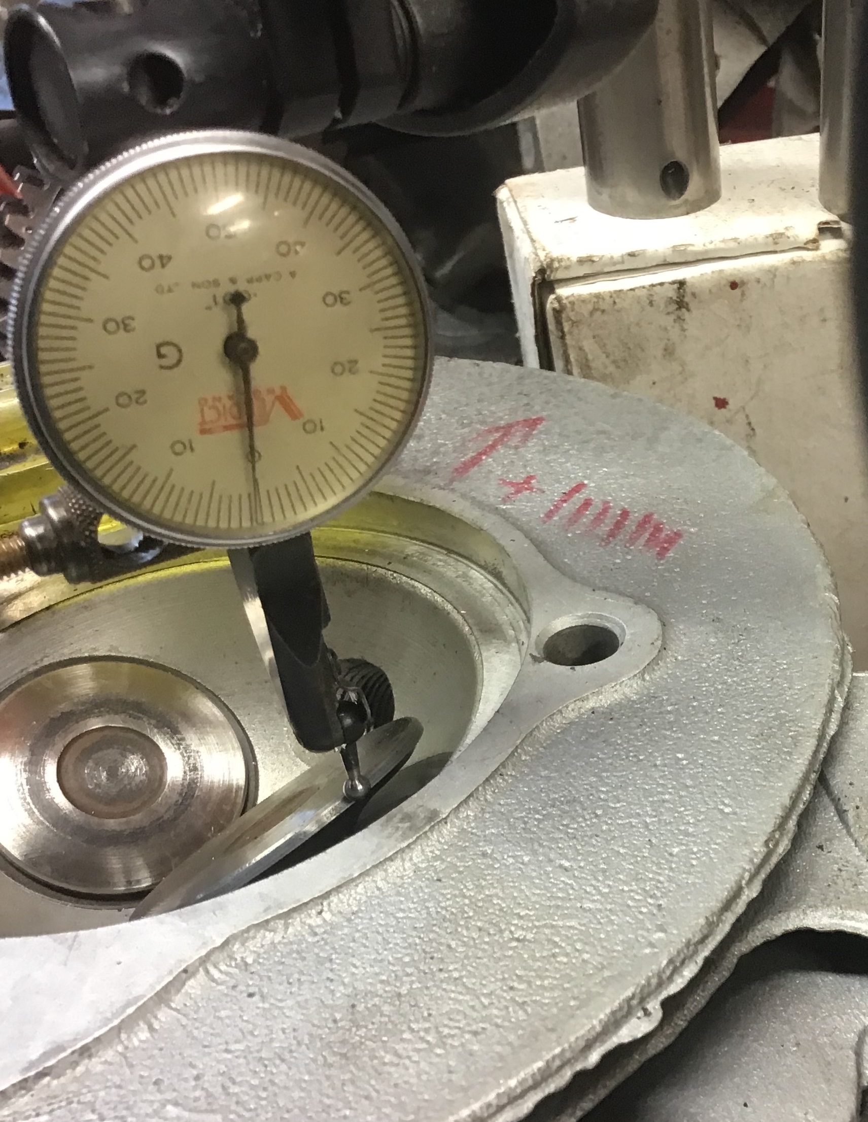

Cylinder Heads.
Exhaust Vales ok.
Inlets to much wear, so new items.

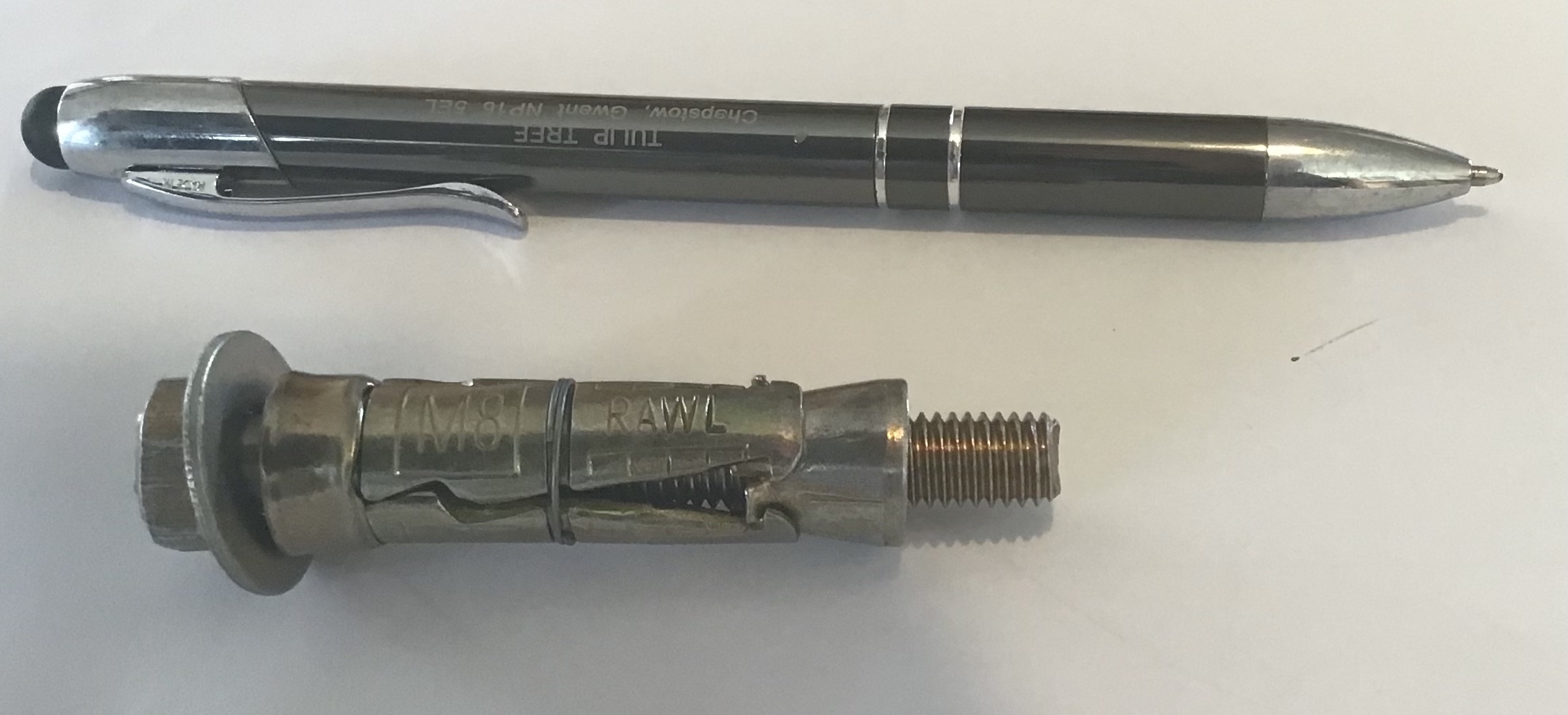

Using my £10 dial guage (Car Boot)
Tubes fitted with rawl plug M8 (have made a more robust tool.)
Also M8 exhaust studs the old M7 studs very rusty.
Head on left after Vapour Blast :)
My bargin crank from ebay in 2014 is a very large door stop :(

Post Re: EPB Refurb
Parts need to be cleaned before they are machined also allows any cracks or defects to be seen.
