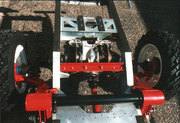

Well I don't think I know much about chassis I guess... ;) ;) ;)
I think I was the first who build a galvanised 2cv (4x4) chassis...
and yes it was/is road legal too....
Had a whole discusion with Louis about distortion, weight gain and sagging back then.
Soon afterwards Louis started to galvanise his chassis too......
The only thing I try to say that a 2cv has a ladder chassis,
so the tube doesn't give much torque strenght overall, meaning there are lighter ways to give a 2cv chassis torque strenght then this tube.......
Well we here it from the master.... I hope...

Actually the tube down the centre of the chassis really does make it stiffer
I use round tubing as
100 mm of tube gives about 310 mm of un rolled plate
this is about 25 % less than a box section
100 mm tubing with 2.00 mm wall thickness is Easy to find and fair price
Does not distort during welding
and and and
And more importantly
Mounting possibility for
Seat belts
Seats
Propshaft bearing
(also i hope to seal in the drive train with rubber bellows to the gear box and diff
so mud free enviroment!
Think back to Haflinger they use a tube for the main chassis!
pony
