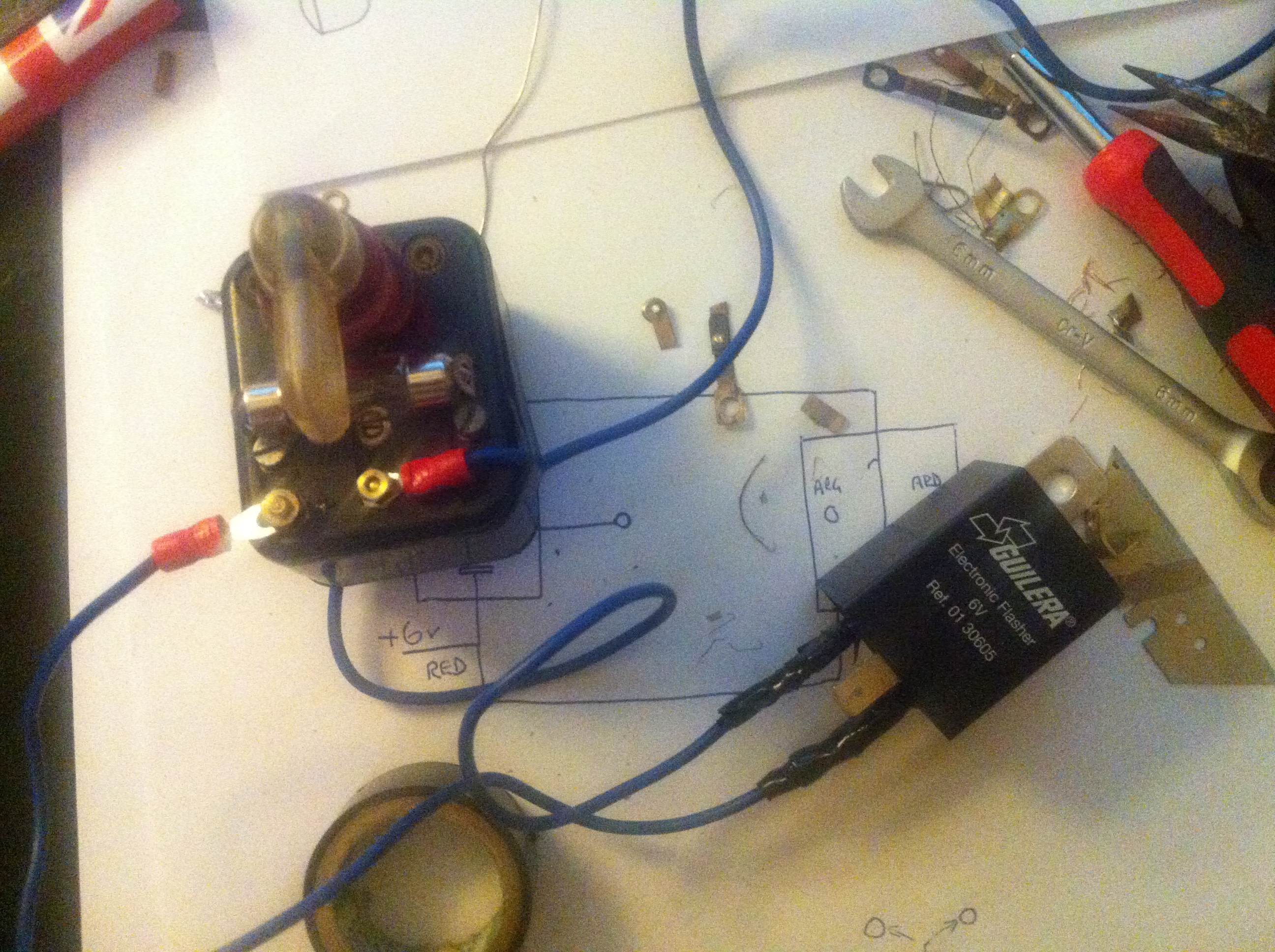

Although the indicators passed the Contrôle Technique I was not happy that it was consistent in its flash as the small thermal strips seem to have a life of their own and would take a few seconds to heat up to actually do anything.
So I bought a cheap 6 volt flasher unit and stripped out the contents of the thermal switch and modified the connections inside to incorporate the new flasher unit but keeping the original switch so it looks and operates as it should (including the dash light flash).
Quite pleased so far - now to fit it to the car and test. :shock:
March 14th, 2013, 7:55 pm
Post Re: 1957 AZU - René II
It all worked EXCEPT for the dash light. I think the bulb is drawing too much and that flashes but not the indicators. So when I take the dash bulb out and short the connectors the side indicators work fine. Insert the dash bulb and that flashes bright but not the side indicator :cry:
So thinking I might need to put in a 6 volt LED - but all the ones I have searched for are multiple LEDS. Anyone know of a good site to get a single 6 Volt LED from.
Otherwise, it is better than it was.

http://www.ebay.fr/itm/Blue-LED-BULB-ME ... 3867wt_754
This is a screw type base on Ebay France if thats any help

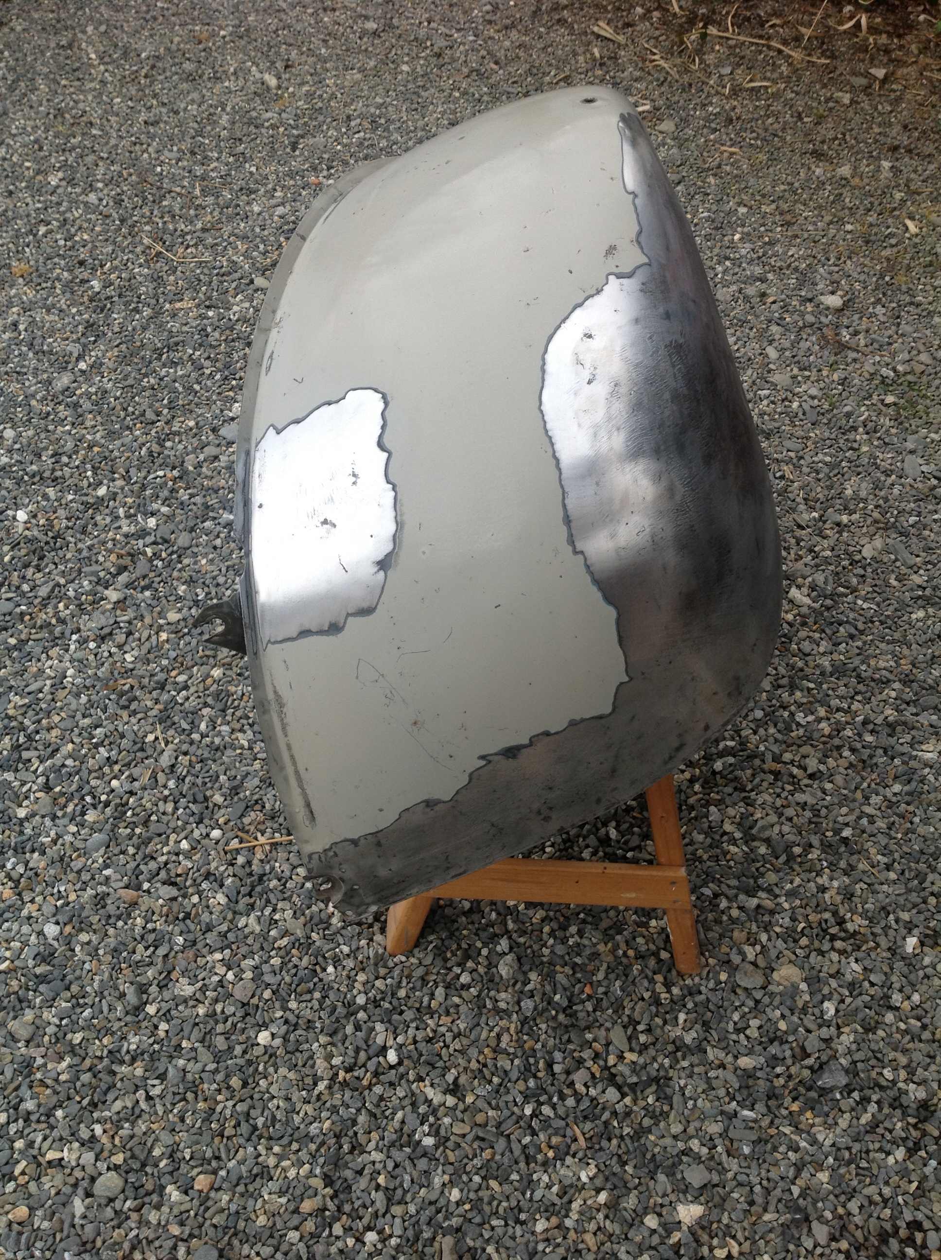

I am having a go at a bit of painting and using this temporary job as some practise as it will all be done again at the end of the year when our business season is over. I just wanted to get rid of the unsightly grey primer and tidy him up a bit.
It is both wings and the front grill that are the worse effected. Plenty of scoring and dints which will need to be done later... not this time, I just want a bit of shine for now.
Front grill sanded down and a wing. (also my left index finger.... need gloves :? )
