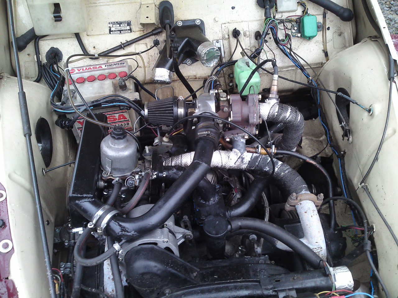

Post Re: 1976 Dyane 6.52
Wideband Lambda installed - boring day sh-t weather.
That does seem very close to the turbo! (But I do trust lpgo's experience)
This PDF talks about having it 1m from the closest exhaust port or turbo outlet! Heat soak on boost is also an issue.
I put my wb in the crossbox but obviously it is a much different setup!
Nice work how quickly this build has come together btw 8-)

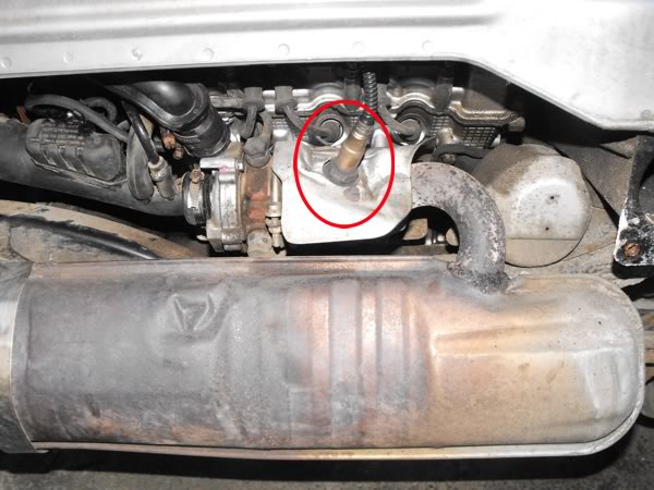

Harley here a pic from the original Smart cofiguration, (accualy the lambda probe fits into the turbo housing!!) The turbo diffuses the exaust fumes from both cilinders so this is the perfect place in a turbo engine using 1 lambda probe.
Looks like yours Chris doesn't it......

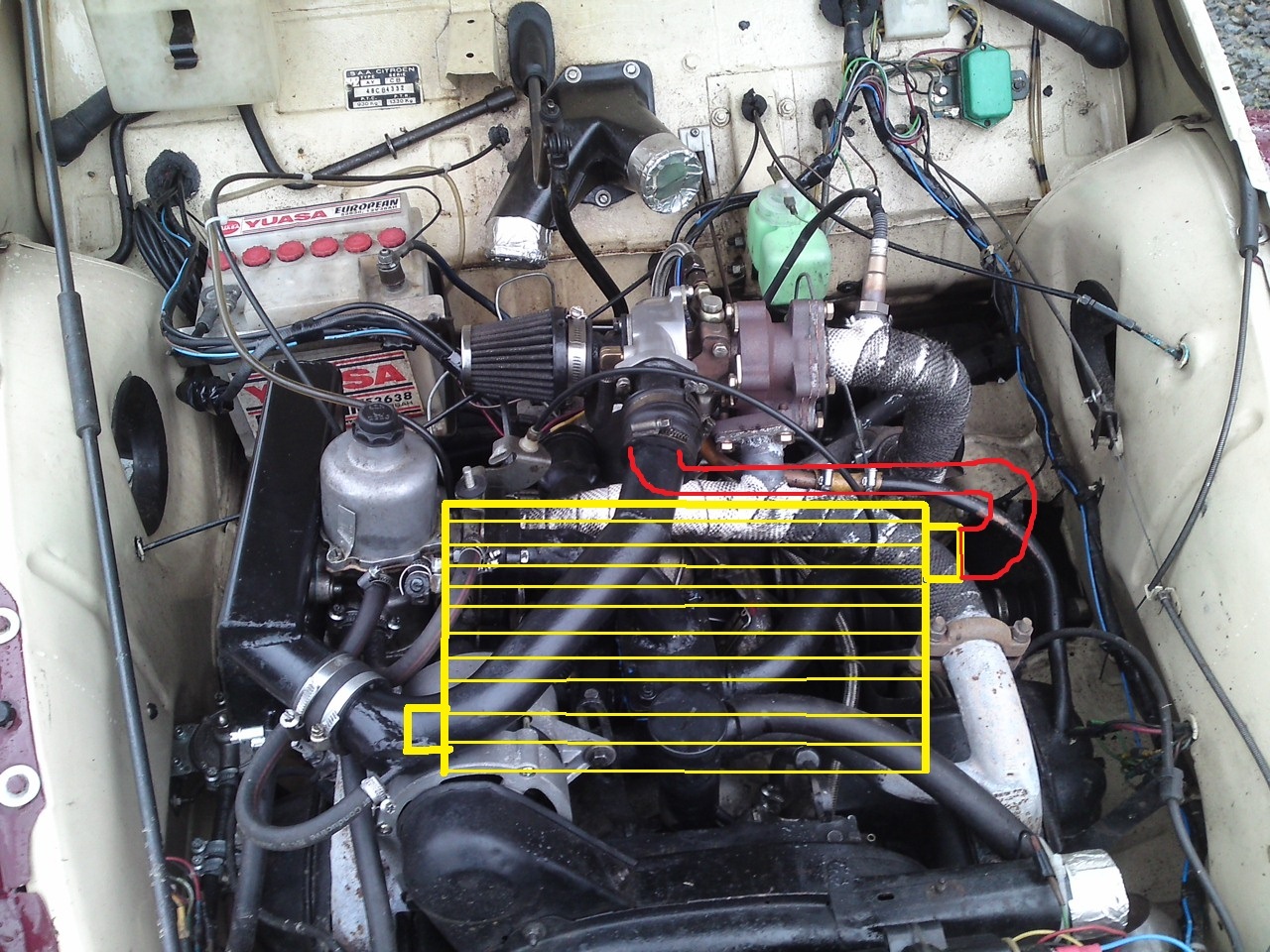

Just a thought........
INTERCOOLER
Gives you about 0.3 bar more of boost before knocking!!! (I guess)
October 20th, 2012, 7:20 pm
One day - I spoke to an old mate where I used to work and he said that he could modify an existing intercooler for me. So far no show but will chase him up after SPA.
