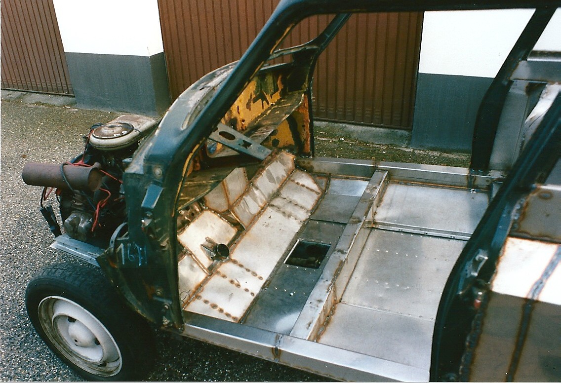

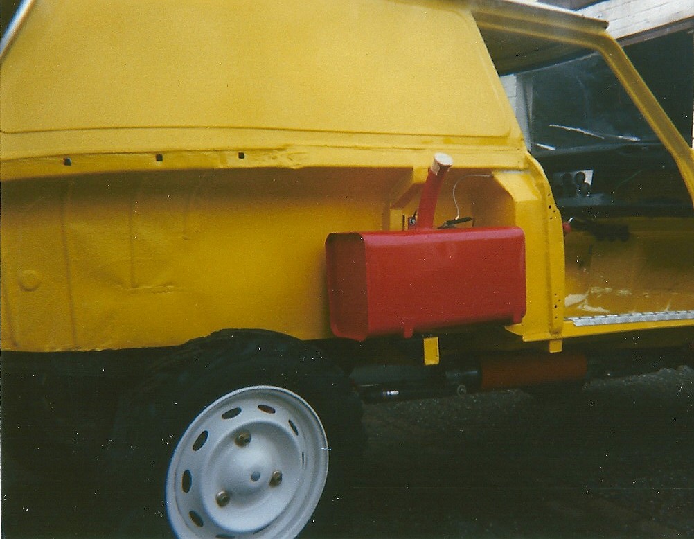

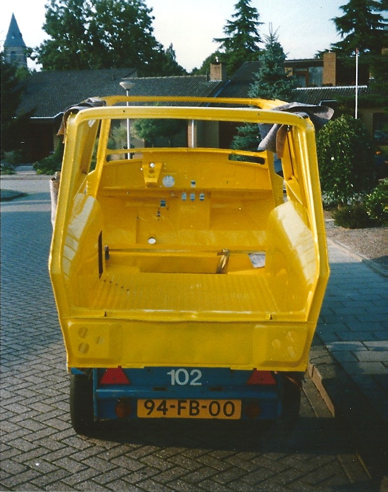

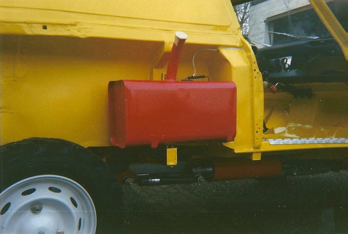

Post Re: Early Ami
Here some pics from my yellow Ami (look at the left) body 100mm higherd?? just for inspiration
rearfloor section is from a Acadyane... It is sandblasted then flame Zincsprayd and powdercoated...... welded metal is stainless..... Made the sills (and the rest myself)

That looks like a fun project :D Floors in Stainless, Its almost a Delorian :lol:
