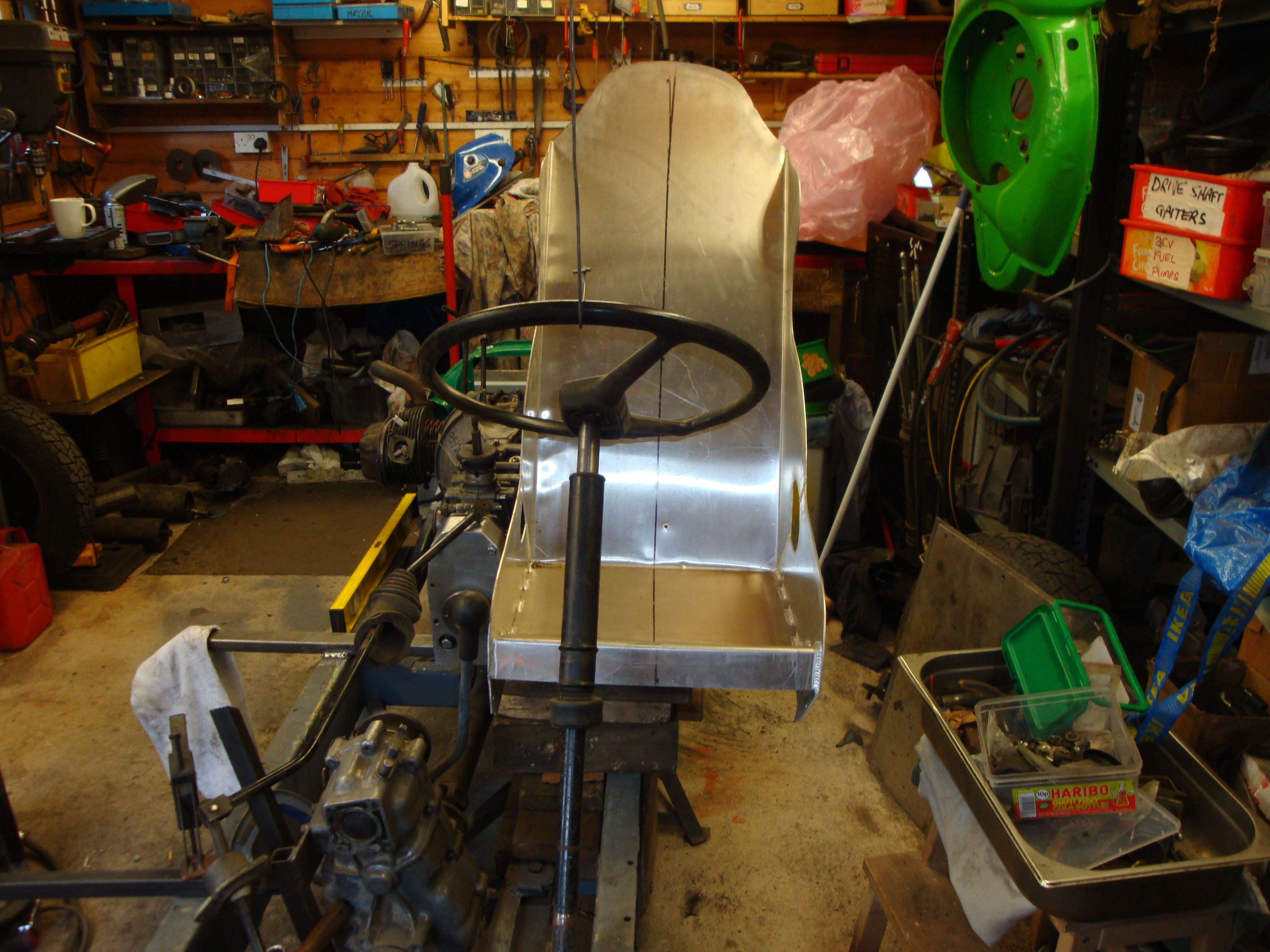

Seating in a 2CV is quite cosy, this will be more so...
March 9th, 2012, 6:26 pm
I prefer a straight line, because 1 or more bearings + fixationpoint(s) less,
+ less friction especially noticable at the high speed props
but keep in mind when a engine or gearbox rocks (moving under torc) the prop can move sideways easely more then 2cm. !!
try to keep the angle between the 2 propends as small as possible, because stress rises quickly when the angles are getting bigger....
I think you know what I mean, when not I make a drawing.....

2 props is probably the optimum solution, certainly gives space for any movement
