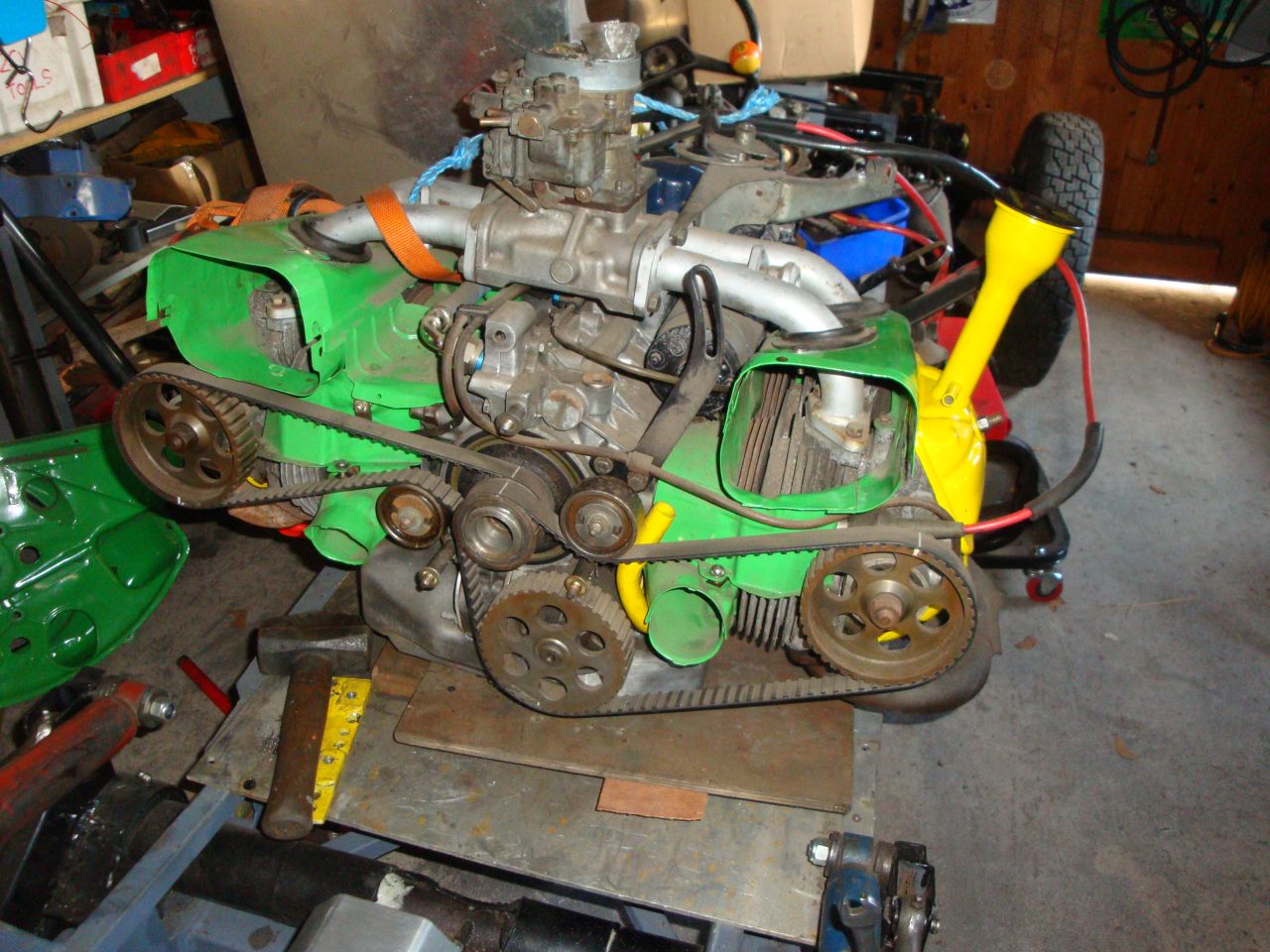

Forgot how complex a GS engine is compared to a 2CV
