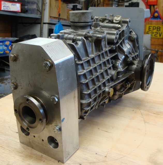

Very Cold in the workshop this week , but a few stints have got the Front and Rear diff's assembled.
With the Rear diff fitted to the chassis.

Front End.
Today Fitted front diff.

Posts: 2257
Placed engine and main gearbox on chassis.
Engine has been in the back of the garage for the past 6 years.
Needs another Carb and timing/distributer setting up!!!
