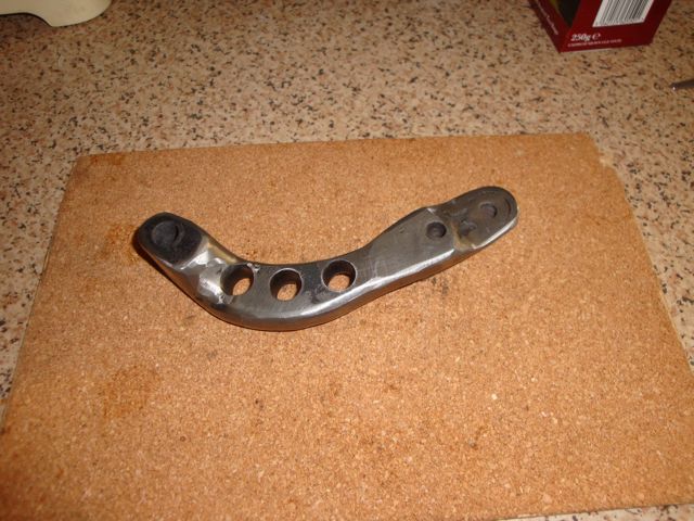

Your advice is sought, have attempted to fabricate some steering arms.
See pics.
Problem – have drilled thru the arm at the pivot point to < 12mm.
The 12mm bolt is a “tight fit” in the arm.
Can torque the nut/bolt tight, to put a crush load on the rod-end and spacers.
Will the bolt move and eventually “wear out” the steering arm????
Spend so far on one arm is £16.00, so shall I bin it?
December 23rd, 2011, 1:38 pm
Pete,
it's surprising how difficult it can be to separate parts which have been bonded with high strength threadlocking/bearing fit compounds.
If the shank of the bolt isn't fully threaded, might be worth a shot with one of them, as they're capable of filling bondline gaps of up to 0.25mm, although the cure rate is slower then...

December 23rd, 2011, 3:43 pm
Posts: 2251
Ken,
Thanks for that.
Can put the bolt in from the bottom with the permanent bonding stuff.
