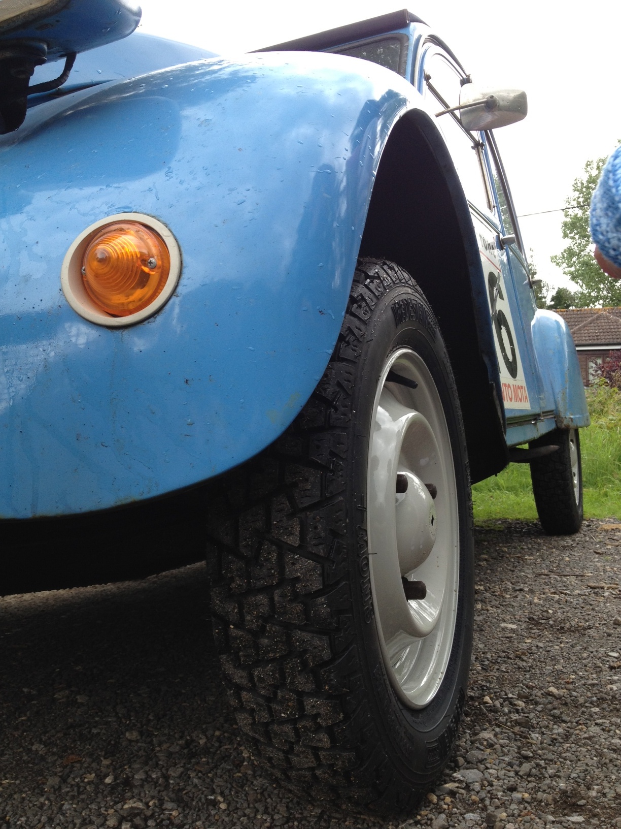

Blimey has it really been that long! Well, went to Salbris with the daughter and a few UK meetings in the meantime, but mainly just hooning around when time permits.
Got some of those vredestein's I was hankering after and some new rims. :)

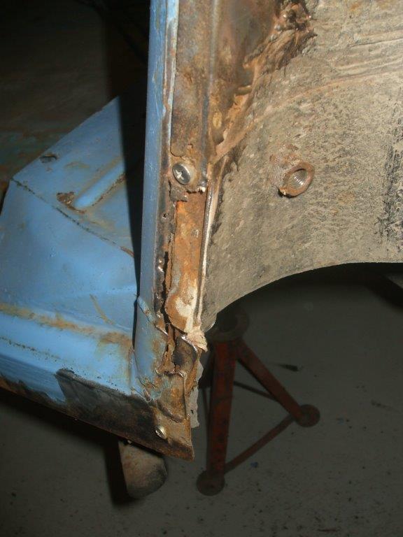

As Jules rightly says its now with Mr Sparrow for what started as a rust tidy-up round the sills and back panel which I've been meaning to have done for years.
But it's becoming a major back end rebuild. Most of the bit between rear inners and body it turns out was a fibreglass / filler alloy, which must have happened before I got the car in 1991. Turns out my cousin remembers his mum being distraught about the car needing lots of work back for rust back in the 80's sometime so some of it may date from then. It's like auto archeology going back through the layers.

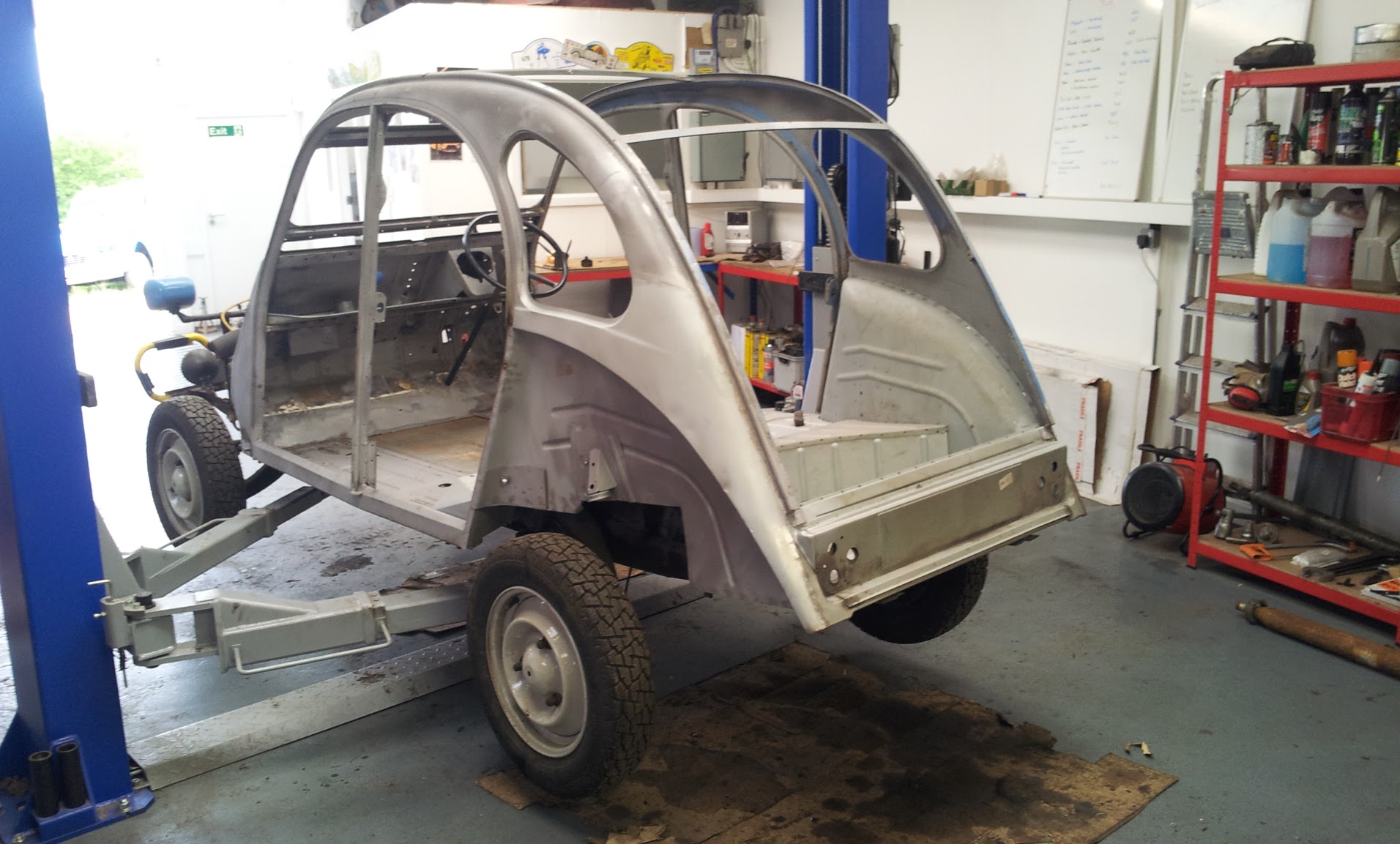

The resto work has taken much much longer than planned since the above post. First, little by little the small areas of rust were cut out of the rear end.
So there wasn't much left of the rear end by that stage...
Then a bit more,
then, er, a bit more,
and finally rebuilt with new panels for practically the whole of the rear.
New windscreen panel was added, and new parcel shelf...
Blasting followed, leaving a completed shell ready for priming and painting.
Priming the shell.
Painting (in celly, to get that more authentic '70s finish)
And finally coming back together ready for the road again. It should be ready quite soon, I'm so excited, it has been so long.
