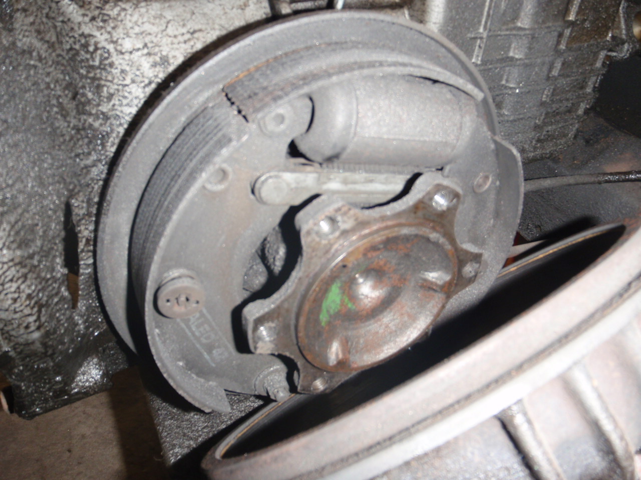

Gear box (low speed 2cv 4 box) out. No wonder the Odin was pulling heavy to one side when hitting the brakes. Both drums KAPUT.
Childs play removing the steering column. No hammering or silly wedges getting the column off the pinion no mater how much rust.

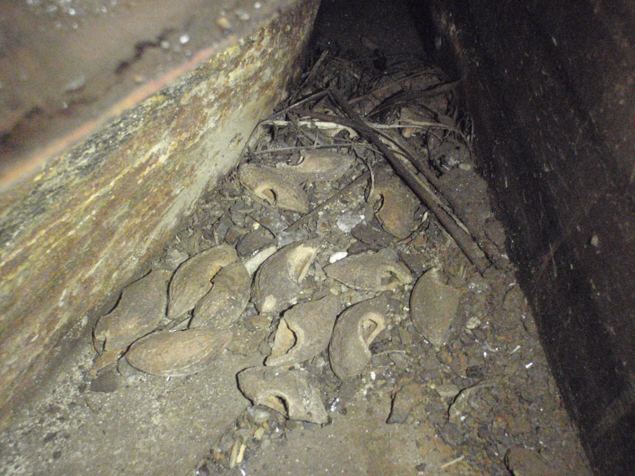

Chassis saved in time.
Funny how every chassis I open, the inside is home to the local ''little people''
