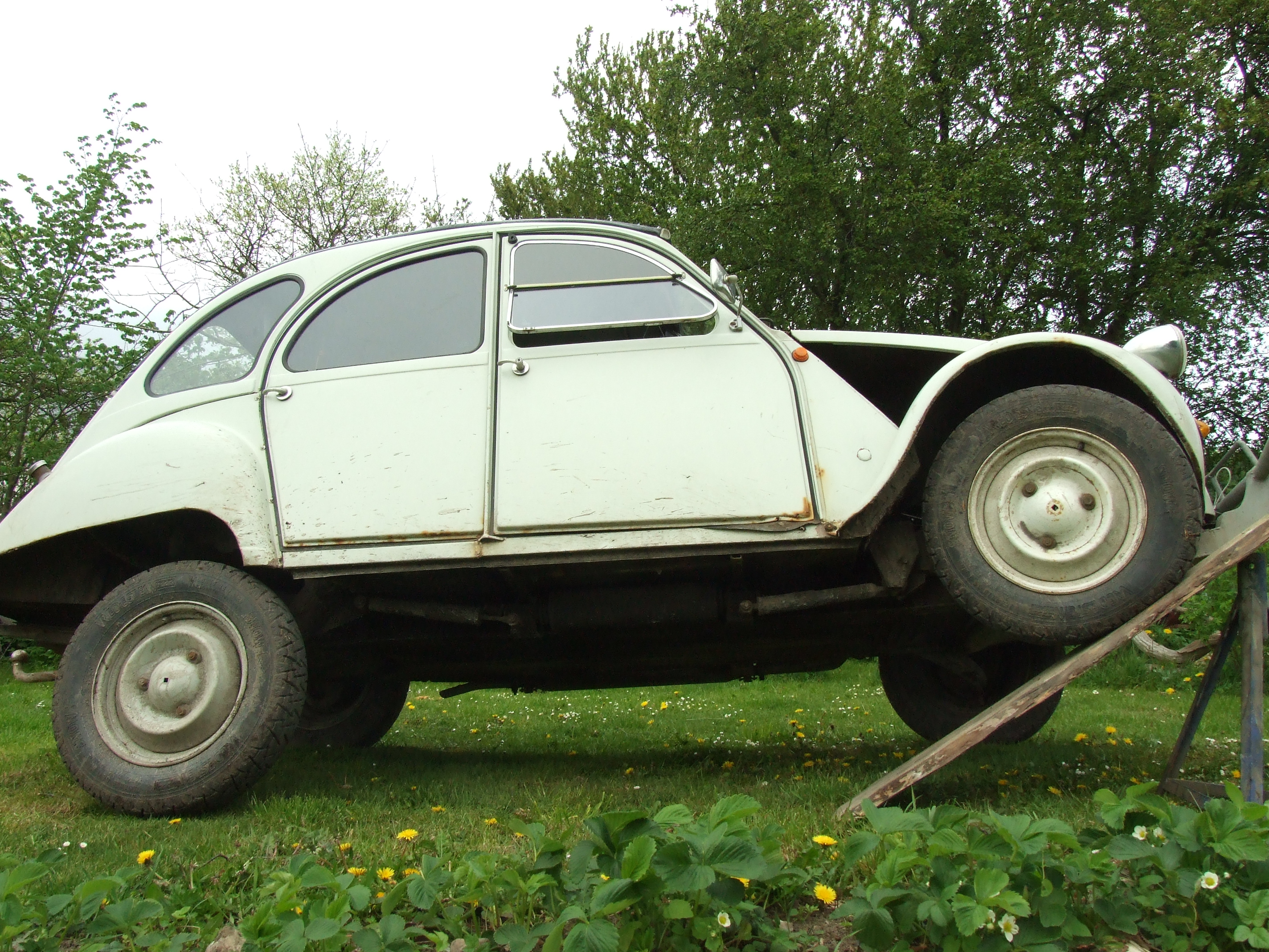

When planing this raid it is our aim, that we should find some of the most difficult roads to travel along.
Roads in the Sahara might start up as a quite OK unsurfaced track, but after a shorter or longer time you may find it difficult to find the track at all, you will find yourself crossing dried out rivers and that can be a task including quite difficult off road driving, sometimes you might have to give up and go further up hill searching for a place with less steep banks.
A 2cv has thanks to its: low weight, low ratio 1. gear and the interaction-system, that allows big independent wheel travel, and (compared to the weight) big wheels, very good off road capabilities.
Meaning that you can pass difficult places rather slowly meaning less risk for damage.
You can improve this by raising the ground-clearance to maximum allowed for a Méhari. Remember to adjust the bump-stops at the same time.
Bigger ground clearance and raised bump-stops also reduces the risk of hitting stones and bending the chassis, if you go to fast-
But you are in the desert and you shouldn't go to fast.
