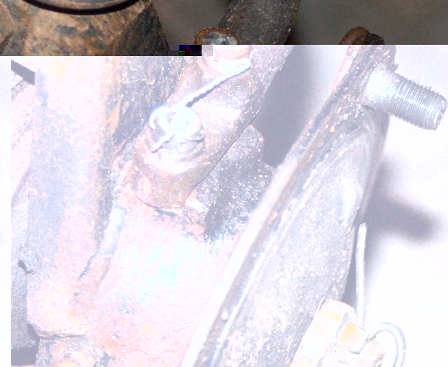

Steering Arm Solution.
Welding seems a bit final, a potential solution is fit 8mm HT bolts and wire them, then you can take em off if you need to.

Surely that doesn't help much if the threads are stripped though?

The standard bolts are 7mm, which is OK, BUT if things come loose it damages the seat and the bolts. So bit of drilling and tapping to take the 8mm bolts and it saves the hub.

aha! Can't argue with that :)
