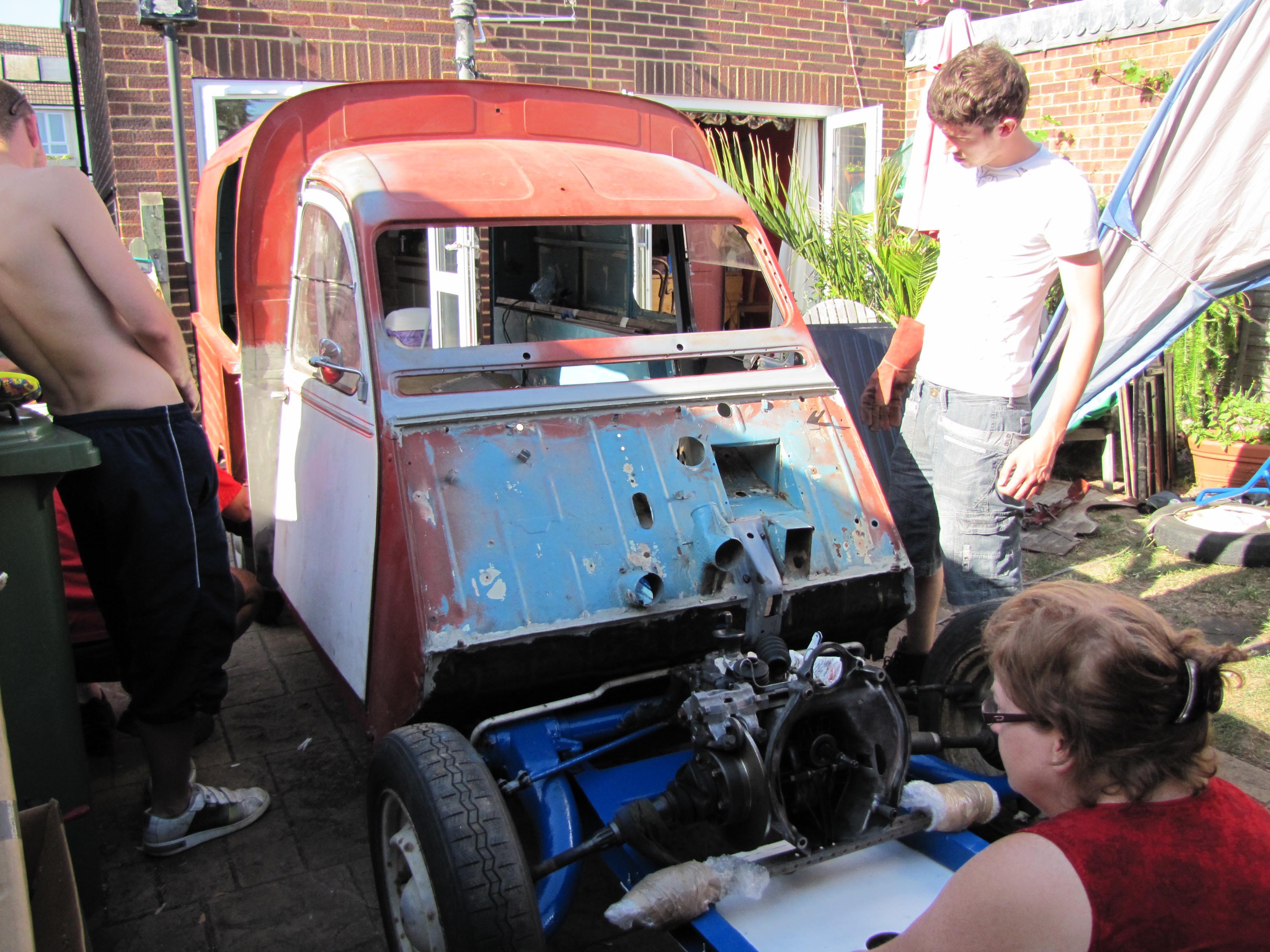

Saturday effort... Boy was it hot out there.
Body now back home and the rear valance/ Bulk head to replace plus the nearside rear wing.
Day spent cutting and chopping.
The more you dig the more you find! :roll:

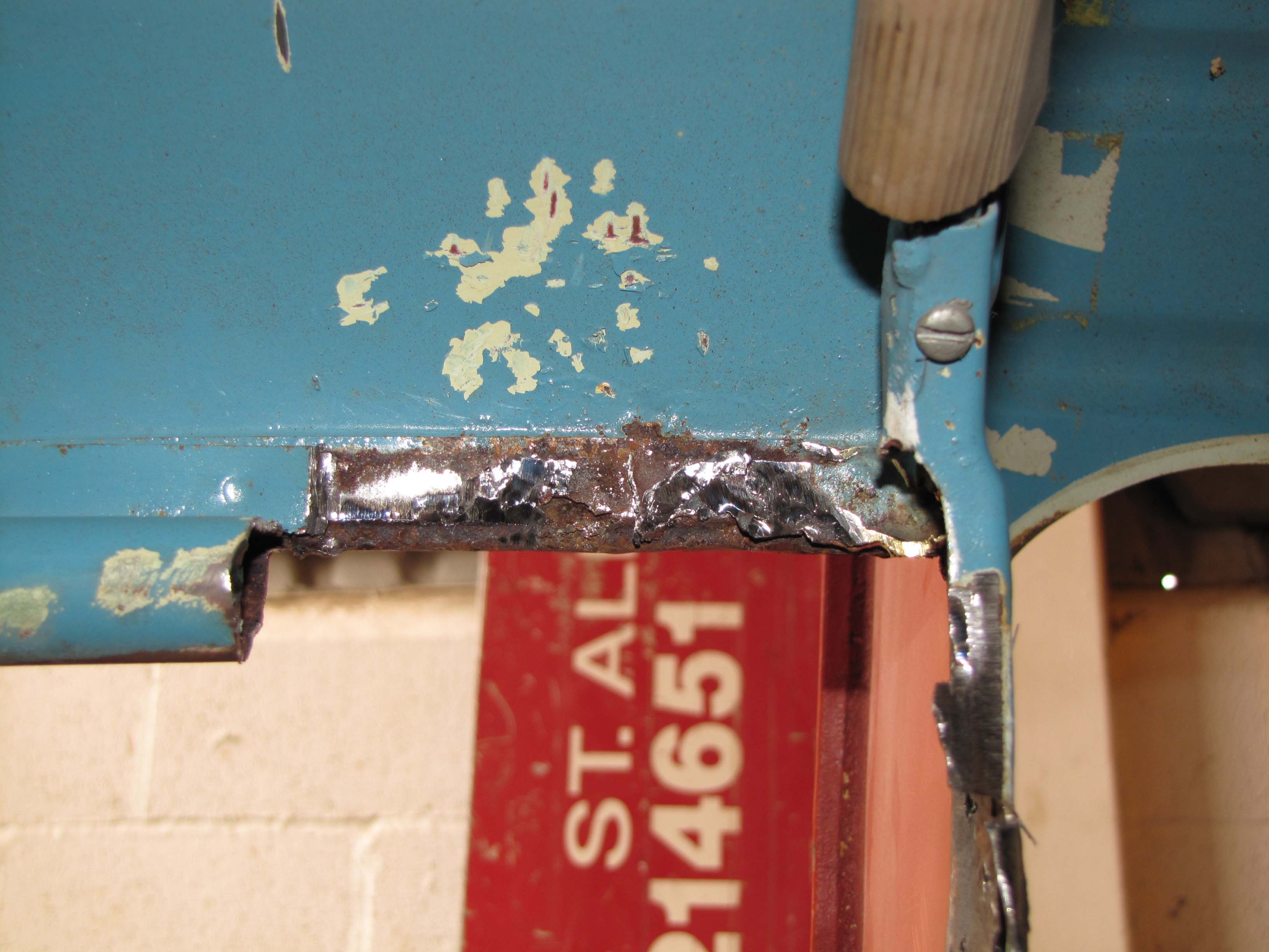

Ken
I found this amongst your pictures on Flicker
Where as Roy (ecas) as this as the way to fix this panel?
The Ecas picture allow for the front edge to be used to attach to the chassis doesnt it?
I am also interested to know how you have constructed the supports for the 'bumper' tubes. The original has a strenthener on each back and front and 2 cross supports which you dont show. Is that over kill by Citroen?
The ECAS way also allows the construction of the top section and the valance to put together off the vehicle and then after fixing allows the bottom L shape to be added it would seem to me?
Any views greatly appreciated.

Norman,
have added another pictures on Flickr...
John had bought the repair panels from SPOG and as there were no instructions provided, this was the only arrangement we could find in which they would fit.
There was no chance at all of it fitting as shown on Roy's picture.
Mind you, we had to take it apart and reassemble it with the top and bottom of the box not parallel, in order for it to sit correctly on the (Frome) chassis. These pictures are of that first (trial? ) fitting...
'Steadies' for the rear bumpers were made with tubes which were a push fit in the original items and these were welded into the front part of the box.
The box and rear valance were assembled into one unit, which was slid (read as 'hammered' ;) ) into position, then plug welded to the van floor. I welded some extra brackets to the front of the box to bolt it to the chassis.
ken.
