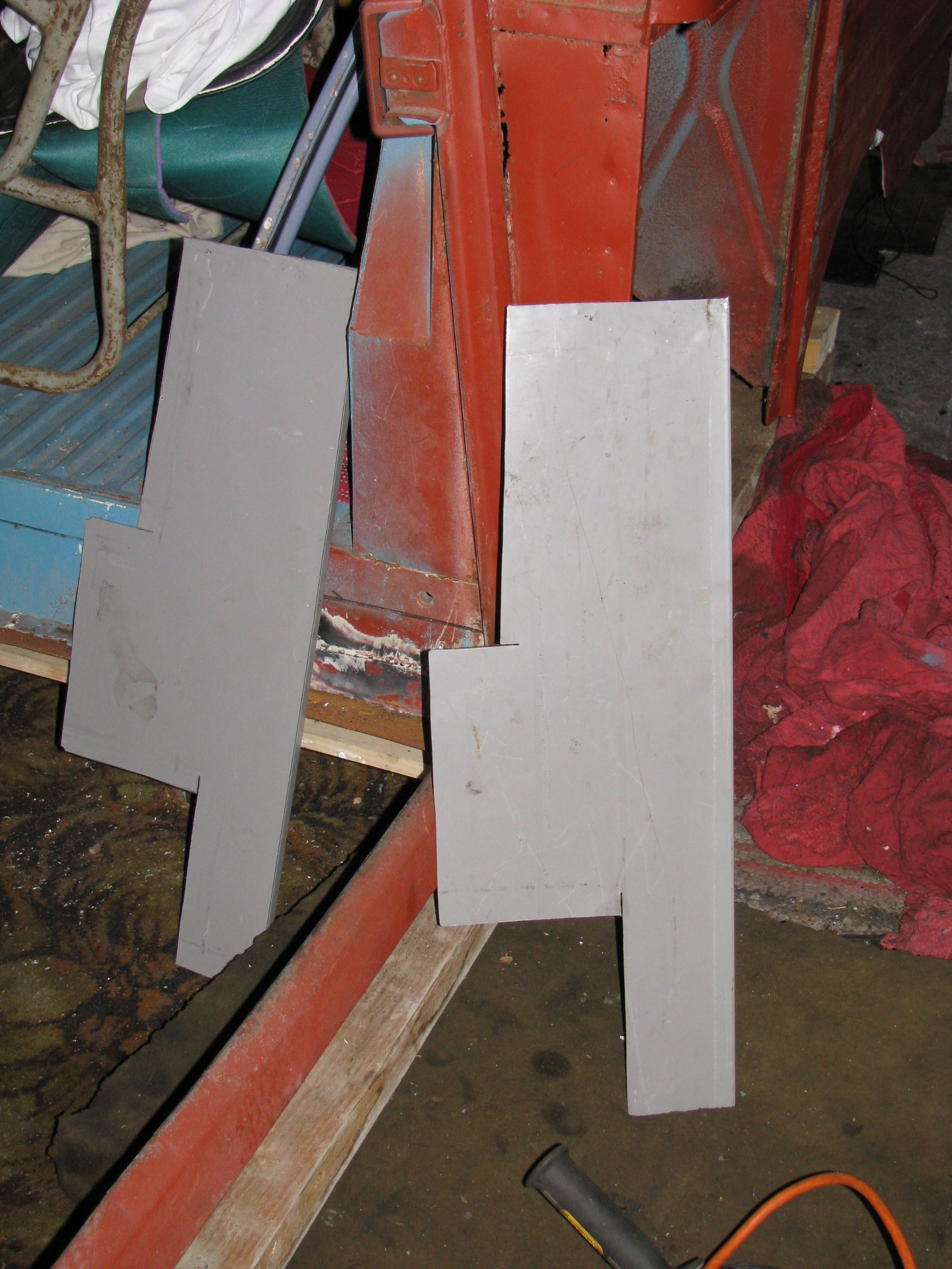

Did you know the profile on the 'b' post of van has different shape to the 'b' or 'c' on a 2CV?
Oh yes and its not available!
After some research and a helpful email from Pete Abbott it seems a C post repair post can be bent to achieve the desired affect.
File comment: so thats what was behind the pop rivets!
