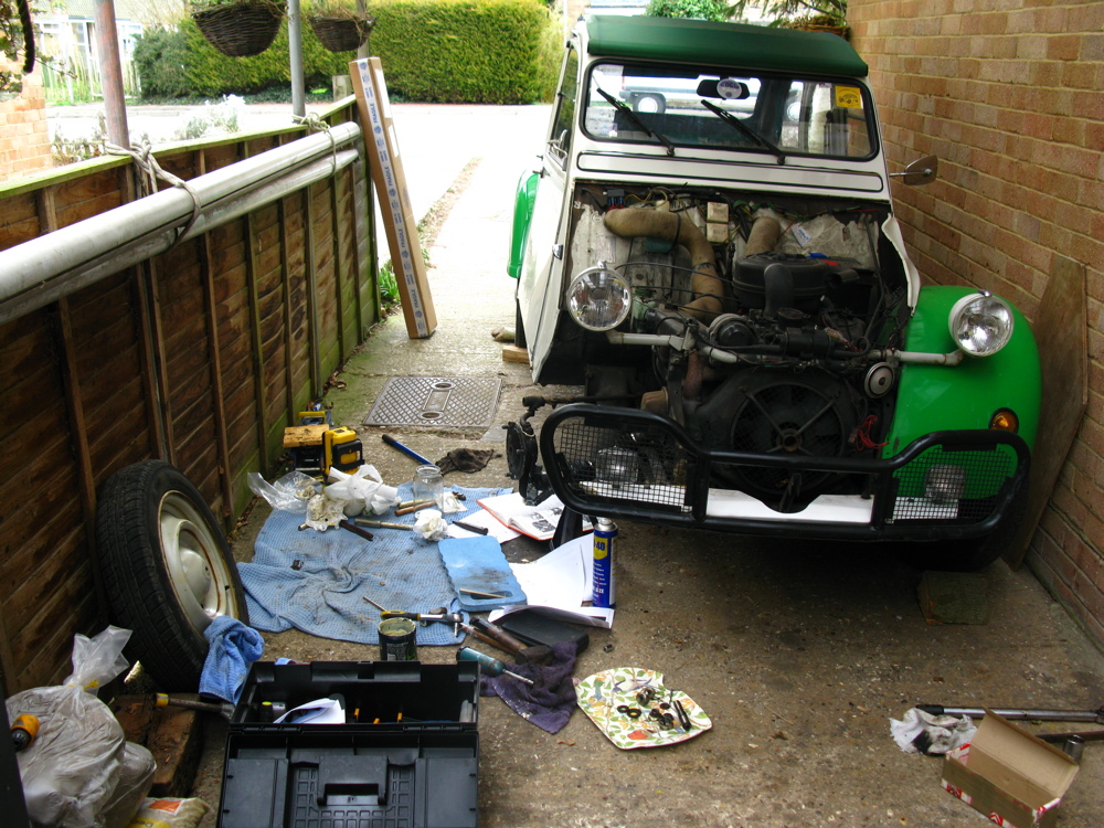

Changing the kingpin. Had to laugh at haynes 'considerable strength will be required' not kidding! I thought it was well worth removing the shaft so I could get the hub in a vice and drift in the new brushes. Also gave the shaft a good old greasing and as it was out, was able to (easily) top up the gear box oil. I'm glad I had the front wing off as there was rust eating away in the water trap between the wing and the body - that's all kure-rusted and sealed now.
In this pic you can clearly see a print out of a thread from a 2cv forum ;) cheers Viking :D
Changing the king pic went swimmingly, and for any noob types like me - have a go! its actually dead easy! The only dangerous part was the welch plug nearly taking my eye out :lol: I cannot recommend highly enough the ecas king pin removal/fitting kit its £36 well spent.
